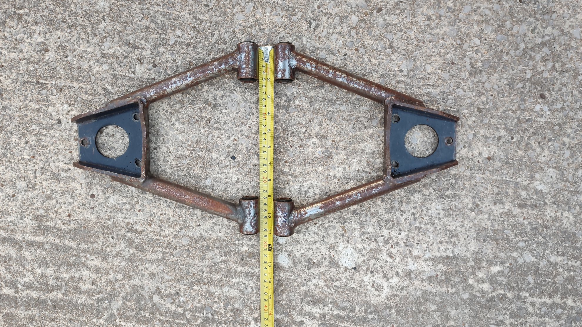

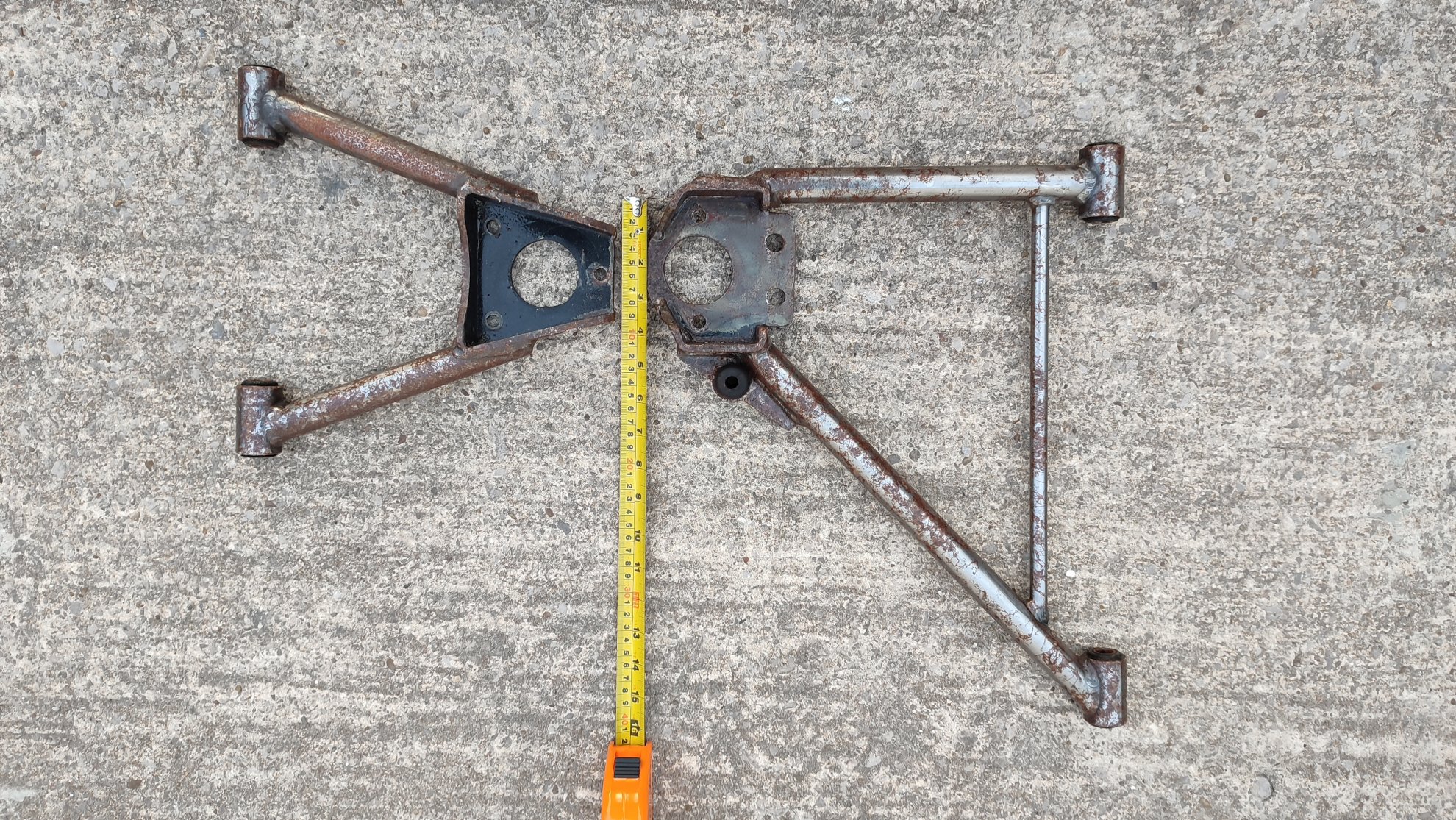

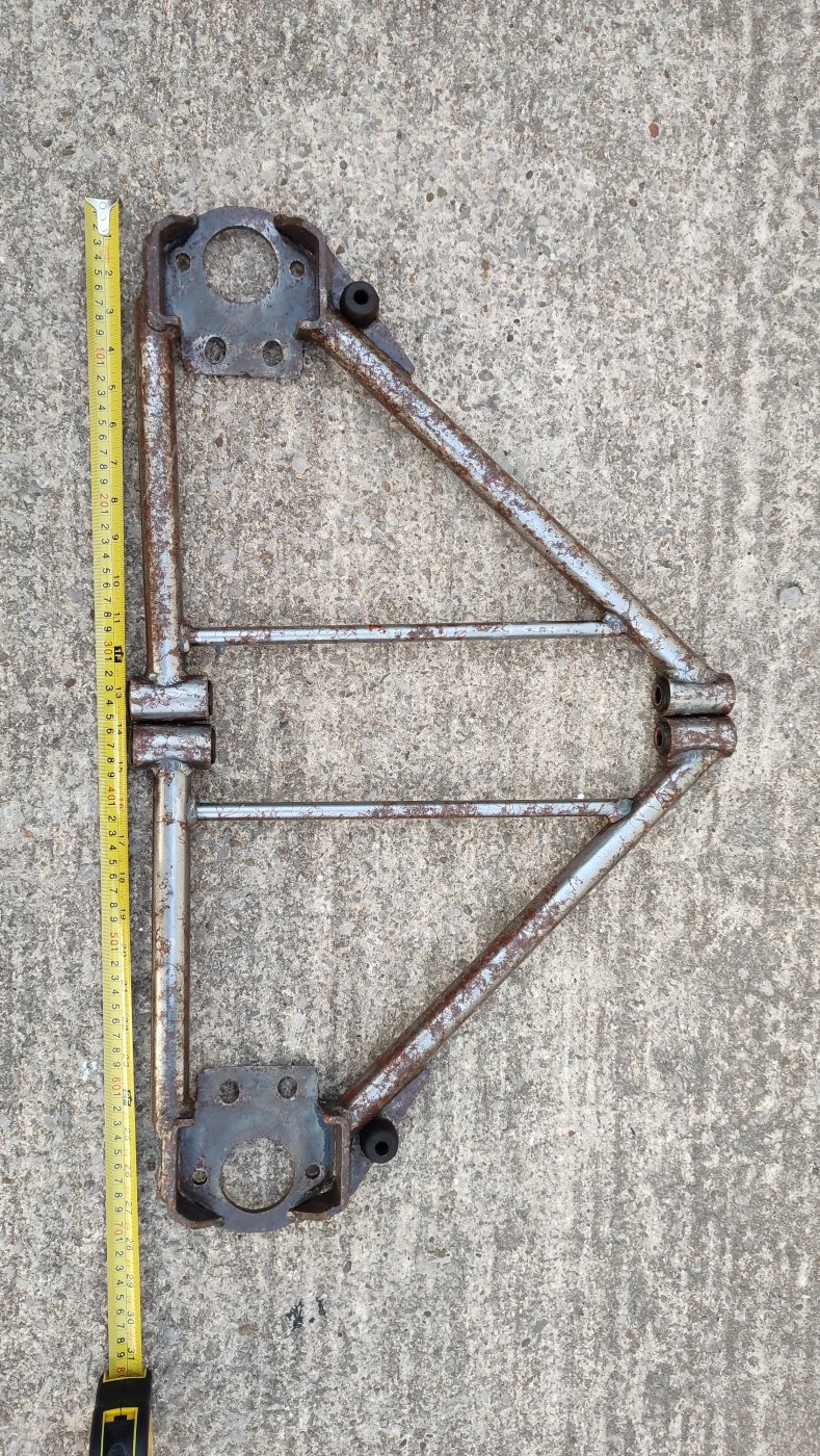

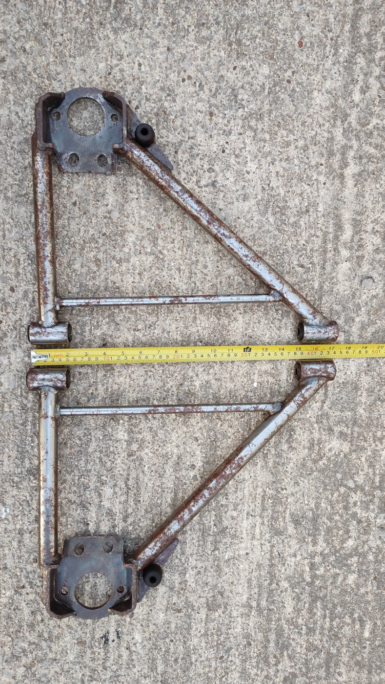

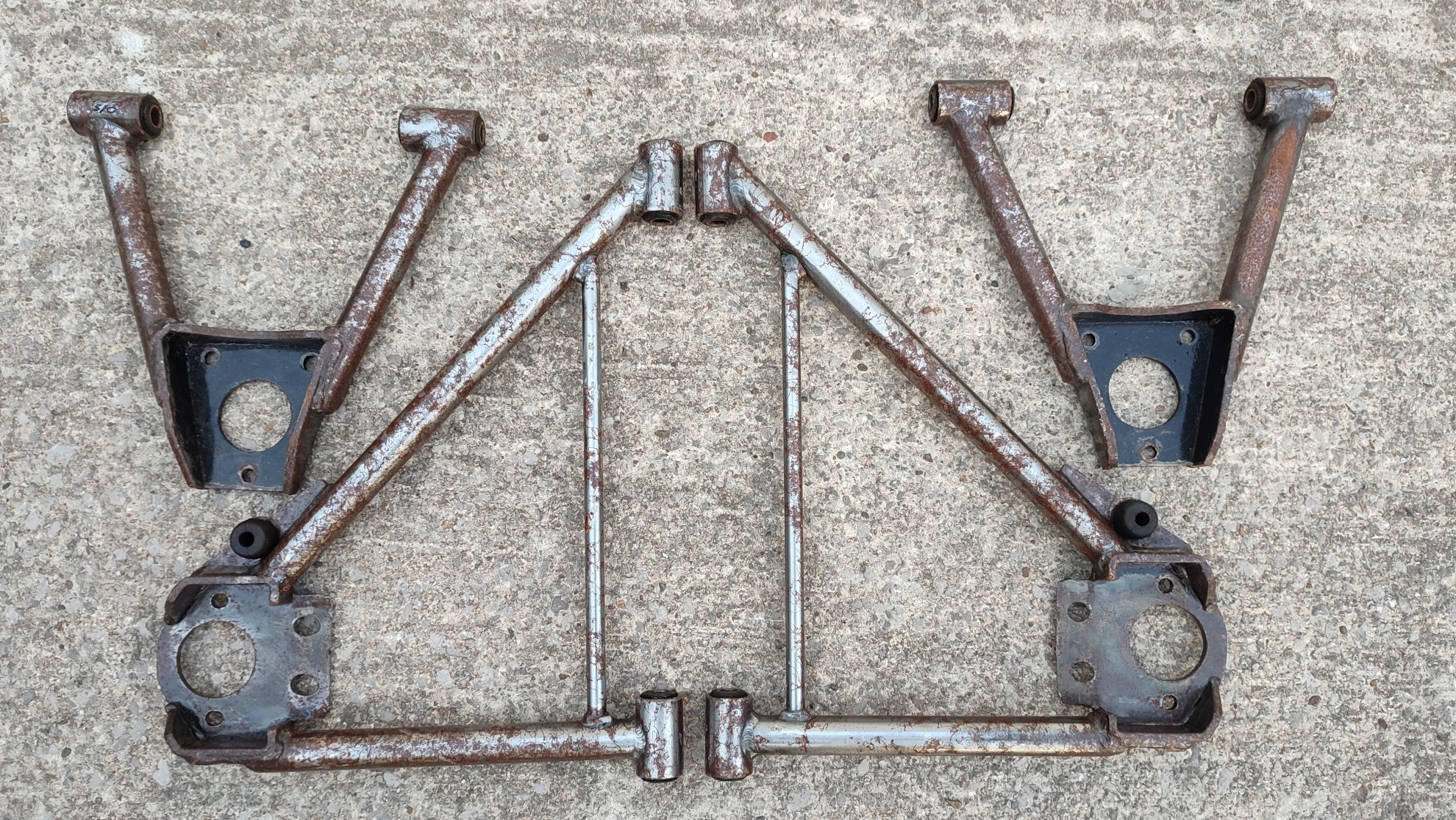

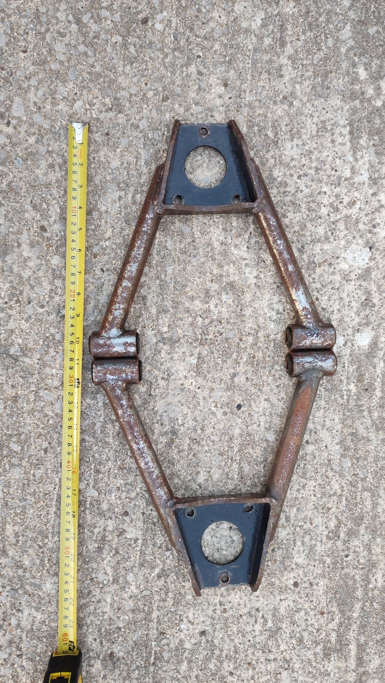

Here attached are the pics of the GTD front wishbones with tape measure. You should be able to get the dimensions from these. I will look up the Granada MK2 front suspension info.

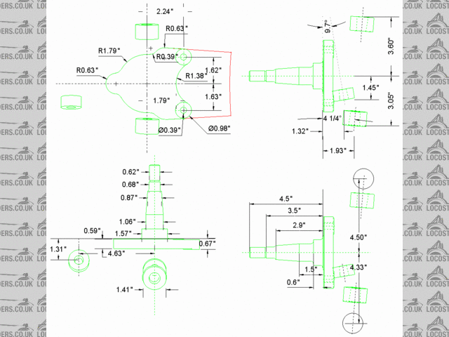

I don't know if the Cortina Mk3 upright and Granada Mk2 upright are the same but I suspect not. The Cortina used 4 bolt hubs and the Granada uses 5 bolt hubs. Anyway here is a dimensioned drawing of the Cortina upright.
