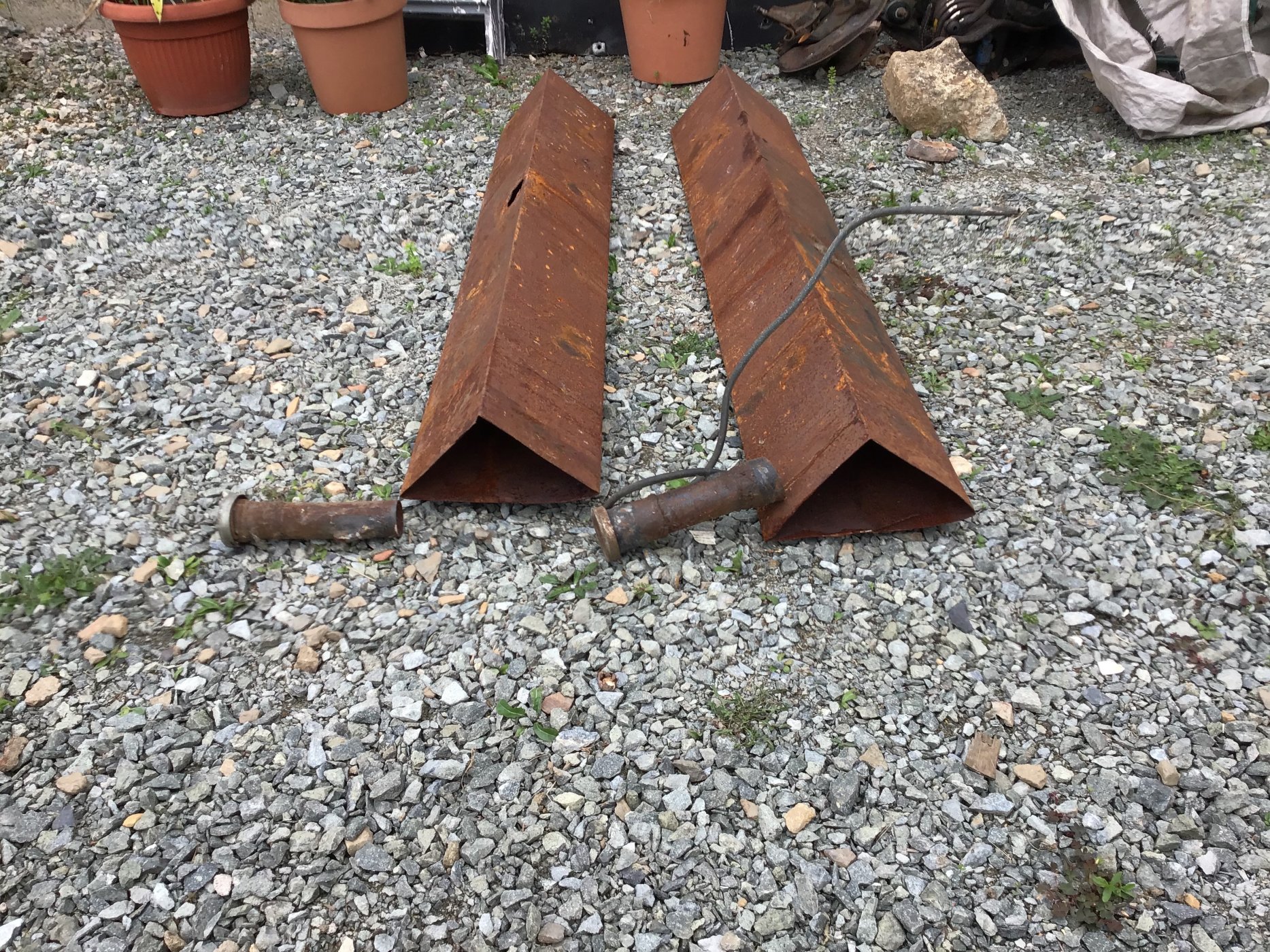

As far i know, my car, should have been built by them late 1982 or beginning 1983

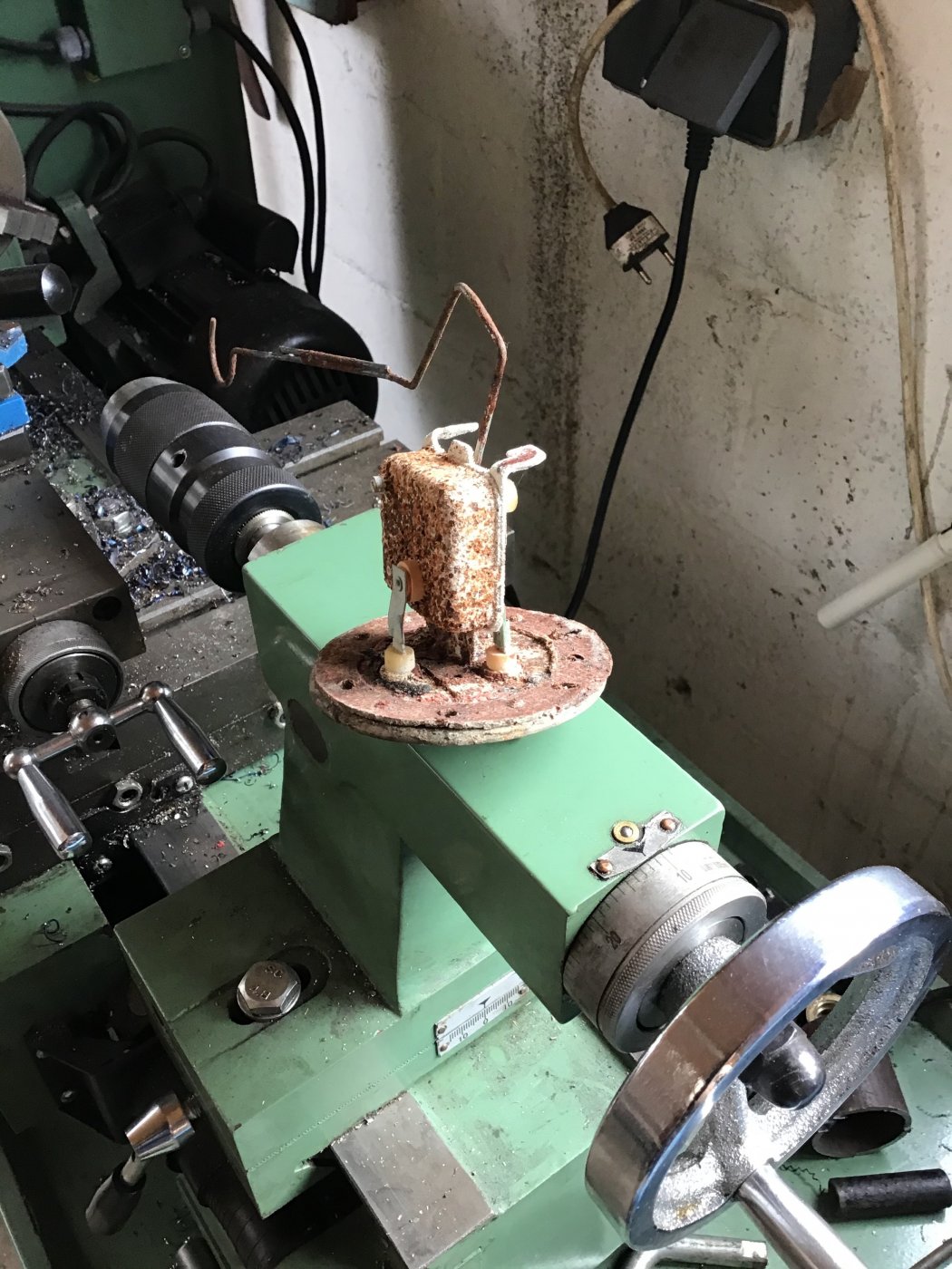

my fuel tanks where tringle shape in the side pontons...
tanks where connected at the rear and one fuel sender...
