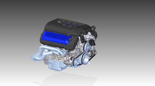

For those of you who dabble in CAD and/or are working on Coyote builds, I have made available a CAD model of the new 5.0, located here:
Ford 5.0 coyote engine - STEP / IGES, Solid Edge - 3D CAD model - GrabCAD

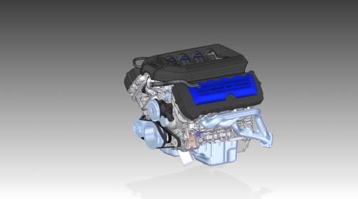

This is direct from Ford Racing, and is a dumb model with all accessories. (No engine internals). For some reason, the intake was not included in their file, and they cannot get it for me. This is something they don't normally do, despite the prevalence of factory-approved LS models floating around for different things, so we get what we get, as far as what is included. You'll notice the driver's-side header is missing an exhaust tube, and there's an idler pulley missing as well as a few other minor things. I'll probably be drawing a rough mockup of the intake just for kicks, and I'll add it to the grabcad project when it's done. If any of you have any contributions to this, shoot me a PM!
Happy building! :happy:

The full model is there. Play with your STEP import options- the cylinder heads don't like to come in as anything other than construction surfaces.
