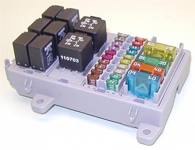

I'm looking at purchasing a fuse / relay block for my car. This very nice modular example by Vehicle Wiring Products out of the UK has been suggested. It looks the business and I'm happy to go with it, but thought I'd check the forum.
Before I order out of the UK, does anyone know of an Australian supplier of this item, or something similar? Does anyone have any alternative / better suggestions generally?

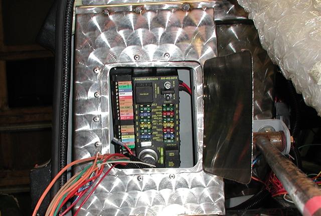

I fitted a painless unit under my dash, I got it from Castle Auto

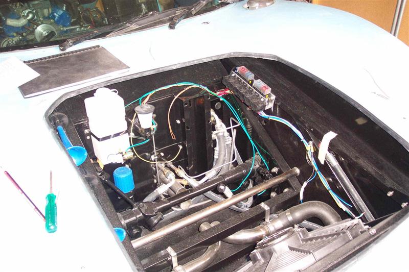

Hi Lance,
Apart from the issues mentioned by the other guys (number of ccts, relays, fuses, etc), another thing you might want to consider is the location of the panel in the DRB.
I wanted mine out of the way of water (some early DRB's had the panel on the flat sheet metal just under the rear of the front clip - guess where water off the windscreen went ?). So I decided on mounting it on the frame as shown in the following pic. Some of the later DRB's had it located similarly, but further forward, so that's where I started. But after upgrading to the "deep twin nostril" option, I found that I had to move it further back & up the frame to clear the nostril - even then, the space was limited, so I ended up making my own very narrow panel out of "c-section aly extrusion" - 2 x Narva 6-way fuse blocks in the "c", & 6 x Hella relay bases bolted to the side. It just clears the nostrils width-wise, but could handle a few extra relay bases & another 6-way fuse holder length-wise.
BTW, regarding water entering the front compartment from the windscreen, I made up a small curved barrier which runs across the flat f/glass section under the back of the front clip - this diverts water to each side & down into the wheel wells.
Hope this helps a bit.
Kind Regards,
Peter D.

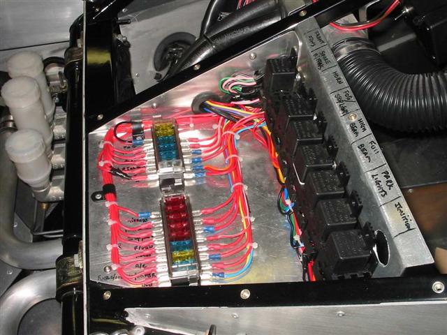

This is what I did. OK it is in an RF but would be applicable to most other cars also.
All fits under the closure panel under the front clip on a purpose made tray.
hopefully photo's are attached.

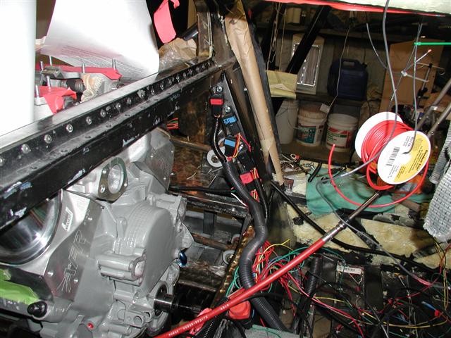

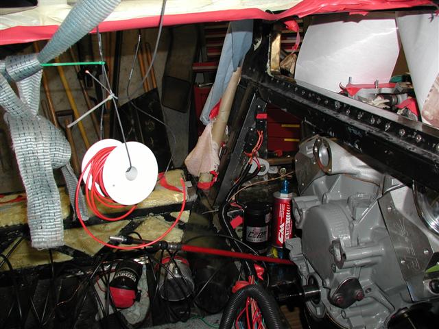

I too wanted my fuse block out of the weather, though I can't imagine driving it in the wet. So I built a house for mine in the engine bay. Since I had decidsed to do that, and most all the apliances were in the rear as well, I felt most of the relays shoud be mounted in the back also, but where to put them? Then I came up with an idea to mount them behind the hatch cover on its verticle sills. I'll save a little surprise about that for later on when it is complete.They need a little tidying up, but the connections are done. I need to order an accessory fuse panel of at least 6 circuits for the extra relays I added. To cut down on the number of circuits, I assigned two additional relays to serve all 8 of the coils on the main relays. I still haven't added the power mirrors or rear camera, and I am still arguing with myself about the mirrors. I am looking at a wink mirror instead.
