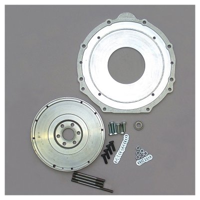

Hey chris,
yeah I know, and I saw your piece of kit on Max his Ultima, nice stuff. (sent him your way when he asked)
however I still intend to use the 184mm tripple plate superclutch, so the adaptor has to be a tad thicker than yours. I have now got the 1uz measured up and in SW just need to do the G50 and than have it milled out.

www.bncproducts.com.au/ to your rescue -- can have the kit to you in a week,-- save a load of drama :shy:

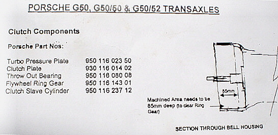

flatchat(Chris)
PM sent --We use the "short" nose Porsche starter or the "Hi Torque" and Porsche or Sachs clutch bitz that you can source :-
