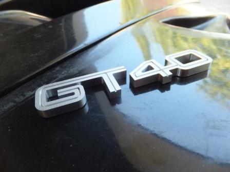

I was thinking of machining up a gated shift plate for the GT40 I am building and was interested to read about the noise when using it.
After Bodhi mentioned it I thought about an aluminium top plate with an UHMWPE plate bolted underneath with a 0.5mm smaller cut out to stop the metallic sound.
Cheers Craig Young
