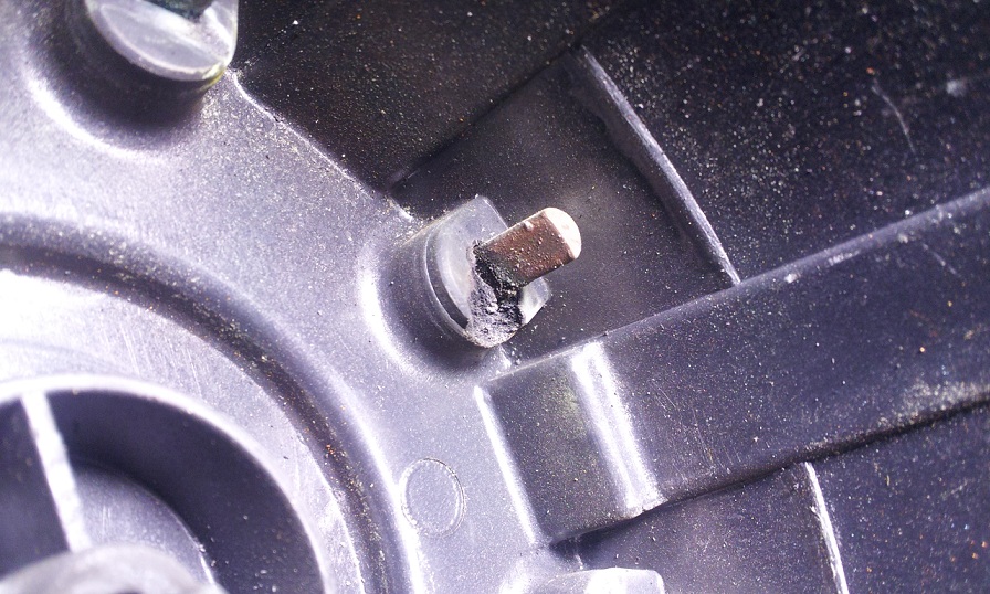

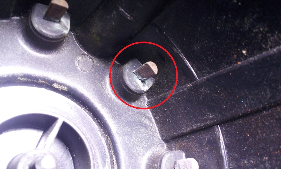

I took off the cap and it definitely needs to be replaced as some of the posts seem to be blasted pretty well. But the strange thing is that the post for cylinder #7 doesn't seem to be as bad as the others.
This lead me into thinking that, for some reason, #7 isn't getting the voltage the other cylinders are getting, or not firing as often.
What could be causing this? Could it be that the magnetic pickup in the distributor itself is the problem? I guess I'm going to replace the cap and rotor first, but I'm trying to figure out when its time to replace the entire distributor...
Here is one of the posts in the dizzy..

Hi John In the picture it looks like to rotor is running real close to the cap ??? is it hitting on the post just before cyl. 7 is there any contact markings the cap or rotor ???? Wally
We did notice that it was running really high, too. The first order of business will be to replace the cap and rotor and make sure everything is set correctly.

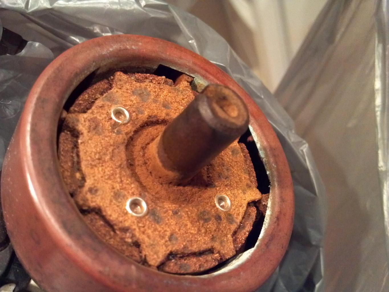

At this point, I'm pretty sure its the reluctor in the distributor. As Randy said, the GM small cap HEI distributors have a ceramic magnet which is known to crack. I found this is a known issue and can cause this cold cylinder problem. I think this is the issue. There does seem to be some strange fluctuations with the timing light.
You cannot check this problem by rotating the rotor and setting another post to cylinder #1. This is because the damage is on the reluctor pinwheel and will always cause a poor signal for whatever tip is cracked, so it will always be cylinder 7 in this case.
Just replaced the distributor and have observed no difference. Cylinders 1 and 7 seem to average 300 degrees colder than 3 and 5. Its hard to take a measure off the even side of the engine, but the even cylinders seem to be very close to each other.
