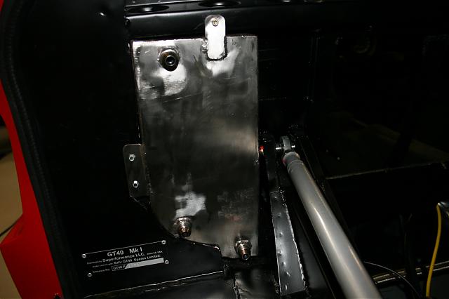

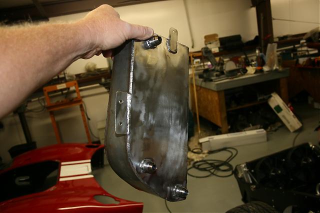

Here is a picture of a catch tank I built to fit into an area that was spare, spare room is a big problem. I have 427 with webers but will be making the conversion to EFI using electromotive down the road, I have 4 cars using electromotive and am very happy with it. I do have a friend how sells throttle bodies and manifold along with electromotive unit, he has a SPF MK2.
