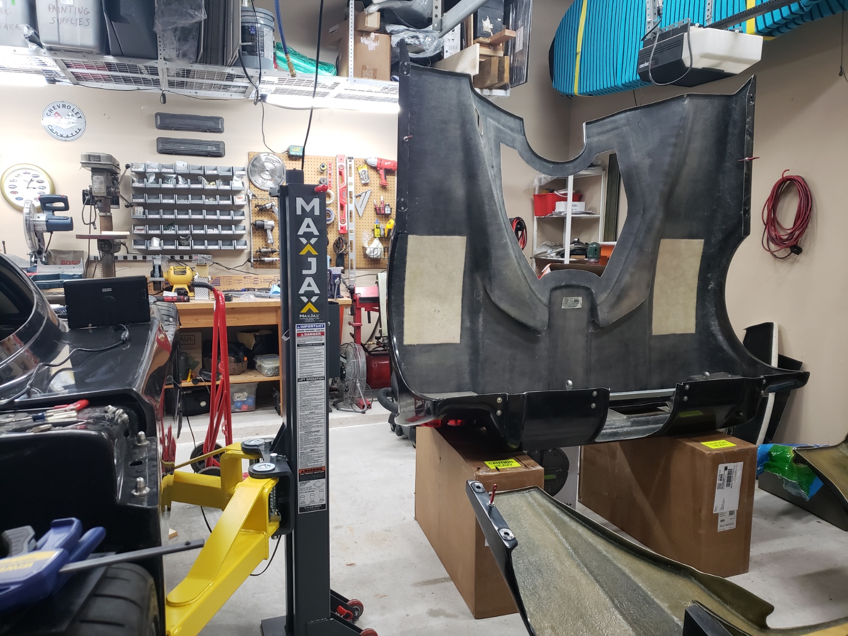

Anybody has pictures of the street rear clam with a Graziano to see the cut out? Also the rear hinges bracket need to be cut it looks like
Mark B.
This isn't a great picture, but it's the best one I could find of my graz cutout before I changed the mount. On mine, I was able to use the factory hinge bracket without cutting. It sat maybe 1/2" below the gearbox.
Alex
thanks Mark, that's a good start! it always scary to start cutting in the fiberglass lol. At least I have an idea .
