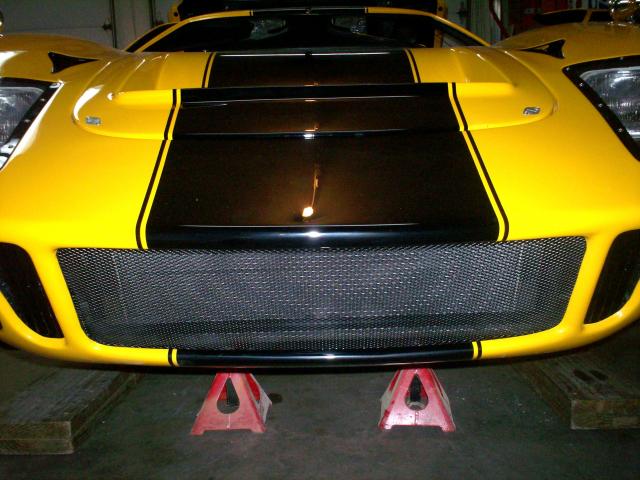

Alan,
I made my own grilles from stainless mesh, using 1/4 vacuum hose (slit lengthwise) as a gasket, and glued in place with black weatherstrip adhesive. It cost me about $50USD to make the radiator, brake duct, induction, and rear grilles. I made up templates, transferred the shapes to the screens, and began cutting. A Dremel and cutoff wheel (a few cutoff wheels) worked well for cutting the shapes. I'd guess that I spent 6 hours total, making and installing them.
There was some concern over a reduction of airflow, due to the mesh reducing the actual area of the radiator opening, but I never noticed any appreciable difference in engine temperature.

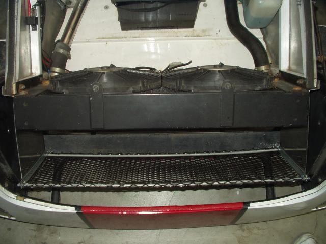

The front of the car, intake for the radiator, would be the only place to put in a screen to protect the radiator or the AC condenser. These cars are low and a lot of stuff gets thrown up by other cars. I made mine out of stainless mesh and installed it to deflect tire rubber and rocks on track.
Be aware that any screen here will restrict airflow by at least 10-20%. BUT unless you are marginal on cooling, DUE TO AIRFLOW VOLUME THROUGH TO RADIATOR, then it shouldn't be much of a problem. The inlet on the car is plenty large in cubic inches to feed the radiator. These sort of problems can most always be solved by sealing the inlet to the radiator so all the air going in the inlet goes through the radiator. Just something to be aware of should cooling issues arise.

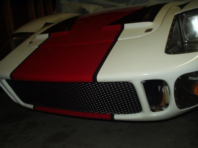

Heres one that was less than $50, made up of parts from the local hardware store
1- Porch screen door, cut out the grill mesh
2- lengths of 5/16" brake line
2- lengths of 1/4 allthread
2- lengths of 1"x1/8" flat stock
2- peices of polished stainless, from the scrap yard
4- nuts and 4 washers
Viola !

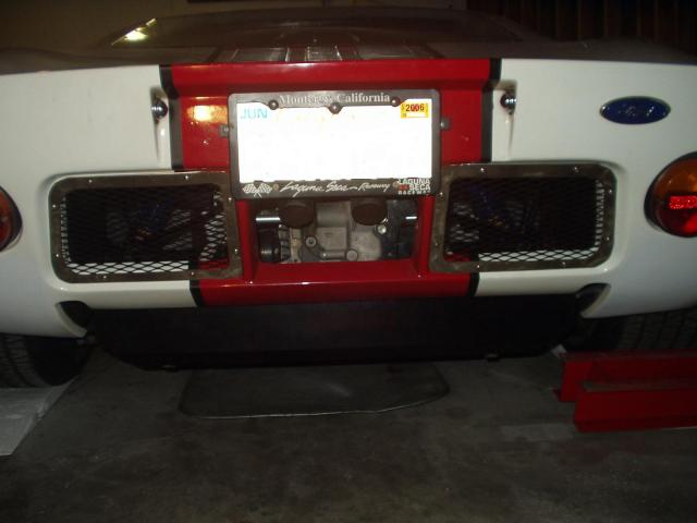

Here are the rears, that promote airflow out (exhaust) from the engine compartment, certainly better than the louvers. Again @ $50.
(note the rear view camera in the top, center of the license plate)
