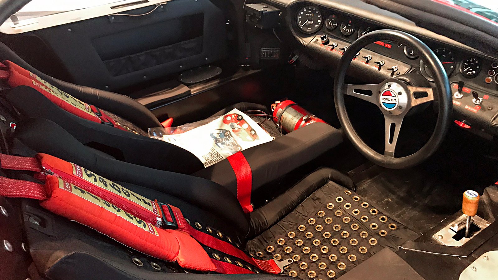

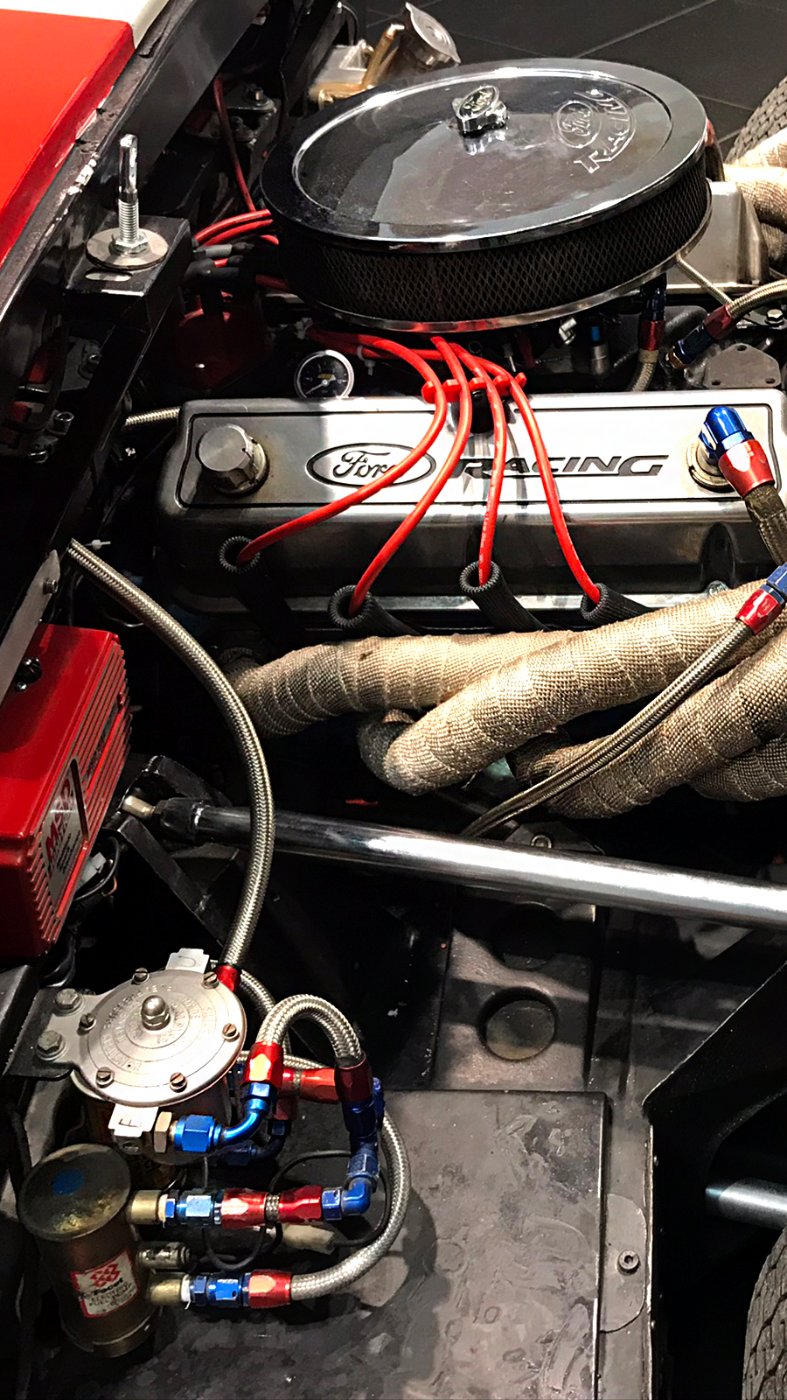

I only have this scans for the moment

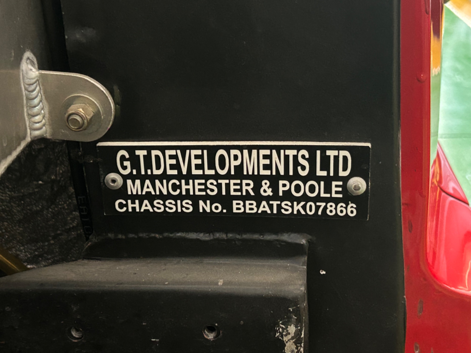

Not a chassis number matching any record I have, sorry. GTD chassis numbers in 1989 were five digit and ran between 13989 and 19889. GTD stamped their chassis numbers directly into the chassis on the cross member where the pedal box mounts, the forward cross member not the one nearer your feet.. No chassis plate per se. Hope this helps.
Mike Pass
As Malcolm says the chassis number is stamped into the front crossmember. It may have been covered by panelling. The number is also sometimes stamped into the crossbar at the very back of the chassis.
Your pics show the engine and interior. We would need pics of the front and rear CHASSIS/ suspension to see if it is GTD.

It was not completely uncommon for customers to put their own chassis numbers onto a car. Look for the chassis stamped one. Thats the one that matters. Other items look GTD but need more chassis pictures to be certain.

The fact that the chassis number can not be found is not a big issue and not a deal breaker.. The chassis can be easily identified from pics. These cars are worth the sum of their parts. It is important to know what specification parts are fitted to the car.

The engine looks to be a Ford small block. The cooling system header tank looks to be of an original pattern. It has a crossover exhaust system. I can't see what gearbox it has from the pics. Someone has put some effort and money into the car. The uprights and brakes are unknown as there are no pics. The wheels may be 15" . The tyres look like BF Goodrich not Avon cr6zz.
If the car has paperwork to enable it to be registered for the road in your country it is worth further investigation. I would suggest that you investigate the car further to find out what all the parts are and their general condition.

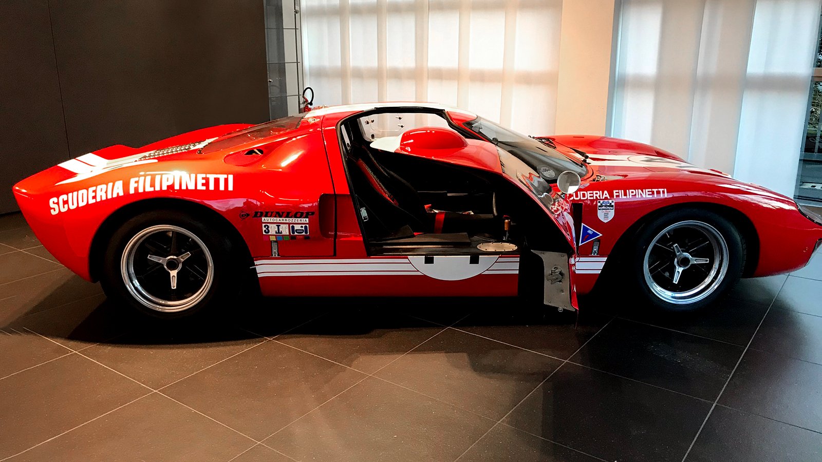

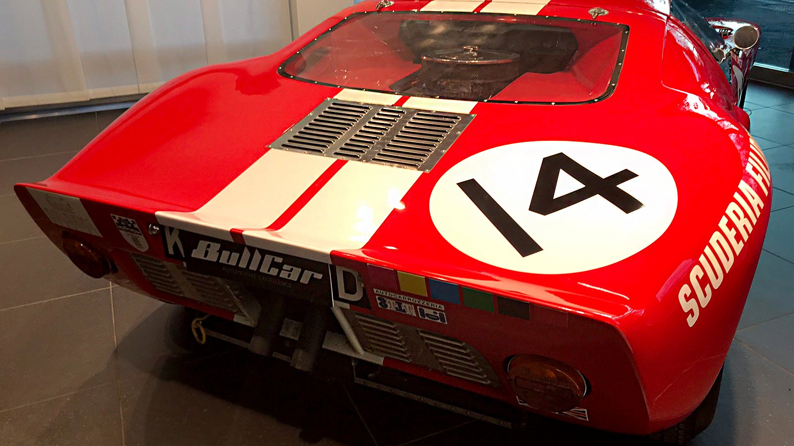

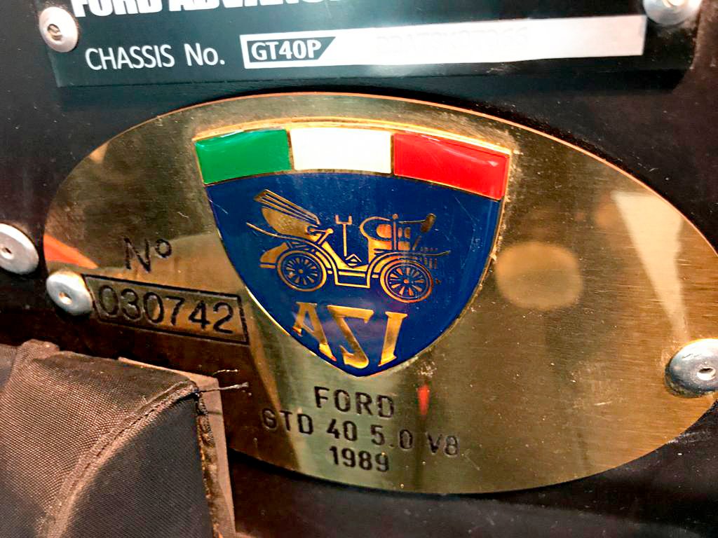

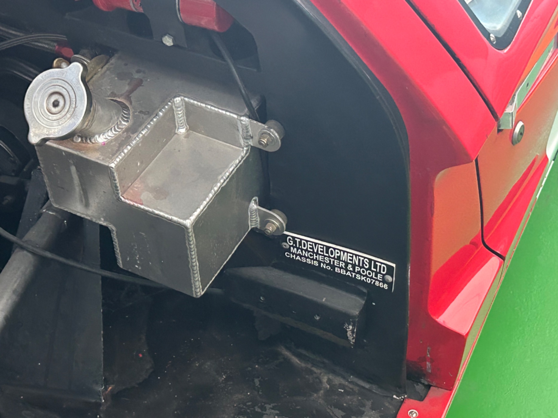

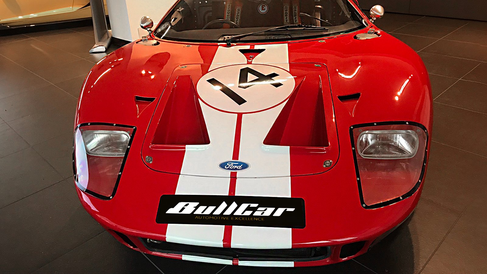

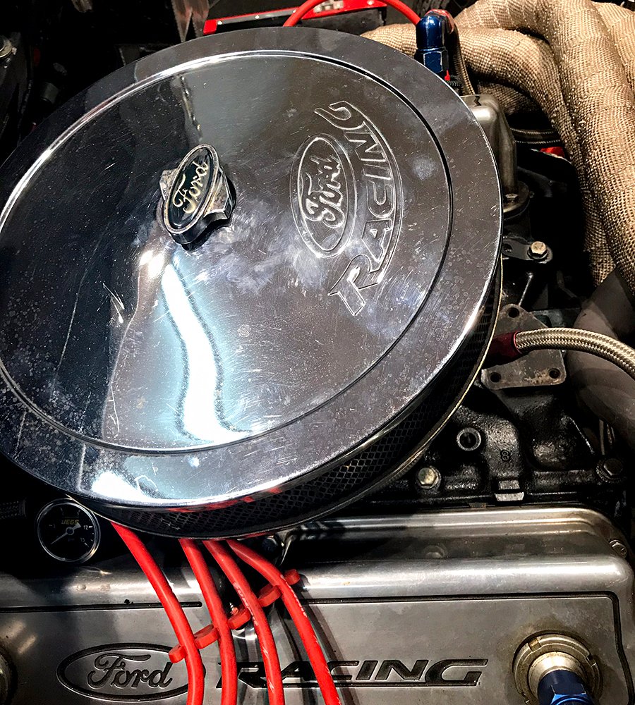

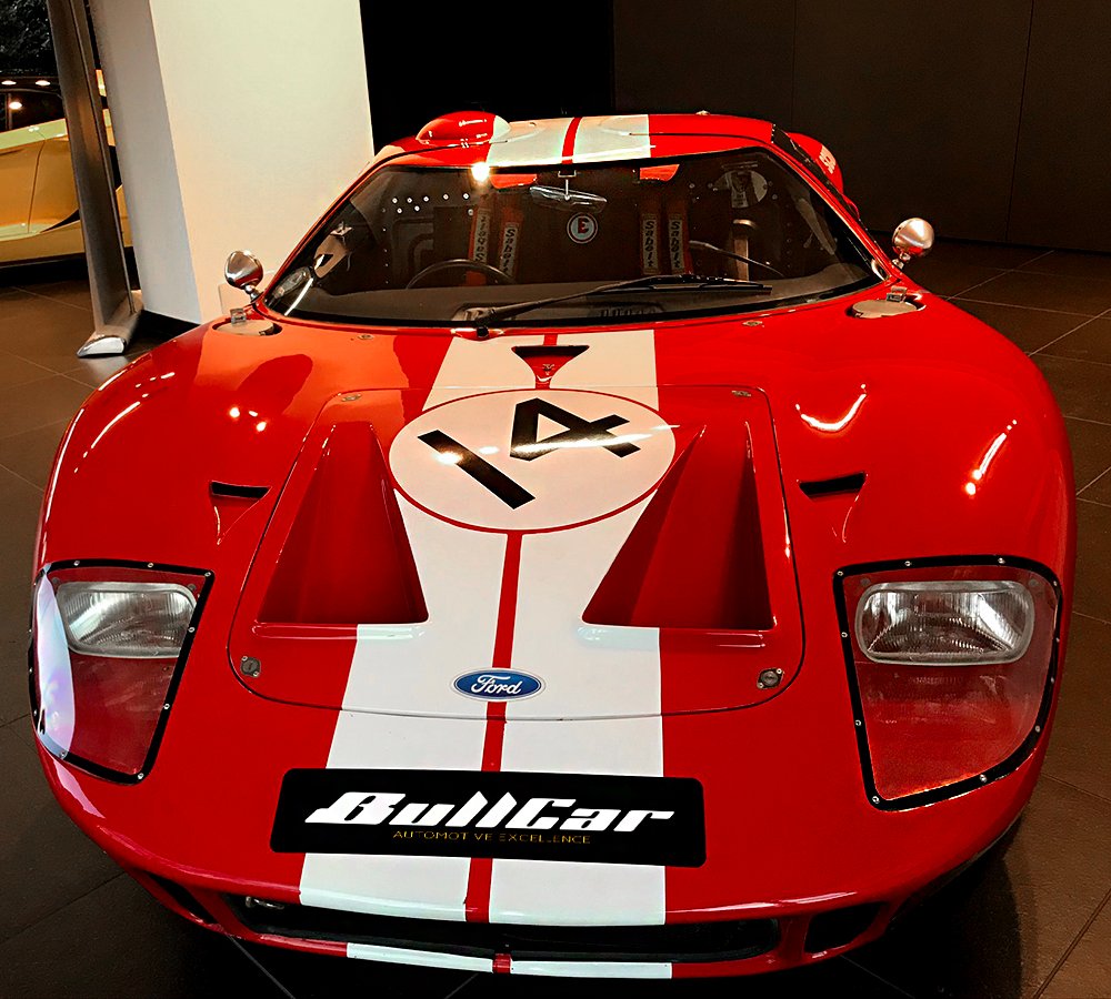

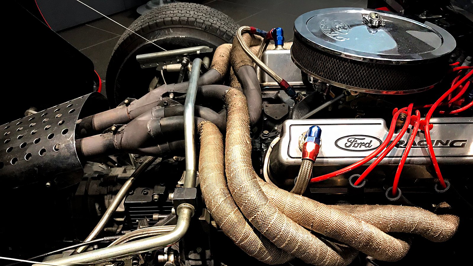

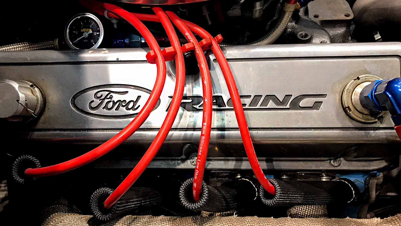

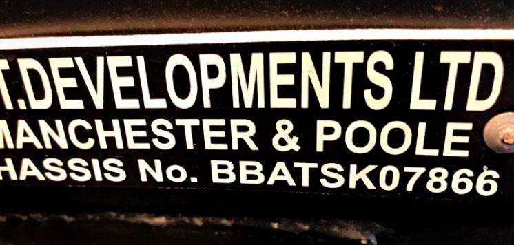

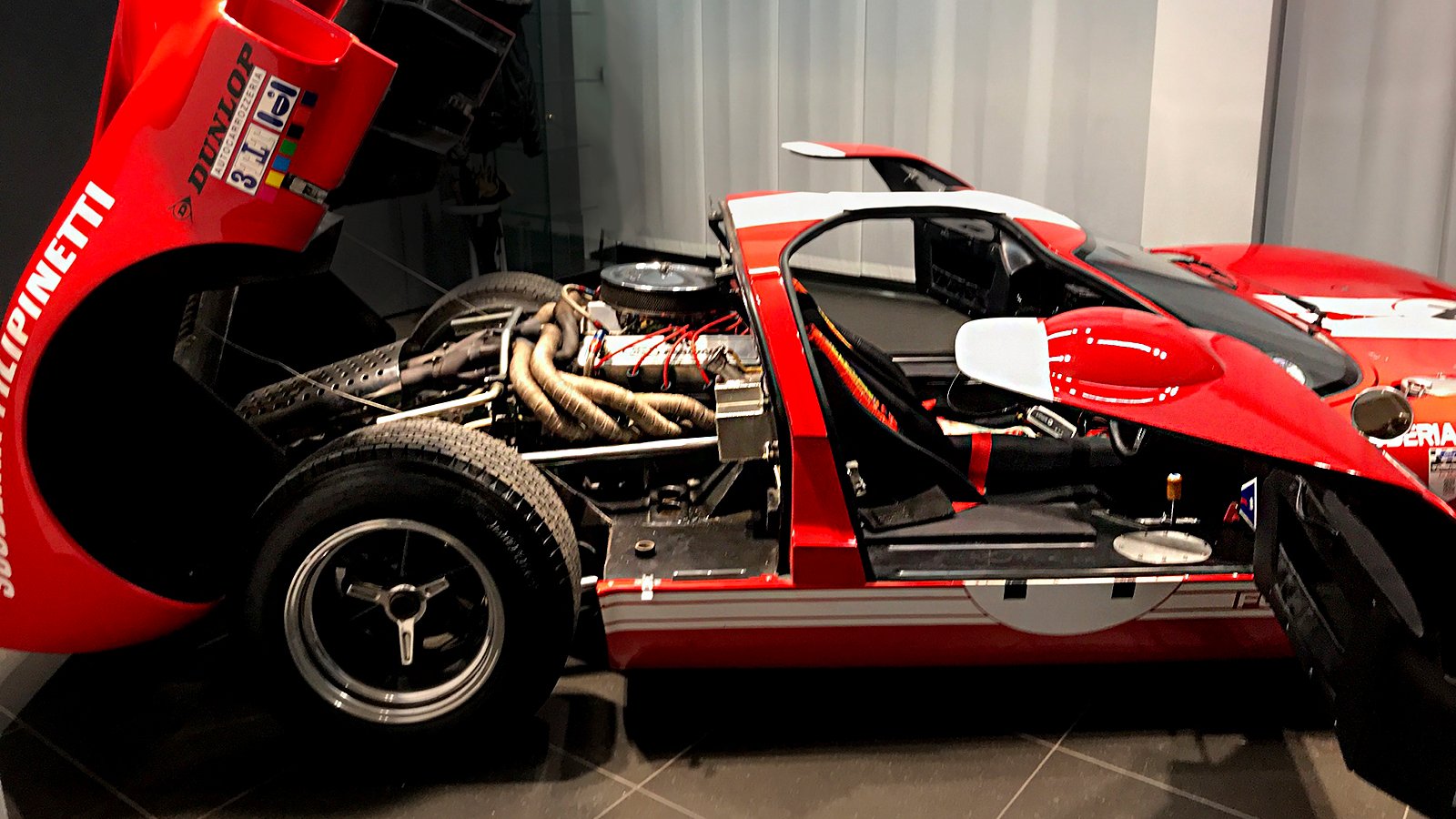

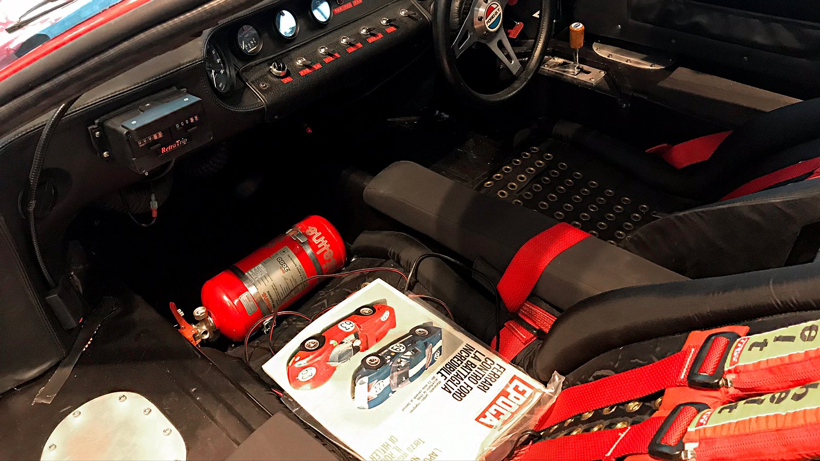

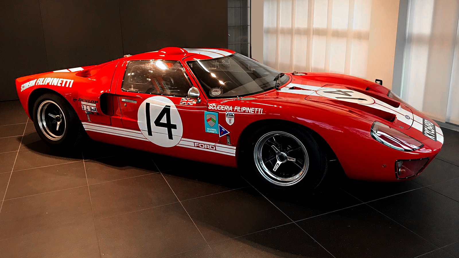

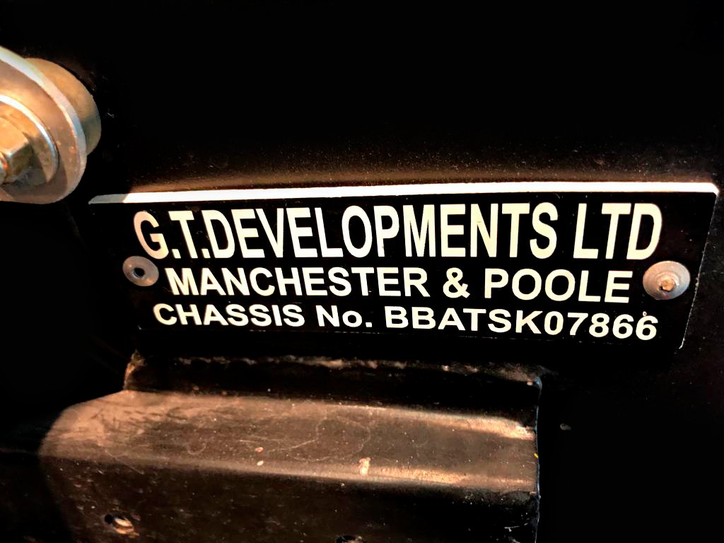

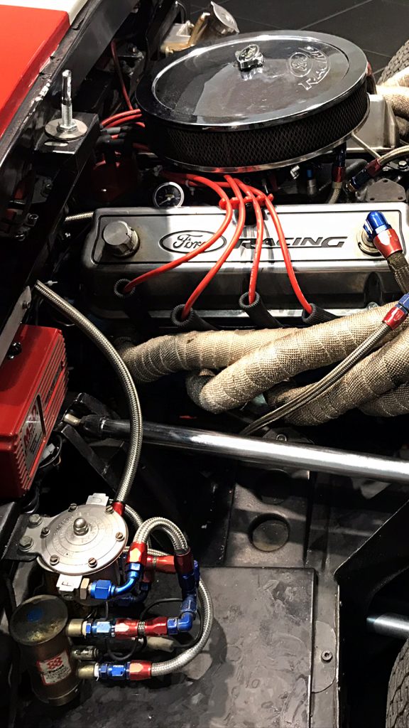

Hi Mike, thanks for reply.
The engine is a Ford Racing 5.0 with 500HP (he told me), the gearbox is from a porsche and inverted, very parts are like original and the strumental are Smiths, he did very works on it over the years for look the car to the original GT40 specification.
Also when i told him that the chassis number must be in front he told me that he checked it and it isn't and told me maybee he did some works on the front years ago maybee the chassis number is missed or deleted, anyway the car is registered for the road and is ASI (historic car register in Italy ) from 2008 and has the plate to circulate.

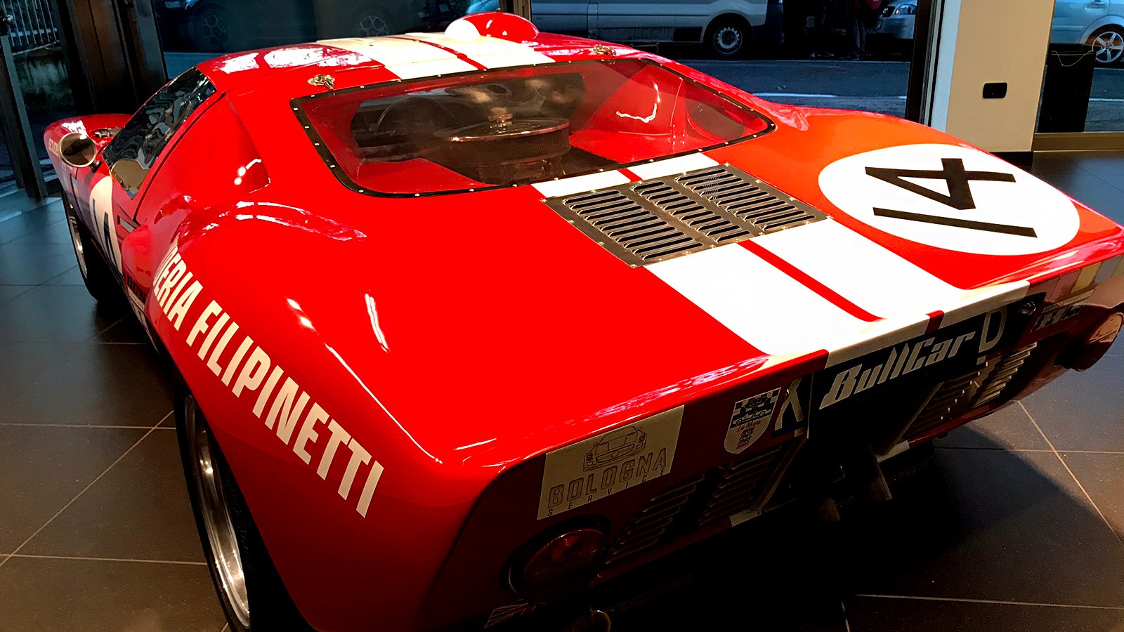

I send some photos he send to me now;

Ian Anderson
There was a member on here a lot of years back with the surname Batt…….I wonder if this is his old car and he added his name in the chassis number?
ian
Mike Pass
It may be possible that the 302 has 500hp but I doubt it and would want to see a dyno or rolling road printout before I believe any hp claims. The engine may have good aluminium heads but the pics don't show this. There appears to be a 4 barrel carb which may be a Holley or Edelbrock.. From the size of the carb it does not appear to be a Holley double pumper. Ask the seller if they have a build sheet for the engine.
The inverted Porsche gearbox is most likely a G50 which is a good strong box.
As there are no suspension pics the uprights and brakes are unknown. The pics of the front and rear chassis are not available to see if it is GTD in origin.
The exhaust manifold usually fitted to GTD40s was a non crossover type and this car has a crossover manifold. The collectors are a bit basic. The seats originally fitted to GTD40s were leather seats with metal eyelets and were sat on metal frames. The seats in this car are original type fabric seats with eyelets. These items may have been fitted to make it more original looking.

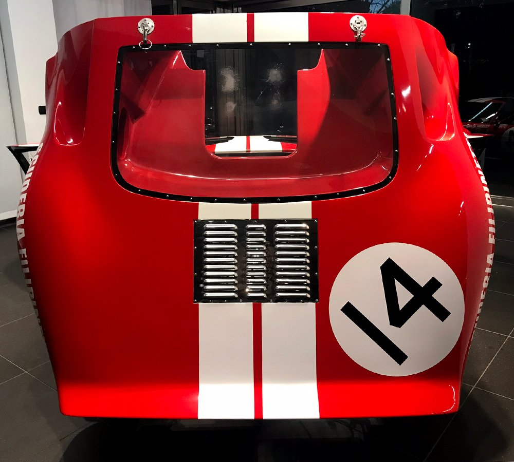

The body is a replica style shape as it has the ridges at the top rear of the doors - original 40 bodies do not have this ridge.
The general condition looks good. It has the double front nostril panel. The rear window is plastic rather than glass as can be seen with attachment screws.
