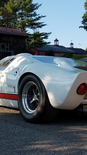

I am new in the forum and on the way to acquire a GTD from 1991. I would like to know the possible tyres dimensions from that car attached as a picture that is a GTD.
My GT40 has
225/60 R15 Front width of the front wheel unknowed
295/60 R15 Rear width of the rear wheel unknowed
but the tyres appear for my eyes too large for the front and rear arches. Sizes of the wheels 15'' is ok as standard.
Thank you, Franck R.

What lee says above but also a good number of owners now use 295/50/15 for the rear. This and the 215/60/15 front can be bought from Avon

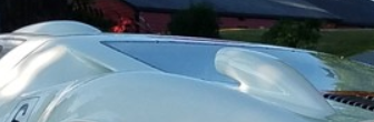

Thank you Eric. I like the space we see between the tyre and the arche. Please let me know where did you buy these accessories on the top roof and the top of the rear cover please ?

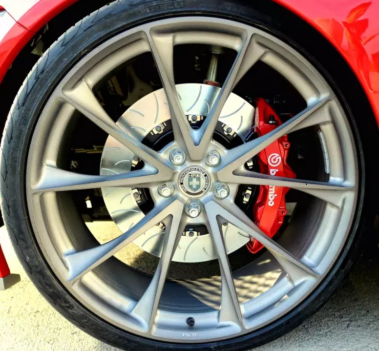

I see sa lotof GT from the web having the BRM or hallibrand wheels in 15'', 17'' and now 19'' size but I don't see any car with other type of wheels, is there any reason ?
The GT40 look refers always to the past, thing that I can understand for sure, but I don't see anyone having done "an update" for having a more modern design for that car. I put as an example the work done on the mustang zero to 60.
Is there a way for example to use these kind of wheels in 19'' ?
