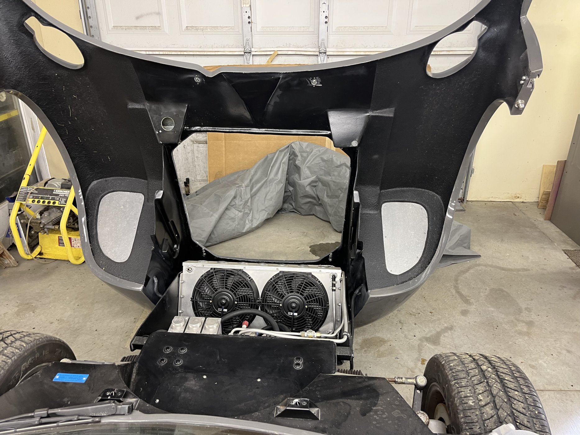

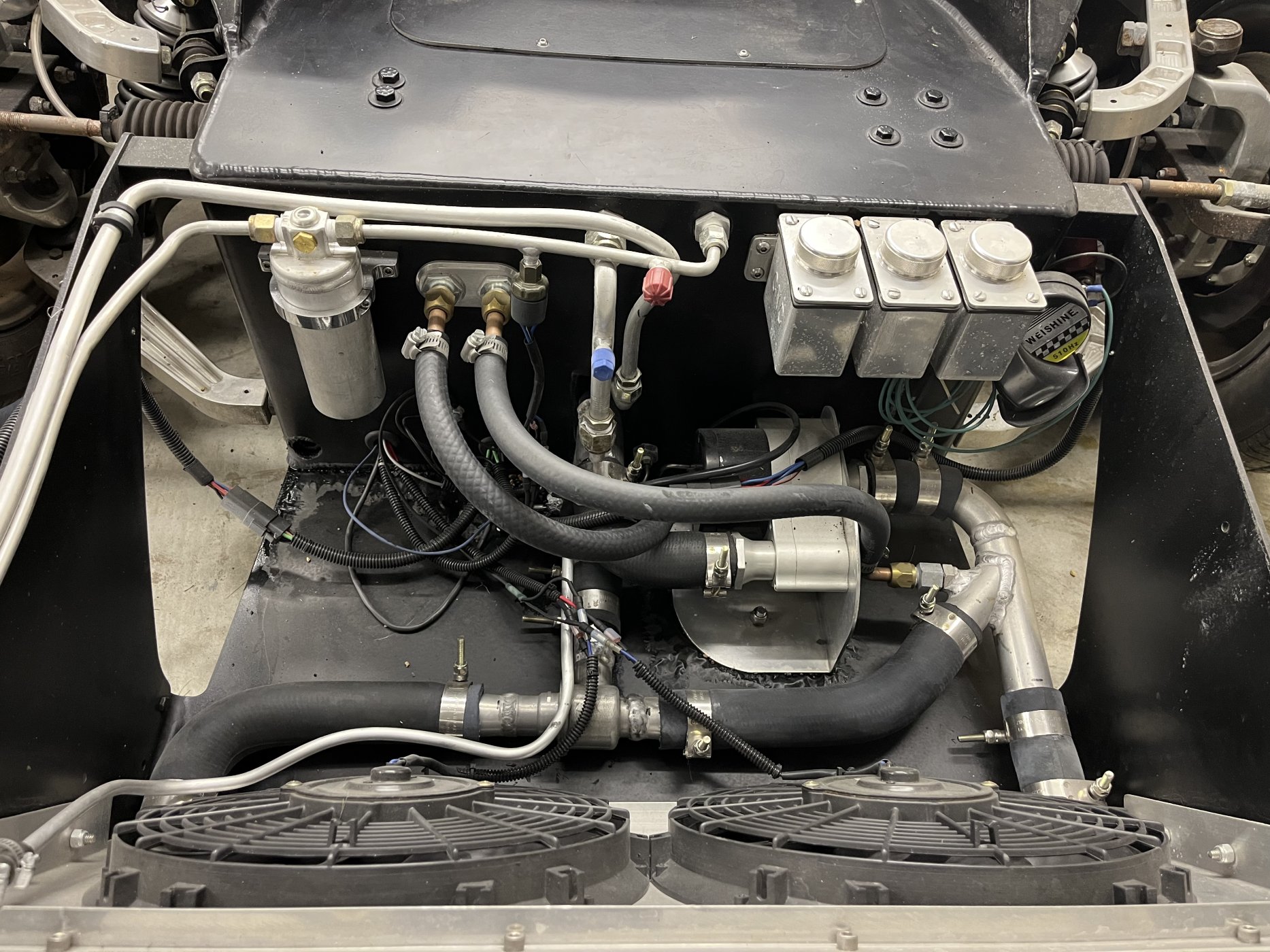

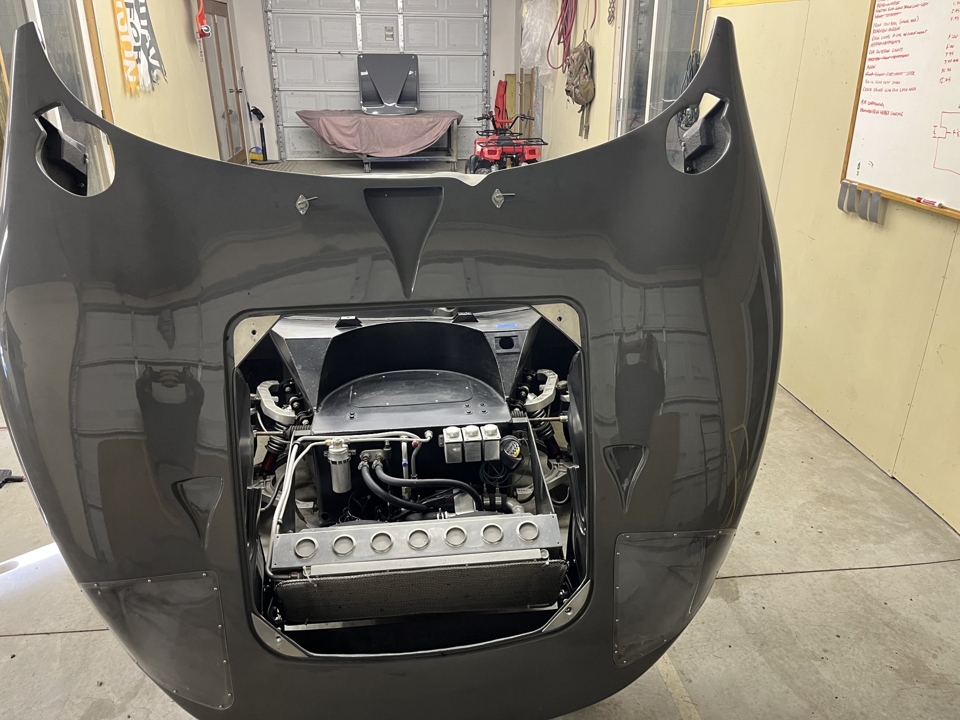

Thanks to photos supplied by Mitch Krause (current owner of my GT40)..
Mitch did not report any issues with the cooling system or any overheating…

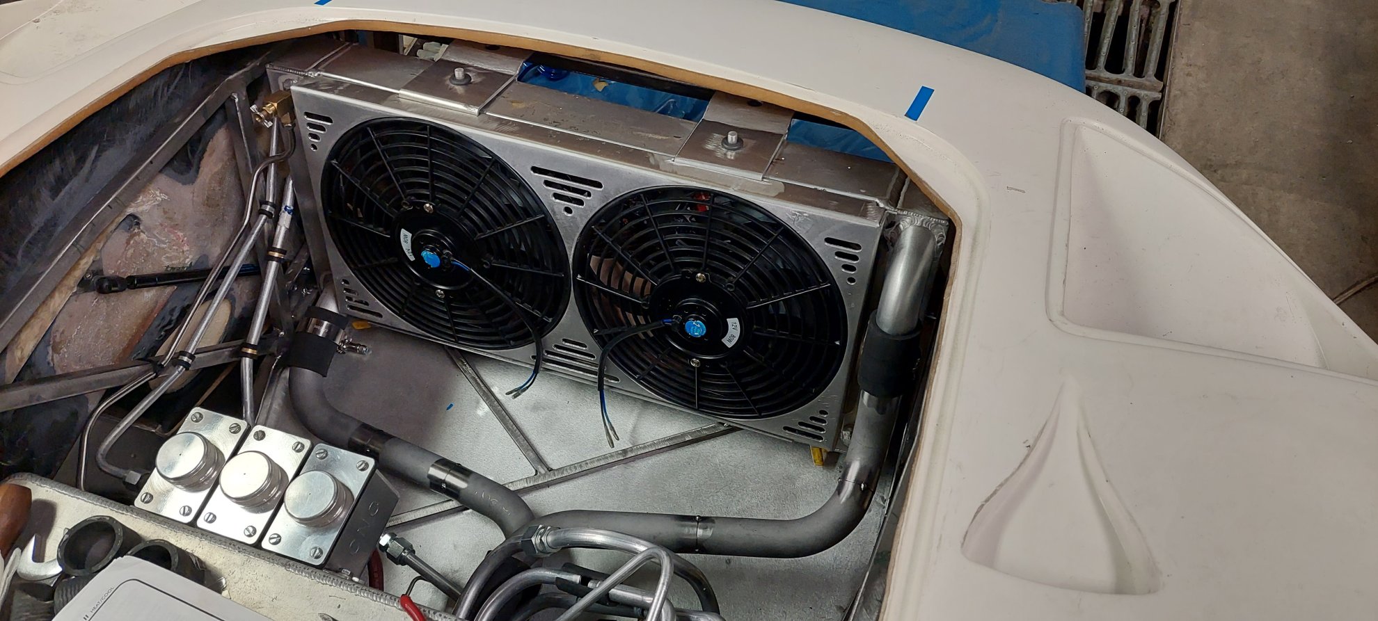

For slow speed and stop And go traffic I'm a firm believer in a shroud so that the fans draw air from the total area of the radiator. But the shroud will also restrict the airflow at higher speeds. On my shroud I took the design of some cars shrouds with slots cut in so air can flow thru better at high speeds. The slots will have rubber flaps so at slow speeds the fans will pull good and at high speeds the air will push the rubber flaps open. I also agree to seal the front so that all avaliable air goes thru the radiator and not around it.I may later open up the slots more, just see how it works.

Paul, That is a nice looking shroud. Too bad the slots will be hidden by the rubber flaps.
