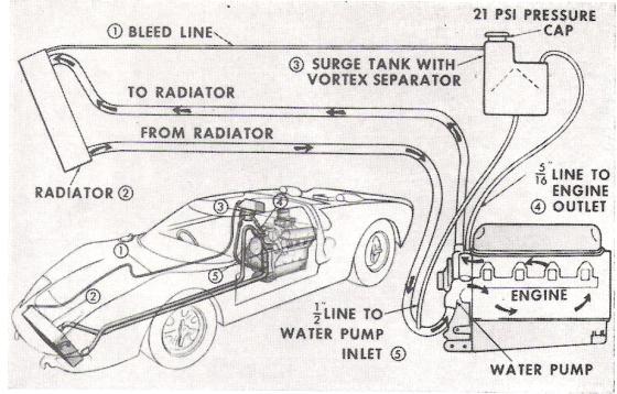

as per model ......
small line to expansion tank just to transport air.... en as said ...... combustion gasses will go in to the circuit, in very very small amount ..
every car has them .... even on the cooling system of ev battery...
