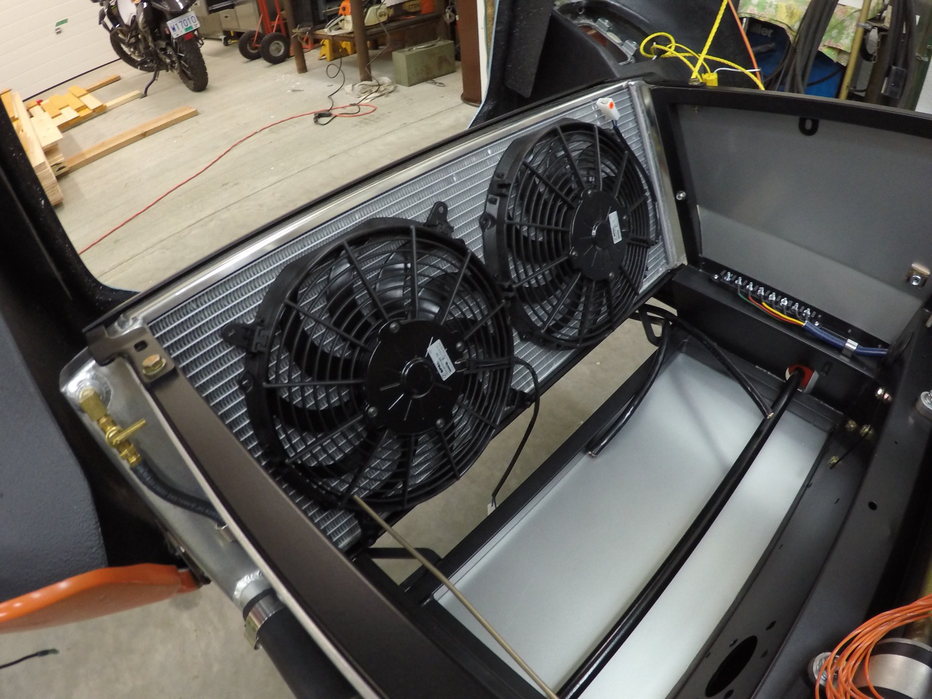

I put a vent line at the top left side tank !

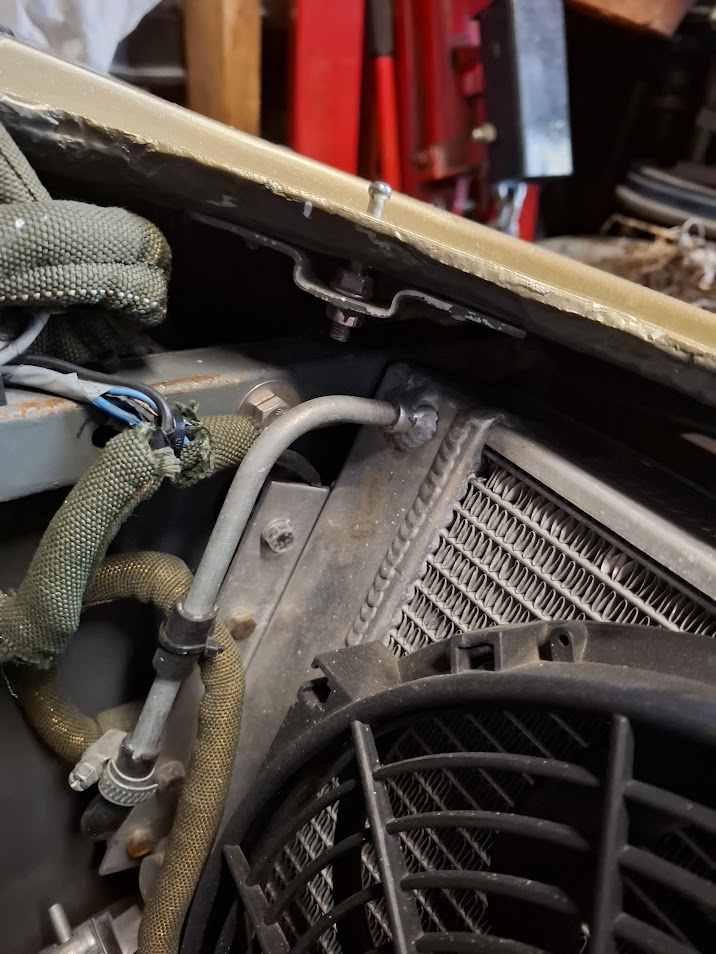

My bleedline, on the exit side.
Runs through the tunnel to the expansion tank. 6mm line.
I also run a bleedline from highest point engine to the expansion tank, in my case the top rad hose.
I run a catchtank also from the expansion tank.
Have a bleed nipple to on the intake side to make things easyer and the provision was there to do so. M6 bolt with copper washer.

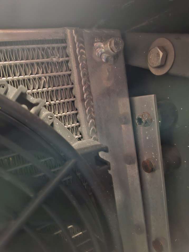

I add these to the highest point in my radiators and heater cores in my mid-engine cars to bleed air. In your case, you won't get all of the air out without a local bleed option. You might get enough air out that your car is running at normal temperature, but you won't be as efficient.
If you go this route, TIG a square of 1/8 or 3/16 aluminum at the location, then drill and tap for 1/8 NPT. Flush out the aluminum shavings before installation, of course! Drill with the radiator at an angle where shavings are mostly falling out. Grease on the tap will grab a lot of shavings too.

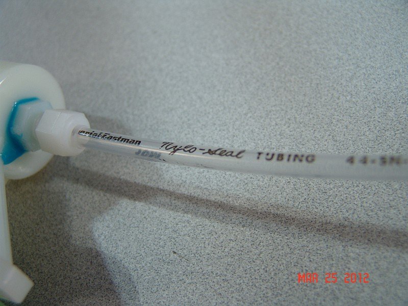

I also use 1/4" OD line for my radiator vent. In my case, I used "Nylo-Seal" nylon tubing instead of steel or aluminum hard line simply because I had a roll of it on hand. I also used it on a brake reservoir line.
