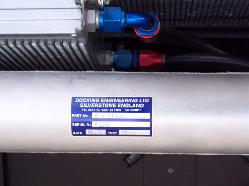

GT40 Radiator source
For those of you who might need a specific radiator, a pic i took on Ray Bellms' car (original GT40)
If it can help ...

I'm looking for a source and Docking has come up with £295 + VAT - I will have to check if their specifications will fit on a DAX
See Docking http://www.dockingengineering.com/
If not are there any other recommended sources?
