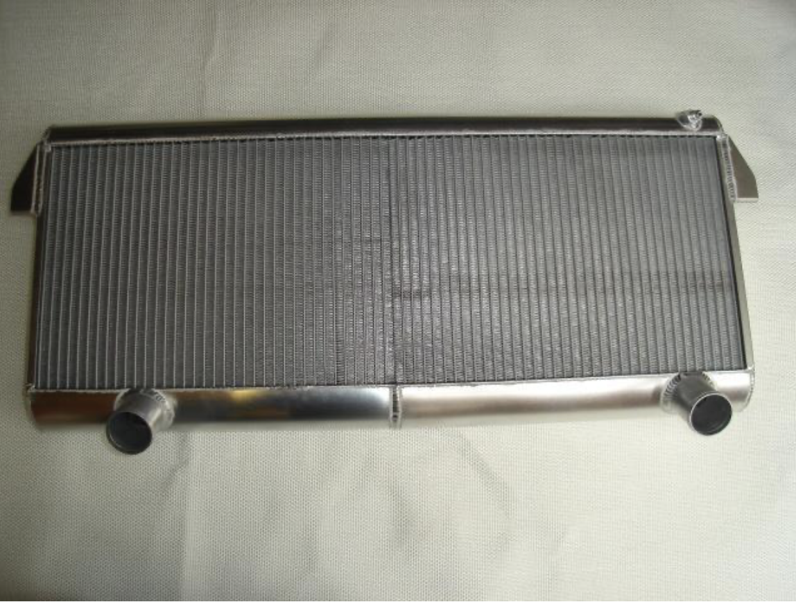

Gelscoe has the radiator available. You can clearly see the vertical tubes and center divider for the dual pass.
Can anyone tell me the dimensions of the radiator's side mounting brackets and the distance of the radiator's water inlet and outlet pipes from the radiator's edge and at what angle they exit the floor?

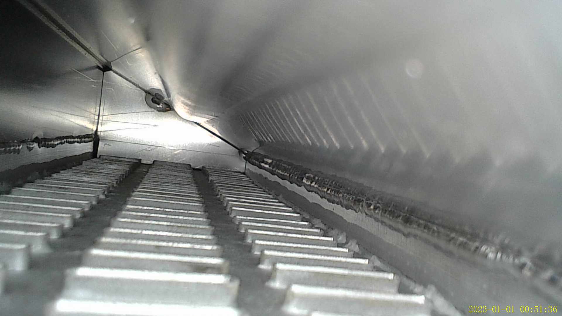

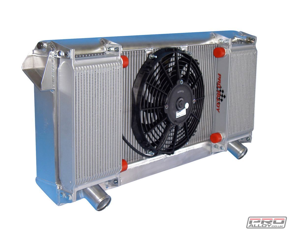

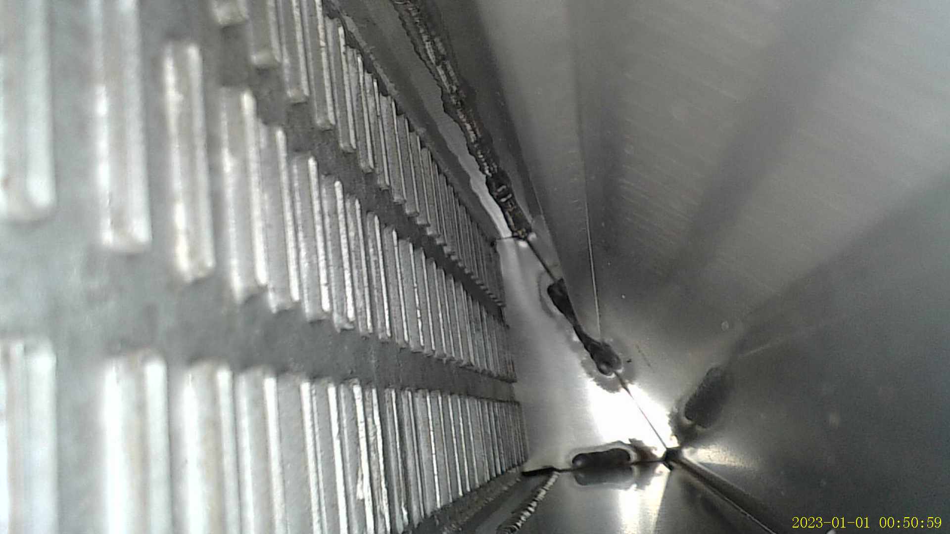

I have the GT40 radiator from Pro Alloy (Thank God I bought that before prices went up) all this talk of dual passes got me checking, Pro Alloy never replied to any of my messages about the topic and their site only says that it is 3 row core.... so I borescoped it.. by the the math of distance from where I entered on both sides at the bottom and counted fins, this either has 3 passes with a bigger section the middle, or 4 equal passes since the fins match side to side from inlet to outlet. Tubes run vertically. Pictures are one fro the right side other is from the left.
There is no welding indications on the outside of the radiator that signifies these dividing walls, which do also have small releifs in them so they do not 100% redirect everything.
Rh side looking inward on bottom.
Lh side looking inward on bottom.

Negative, the Pro Alloy radiator is vertical fins. 3 row core and either 3 pases or 4 passes. Just can't tell since you can only look so far in, but based on the total distance "lenght of the radiator" and the number of fins between inlet/outlet ports to the divider walls, it it was equally spaced sections it would be 4 passes.
I just thought I would share this data for people choosing radiators.
