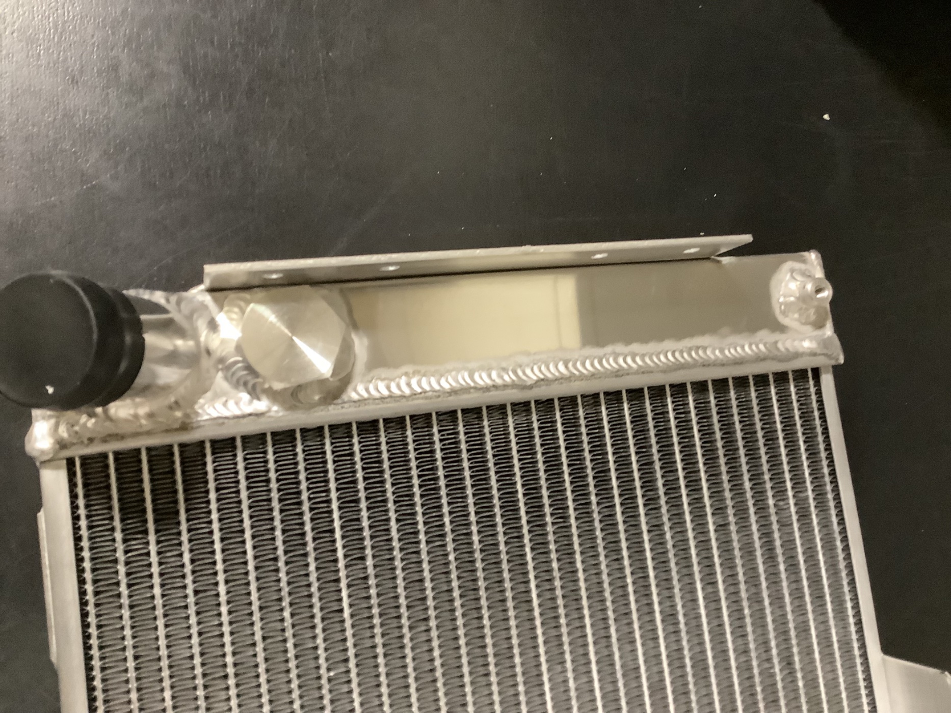

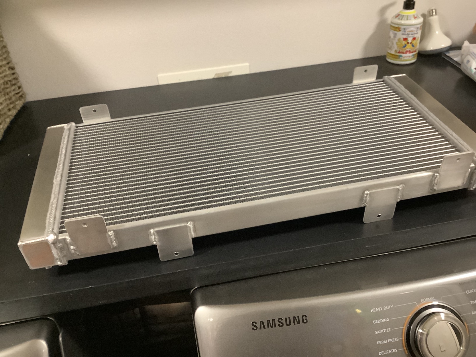

Radiator on my Gt40
Vinny P
Here are a few photos…
It measures 28 1/2” x 12 1/2”x 1 3/4”. The inlet/outlets are 1 1/
PM me if interested. $200 plus shipping.
View attachment 150962View attachment 150963View attachment 150964View attachment 150965
Hi Vinny, i was loolong at these radiators and the price just seems to be too good to be true. Have you received the rad yet (i know its coming from china) what does the quality actually look like?
For the price it might be worth a punt anyway and just swap it later if its not up to the job?

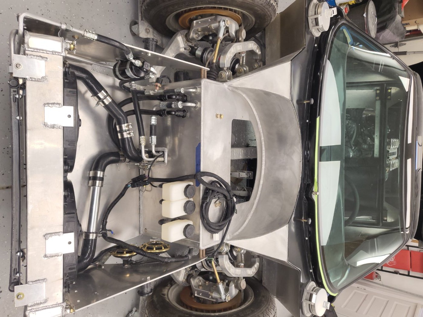

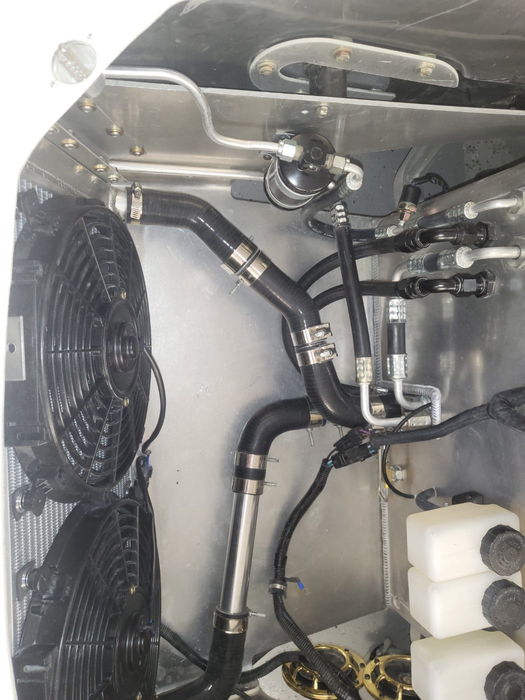

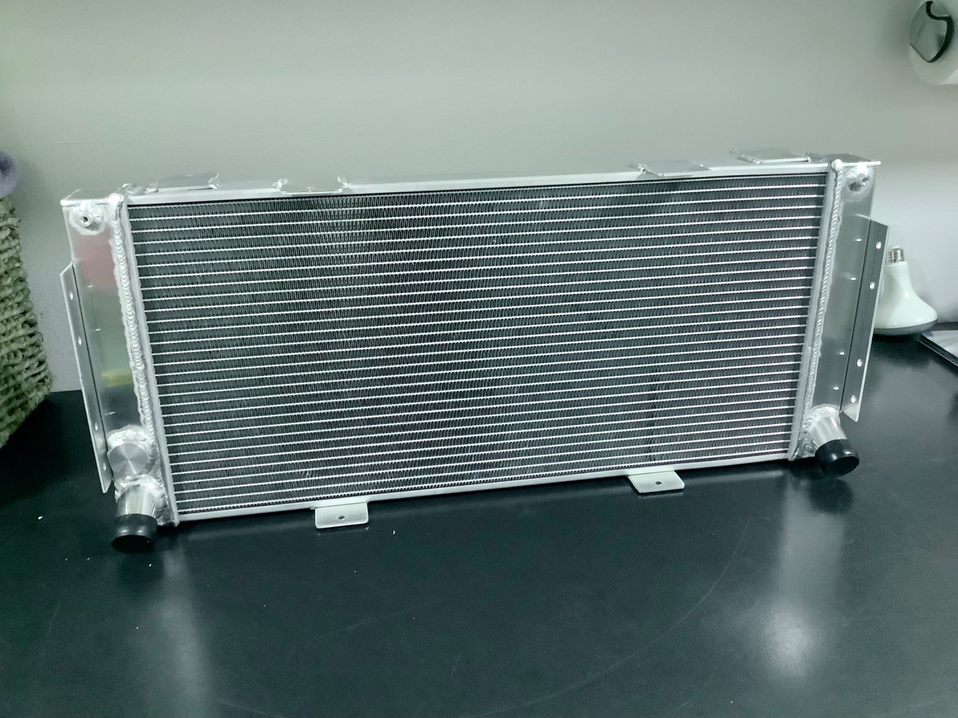

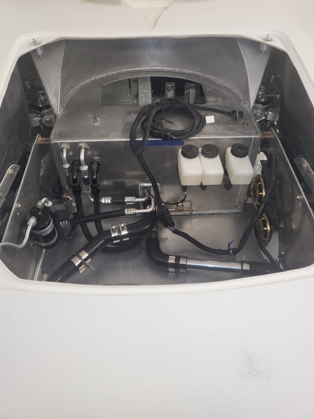

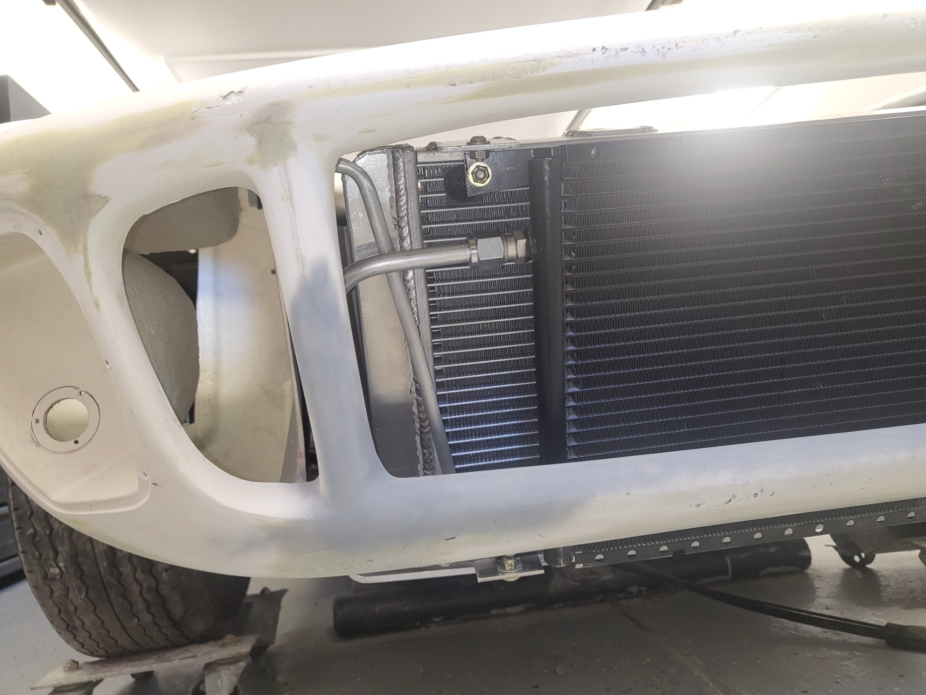

I purchased the 3-row radiator. The quality looks good. I started the install. This is just a mock-up, I have many more photos of the nearly completed install but I am having a problem uploading
Vinny P

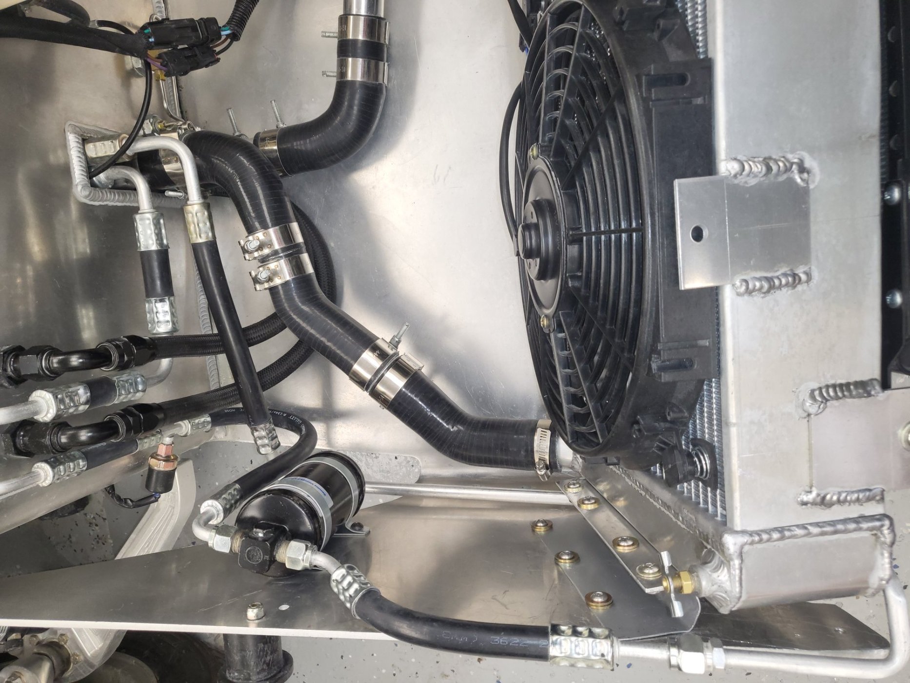

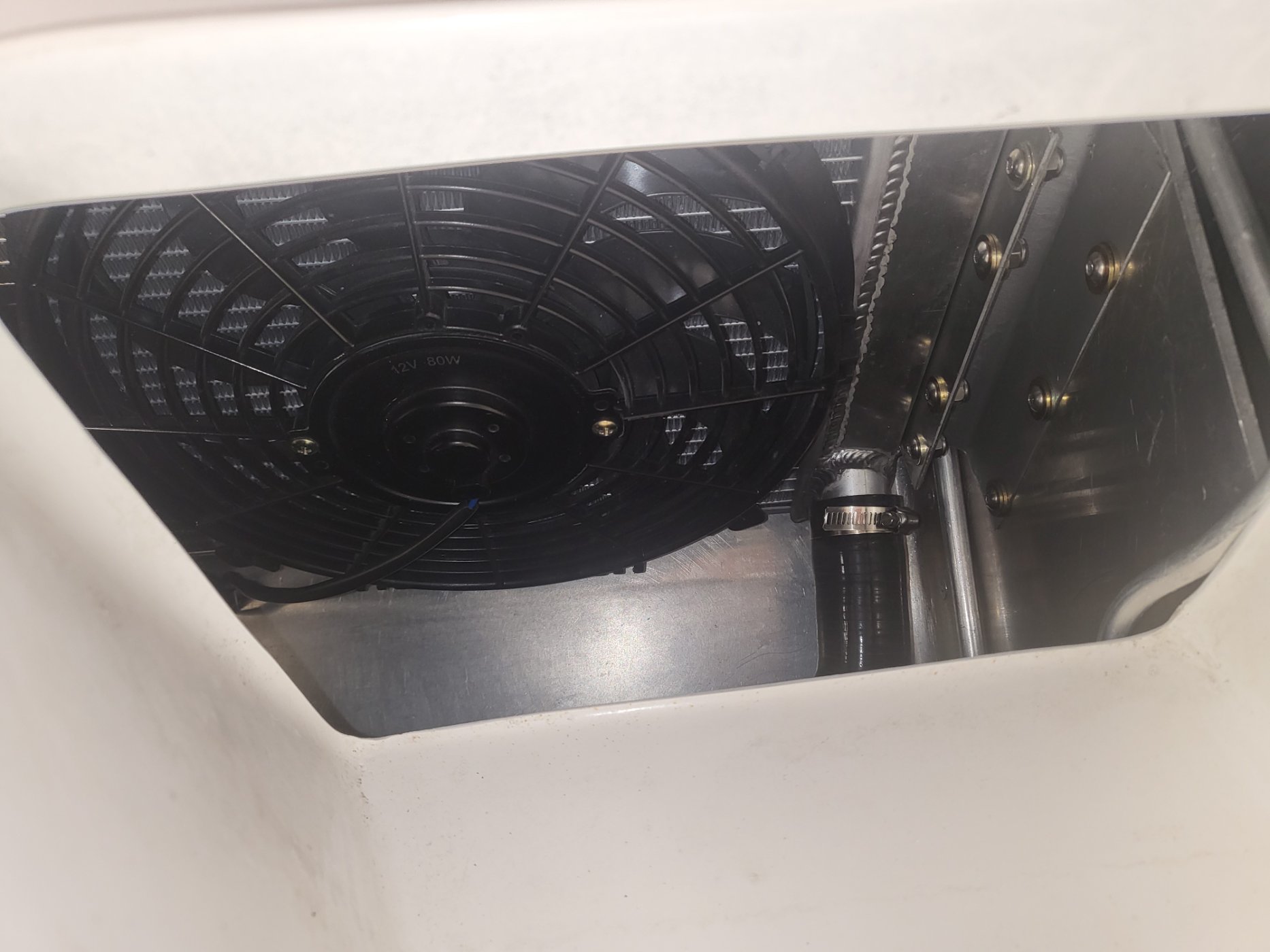

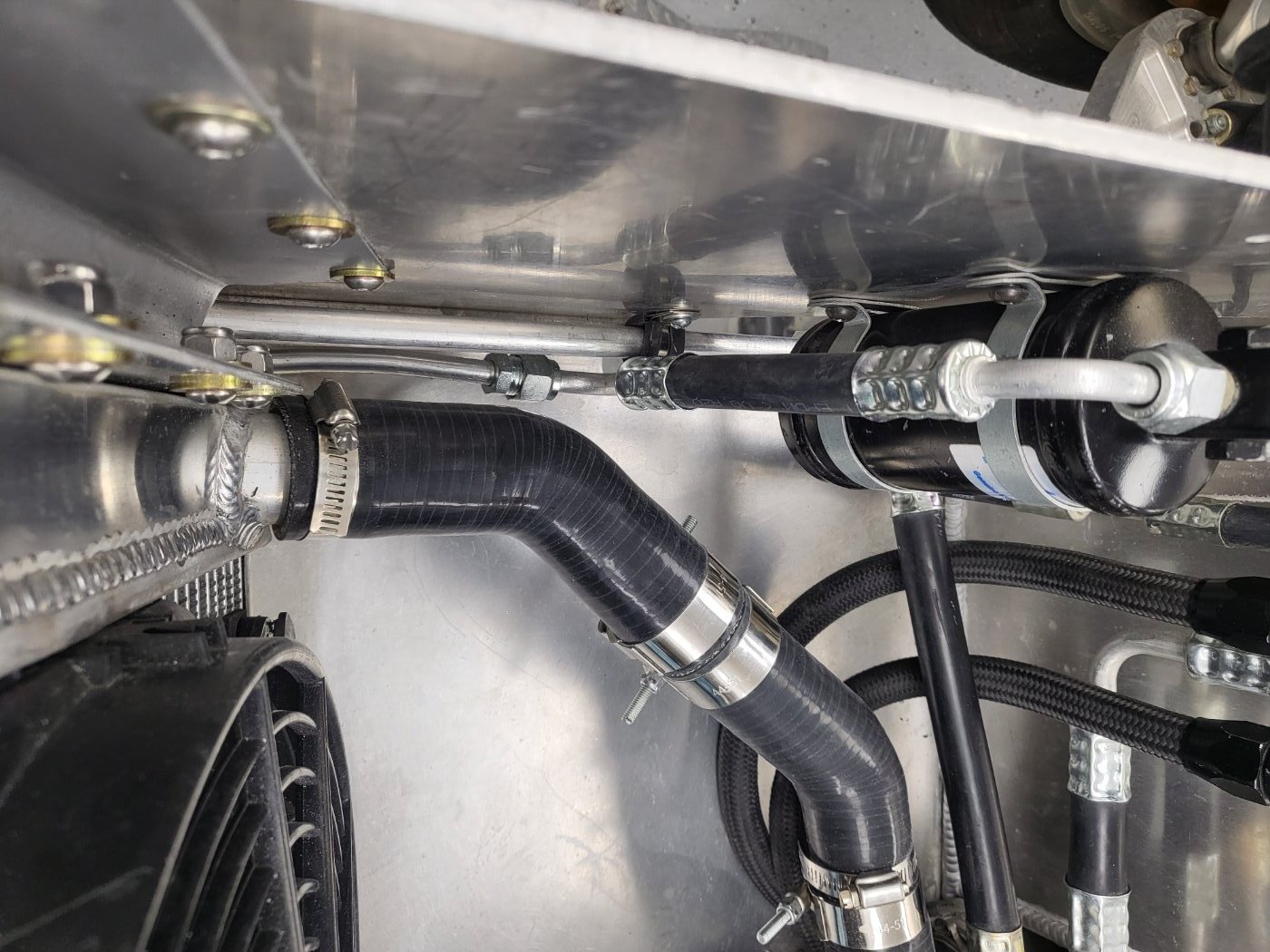

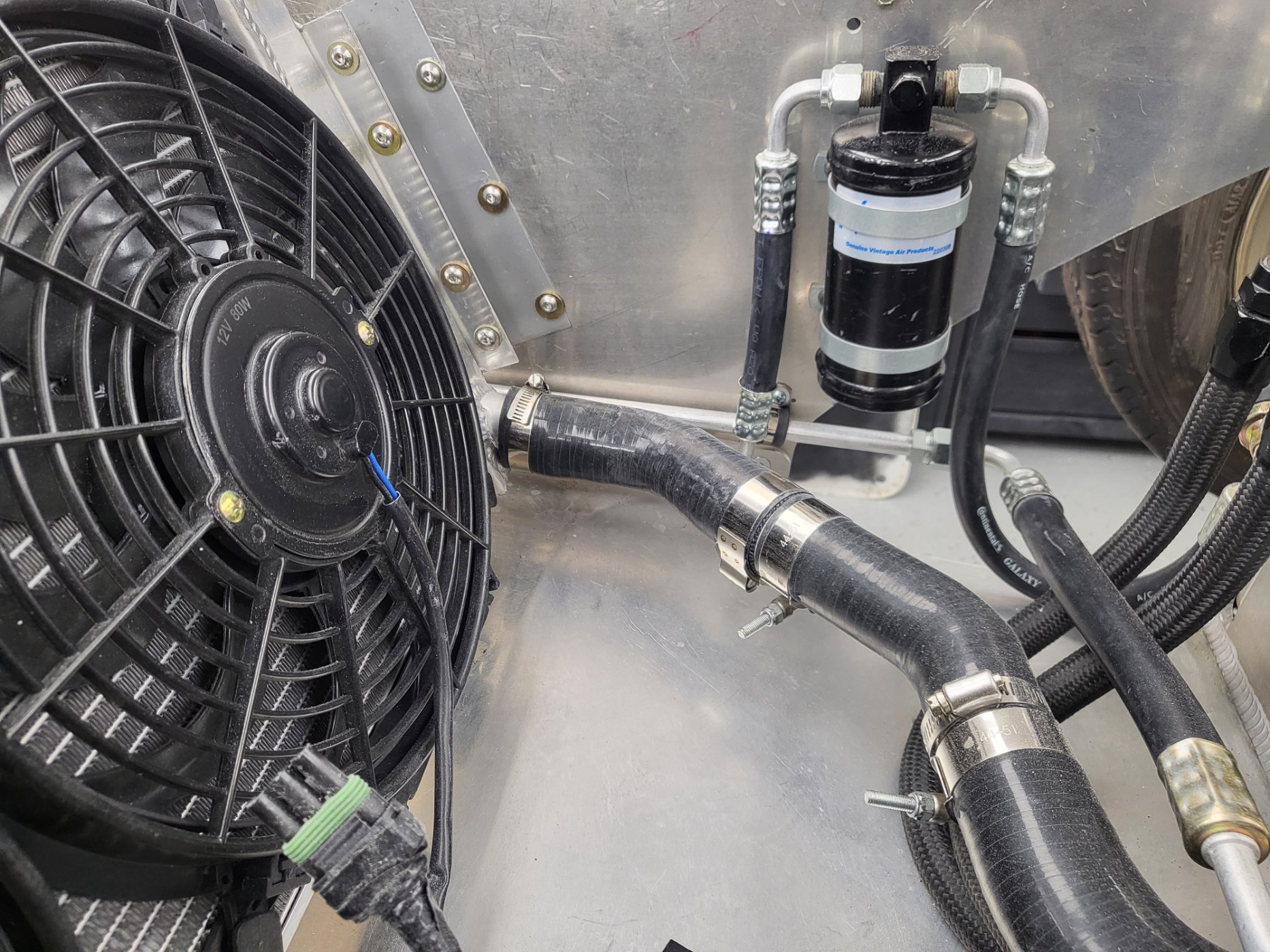

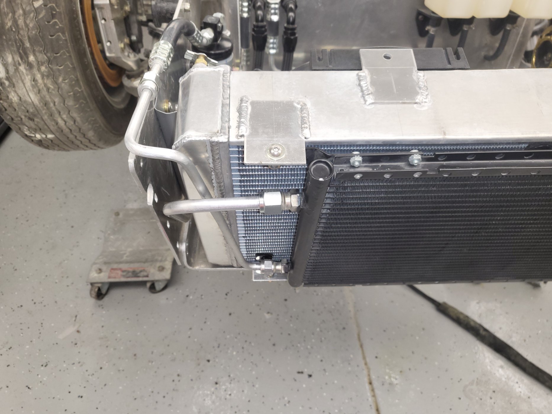

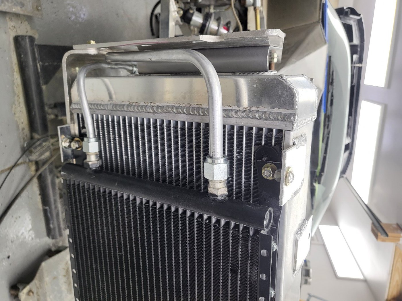

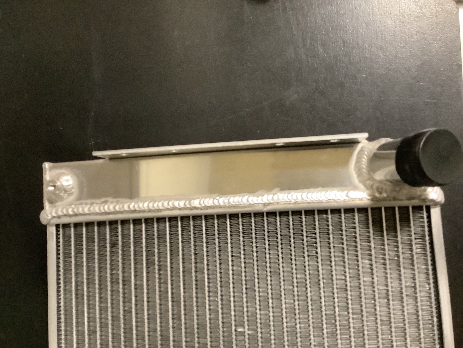

It worked out well mounting the radiator. I have not added coolant. I will let you know how it turns out once I do. I replaced the AC hose going to the dryer with a hardline. I may reroute it below the suction line before I charge the system. I fabricated a bracket on the right side and had to drill new holes on the left side of the car, pretty straightforward. The extra tabs that were welded on the upper and lower sections of the radiator worked out well for mounting the condenser, and also if you want to hard-mount your fans.

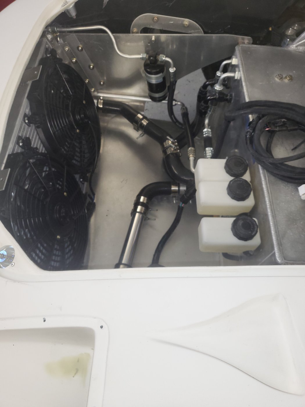

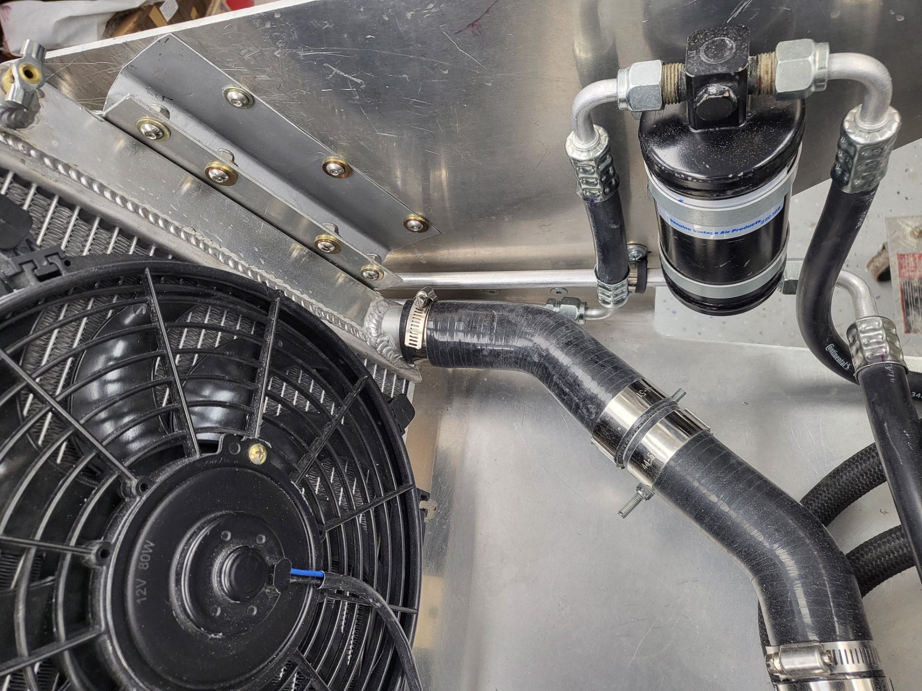

This is the final installation of the 3-row radiator, inlet/outlet at the bottom. I decided to run both ac lines alongside the radiator for a cleaner look.

Vinny, have you been able to verify that the radiator is truly a multi-pass or at least that lower input is internally going to the top such that it is a cross flow? Cheers, Randy

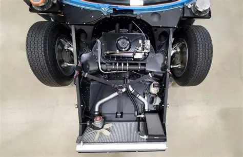

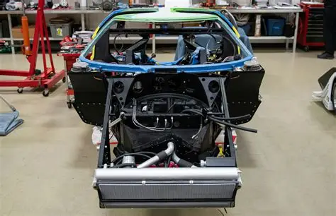

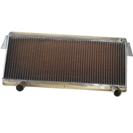

photos of 1966 Ford GT40 P/1067. road car Gt40
(Zdjęcia Forda GT40 z 1966 roku, numer P/1067, w wersji drogowej).

One thing to mention on the original vertical core radiators with both hoses at the bottom there would be a baffle in the lower tank to make it a double pass radiator.
I noticed in the photo that there's a partition divided into two. I'll make the same one and the second one divided into four and see which solution will have better performance.
