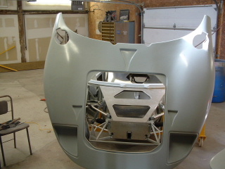

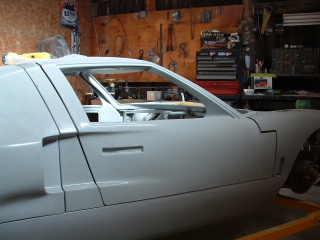

Hey Mark, The panels were fit in NZ yet I did final fit them here. I do have plenty of final body work to complete it to my satisfaction though. I did some panel stiffining so that I can properly block out the panels.
Denis

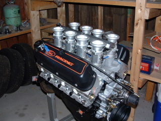

Pete,
I put valve covers on it and tmw induction. That's all. It's a Ford motorsports crate motor rated at 345 hp. I plan on driving this car around as much as possible so I wanted reliability. Not much planned to beef it up. I do have MSD billet dist and 6al coming.

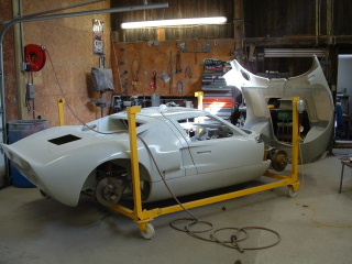

12" of snow last night.Did my snow plowing duties this morning, spent the afternoon and into tonight working on the GT40. Recieved a stud kit needed to install TMW induction-Did that installed MSD Billet dist. Rolled the engine out back and went on to the body. The drivers door was too high in the top front. Had to split the skin off and rebond it in order to lower it to its proper placement. The parts are coming in slow but sure. Got a set of headlamps from Alpine America in Canada.Cut them in, very tight fit. Also did the dash instrument installation awhile ago.All lenses fit as is the rear plexi.Expecting the transaxle soon so that I can fit the engine and trans in.17" wheels are on order at PS Engineering. Hope to see them soon.Will post photos soon when things start to look different.
OK Mark This is for you. I did get some time to work on the GT. Got the fuel tanks fit and the fuel fillers fit. The cladding in front on the GT40NZ now has carbon fiber aprons and filler wells. All fit, was a task.One headlamp mounted one to go.Was goin well til I had a call. Had to bring a family member to the Emergency room for a couple of broken bones. Alls ok but that was the last time I was able to work on her.Hope to see wheels soon. Will post photos soon.

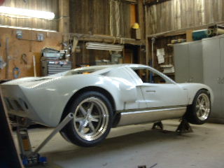

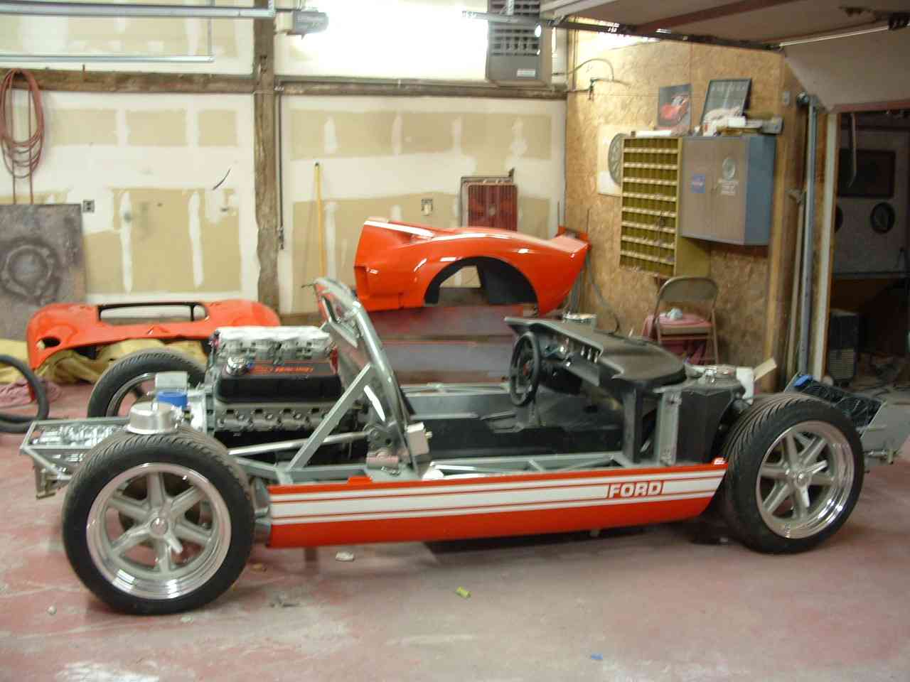

Just received my 17" BRM's from PS eng. LOOK!!!
