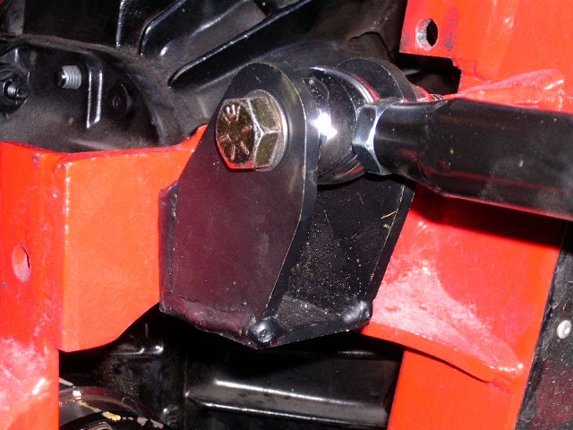

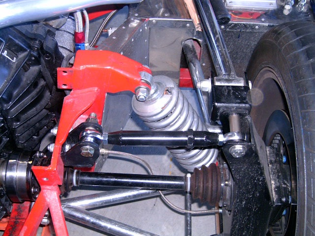

Here are the pics of the modifications to the upper rear link chassis mount. As the pick up point is further out from the chassis and raised up this reduces the rate at which the rear camber increases as the suspension moves upwards.

Howard Jones
Ya, That's mine. The reason I used a bracket was I didn't want to weld on the chassis. Welding a new set of mount ears would achieve the same results.

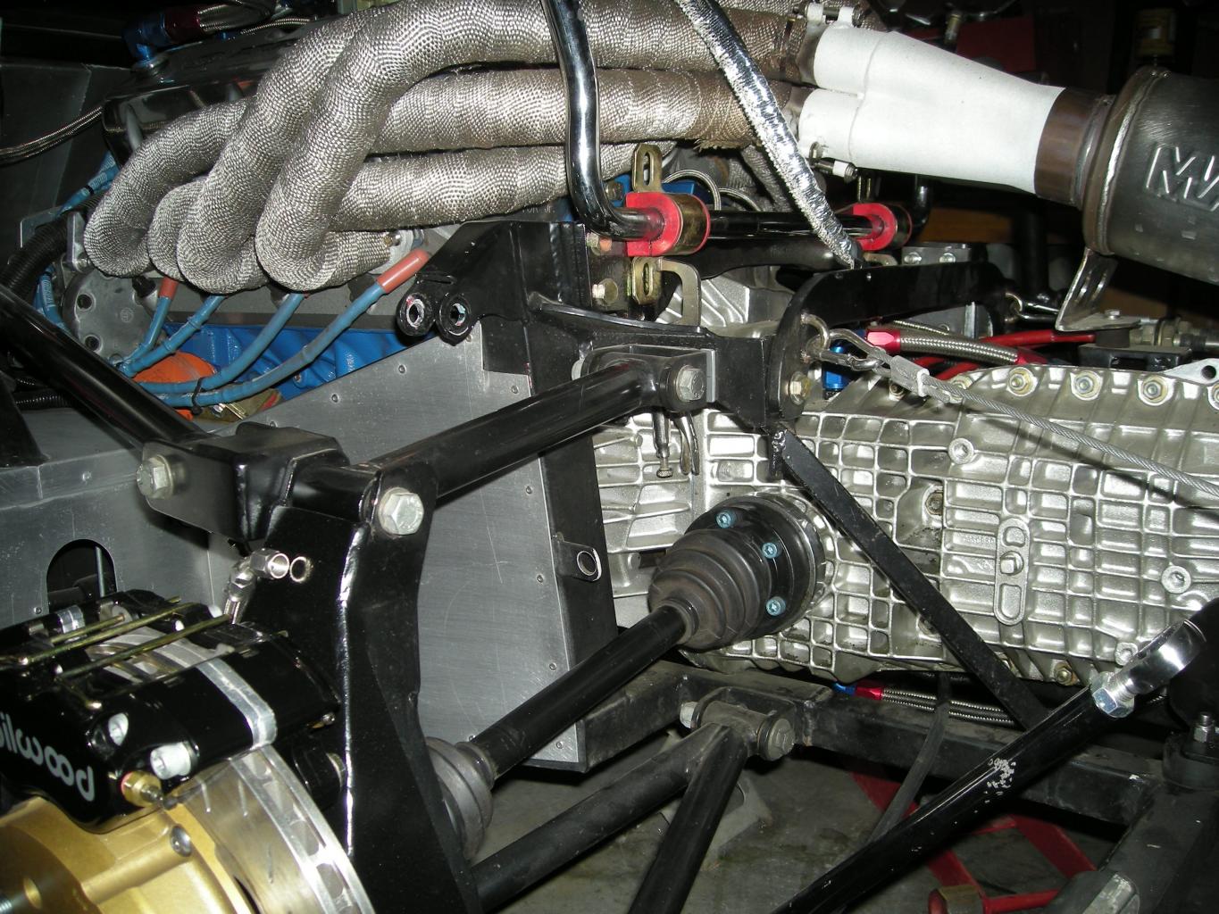

I did the suspension upgrades to mine after reading all the threads on the forum. I layed mine out on auto cad and have all the dimentions if you want them.
Bob

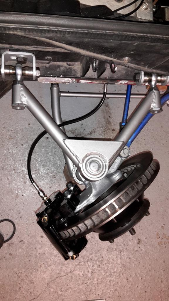

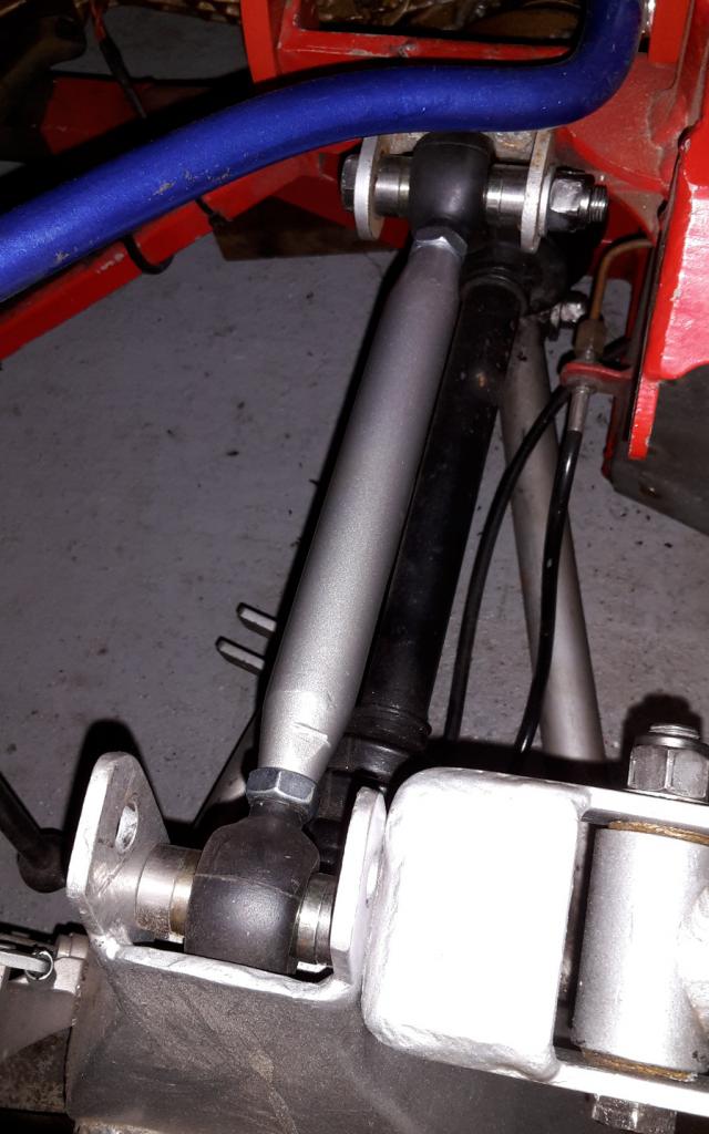

After some winter months some time for a update.
- Front suspension: Here I went for the Southern GT solution. I had to cut some material away from the lower arm to avoid contact with the disc. Also I could experience the difference in longitudinal position of the the left and right wheel mentioned before on the forum...
- Rear suspension: Here I lowered the position on the outer upper hub. This was an easy job.:thumbsup: I replaced the upper arm with an adjustable one. Parts used from Mc Gills Motorsport. Also ordered some boots to protect these joints.
