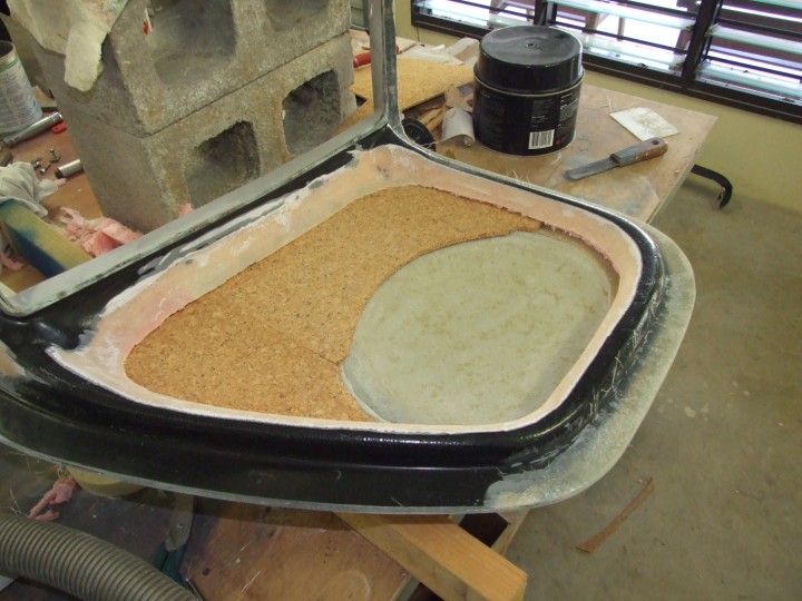

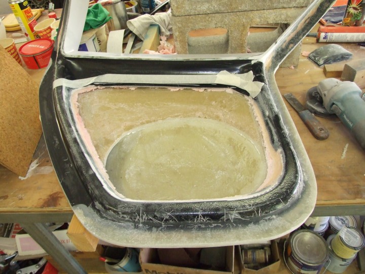

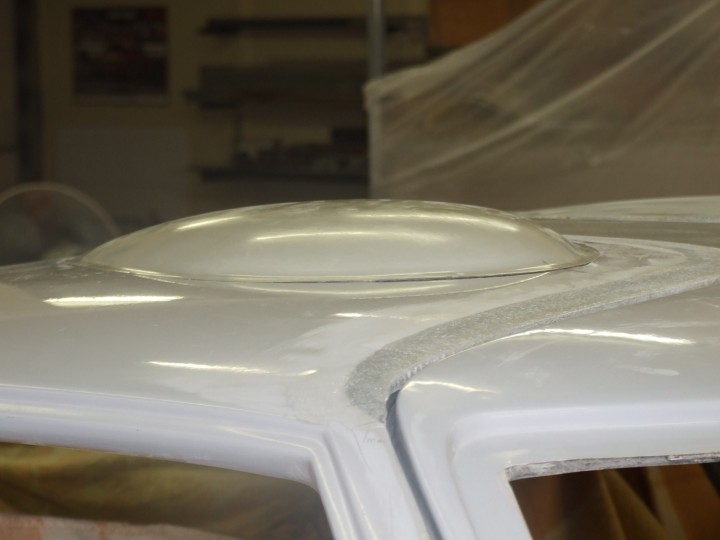

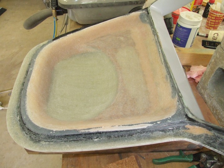

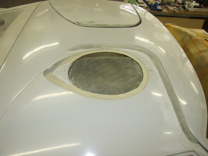

Yes, on top of the door, but I set the flange into the door top skin so there was no 'ramp' going up to the bubble. You will need to flare the inner skin into the bubble as well. I removed the whole inner skin and added 5mm of cork then glassed it over. Gives a little insulation as well as returning the strength.
Plus it gave me a bit more head room.

You're right Glenn, I was going to move it rearward and have a small section attached to the spider, like the MkIV.
But as you can see from the middle picture, I would have had to cut away the strengthening rib to achieve this. So this ended up the best location for me.
