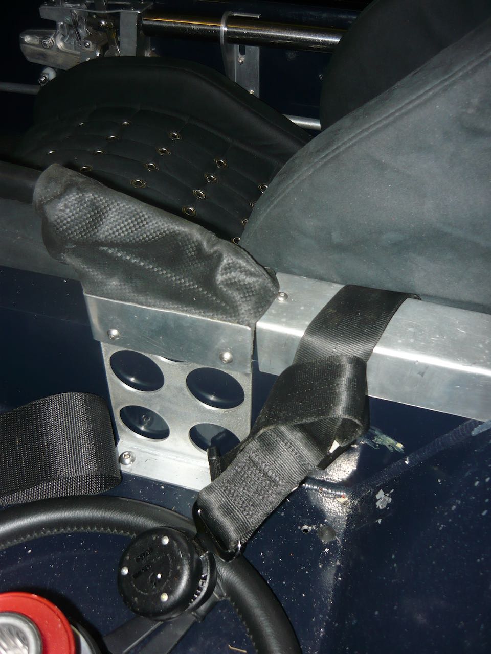

Back to the main issue which is now solved: P1010598.jpeg
After removing the whole handbrake assmbly from the floor I realised how adjustment can be made very easily. Simlpy remove a single bolt (located on top - right behind the hand brake lever). Then one can flip up the cover which is hinged at the rear end and one has access to the cables. In the process I replaced the 2 steel mounting brackets by aluminium versions. Saves quite some weight and I think there is no sacrifice to safety.
