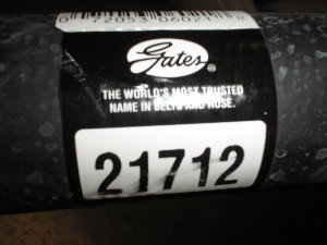

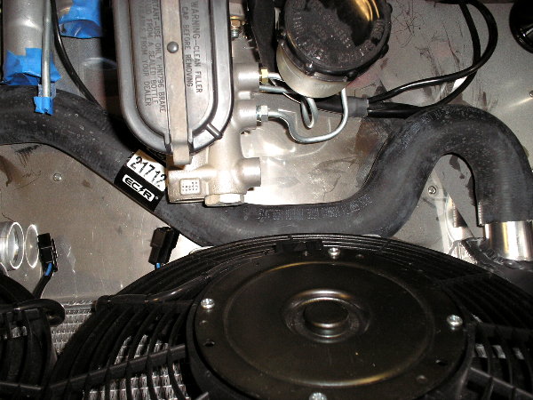

Here is a Gates hose I found in the rack at the auto parts store. It is a 1 1/2 inch ID. This pic is before I cut it (at the straight section against the radiator base) This cures the radiator neck too long syndrome and may be useful on other makes too. Dan

That hose does not have a spring inside. I don't know if that will cause it to collapse or not with a rear engined car. Just keep an eye on it when you start it up.
