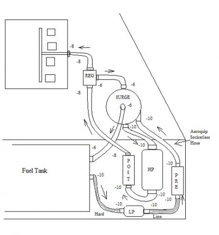

- Because of the design of the tank and the significant acceleration possible with the car, it is possible to unport the fuel pickup, especially when the tank is less than full. To address this, it is necessary to add a surge tank.
- The surge tank acts as an intermediate, or header tank. It is typically a tall cylinder, so that hard starts and stops can't push the fuel away from the pickup at its bottom.
- Two fuel pumps are required: one to feed the surge tank (can be low pressure) and one to pump the fuel from the surge tank to the engine (must be high pressure).
- A fuel pressure regulator is needed to control the fuel pressure.
- The LS7 engine (and I think all LS engines?) have a "returnless" fuel system, which means that excess fuel does not flow through the fuel rails and back into the fuel tank. Instead, excess fuel bypasses the regulator and flows back into the main tank from there.
Attached is a diagram which originally appeared on another thread in this forum. The diagram shows a fuel/surge tank layout that was the basis for the system installed on my car, although the fitting sizes indicated on the diagram are not the same.

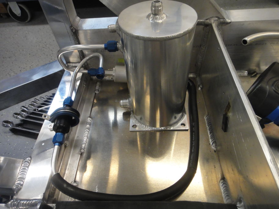

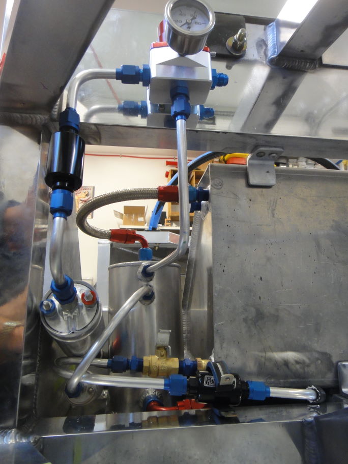

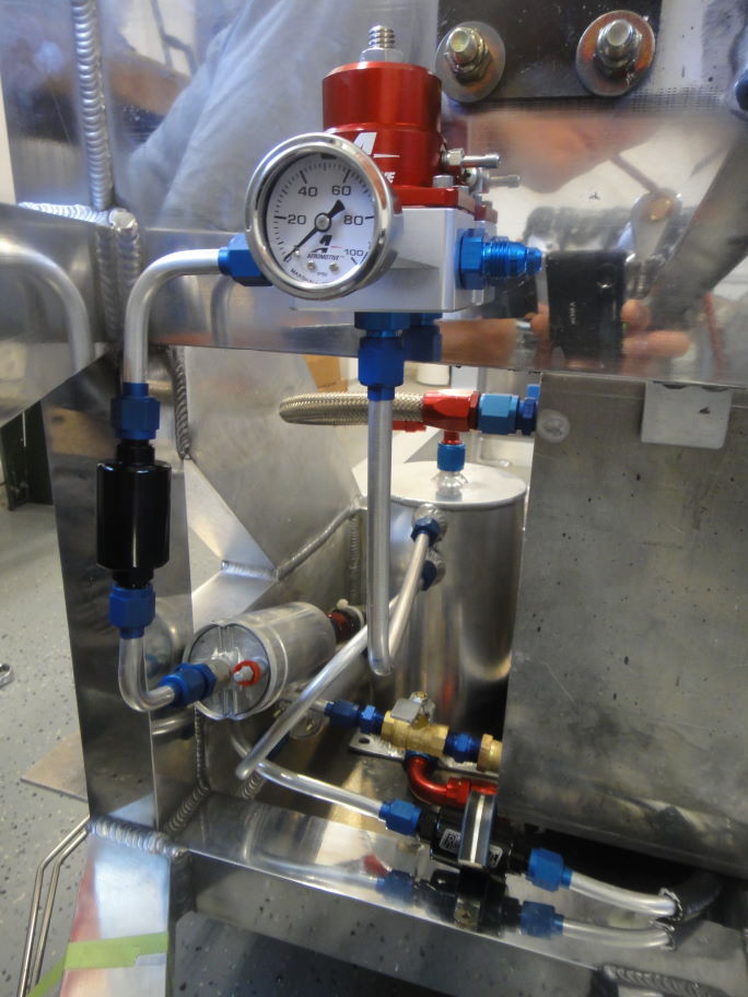

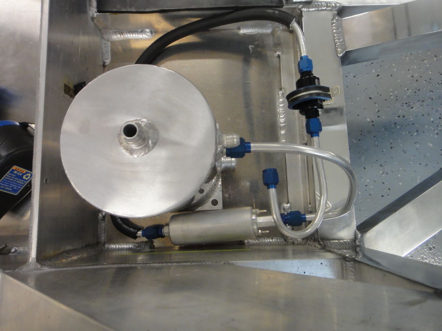

I wanted to keep the installation compact and preferably entirely in the space beside the fuel tank, behind the driver. At the same time, the fuel filters needed to be relatively accessible for cleaning/changing. In this installation, everything can be accessed from the engine side of the car, although some disassembly of lines is required in order to get the fuel pumps out.
I haven't hard mounted anything yet, in case I find that I messed something up. Also, the parking brake cables might route through this area, so until it is clear where the cables will run, I want to keep the components movable.

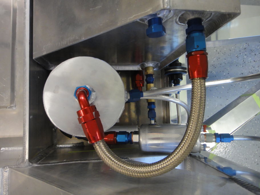

In some cases because of either a required bend radius that was too tight for the bending tool or aluminum tube size, I used stainless steel braid rubber hose (Aeroquip AQP). The nice thing about flexible lines is that you can get special hose ends that have angles already incorporated into them. Some people prefer using the teflon style hose, as the rubber hose only lasts 8-10 years or so. However, some people have concerns about the teflon hose, which has an unlimited life, but which can develop pinholes due to static buildup caused by fuel flowing through the non-conductive hose (the static arcs through the sidewalls of the hose to the steel braid outside). It is possible to get conductive teflon hose, but I don't know much about those and so just stuck to rubber. I may change these to teflon when the time comes, although that will require getting hose ends as well (the fitting are not interchangeable between rubber and teflon hoses). Flexible hose is sold in "AN" sizes just like aluminum, although in this case, the "AN" designation refers to the equivalent inside diameter aluminum line; the rubber and teflon lines will be a larger outside diameter than the equivalent aluminum tube. In other words, an AN6 rubber line can be connected to an AN6 aluminum tube and they both have the same inside diameter, but the aluminum will have a smaller outside diameter.

Starting with the fuel tank and moving downstream, the components used on my installation are:
- Finger Strainer (large): ACS $18.90 https://www.aircraftspruce.com/catalog/appages/fingstrainers.php
- Nipple AN911-3D: ACS $4.70 https://www.aircraftspruce.com/catalog/hapages/an911.php
- Valve: ACS $19.65 https://www.aircraftspruce.com/catalog/appages/minifv.php
- Fuel Filter #1 RUS-650133 Summit Racing $24.97 http://www.summitracing.com/parts/rus-650133/overview/
- Fuel Pump #1 Walbro GSL 392 Ebay $82
- Surge Tank CX Racing Ebay $75 Cxracing Universal Aluminum Fuel Surge Tank Nissan 300zx MR2 S14 | eBay
- Fuel Pump #2 (high pressure) Bosch 044 Ebay $184.44
- Fuel Filter #2 (same as Fuel Filter #1)
- Fuel Regulator Aeromotive A1000-6 Summit Racing $152.97 http://www.summitracing.com/parts/aei-13109/overview/
Both of the fuel pumps have metric threads, which requires an adapter fitting to connect to an AN line. The Bosch required one of these: http://www.summitracing.com/parts/rus-670510/overview/ and one of these: http://www.summitracing.com/parts/aer-fbm2245/overview/
The Walbro pump required two of these (one for each end): http://www.summitracing.com/parts/fra-491961/overview/
Also, the fuel pressure regulator requires o-ring fittings (3 of them) like these: http://www.summitracing.com/parts/sum-220166/overview/. A fuel pressure gauge is connected directly to the regulator: http://www.summitracing.com/parts/aei-15633/overview/

The flexible lines are from the top of the surge tank to the main tank (the overflow) and from the bottom of the surge tank to the high pressure fuel pump. In both cases, a 90 degree hose end was used to help make a tight turn. The bottom of the tank is AN10 and required this fitting: http://www.summitracing.com/parts/aer-fbm4034/overview/ and the top (overflow) of the tank is AN8 and required this fitting: http://www.summitracing.com/parts/aer-fbm4033/overview/
Two of the lines (the line from the first filter to the first fuel pump and the line from the bottom of the surge tank to the second fuel pump) route in the space underneath the main fuel tank. In order to prevent them from chafing on each other or the aluminum tank or body, they were wrapped with some old radiator hose, cut up the middle and secured with zip ties.
