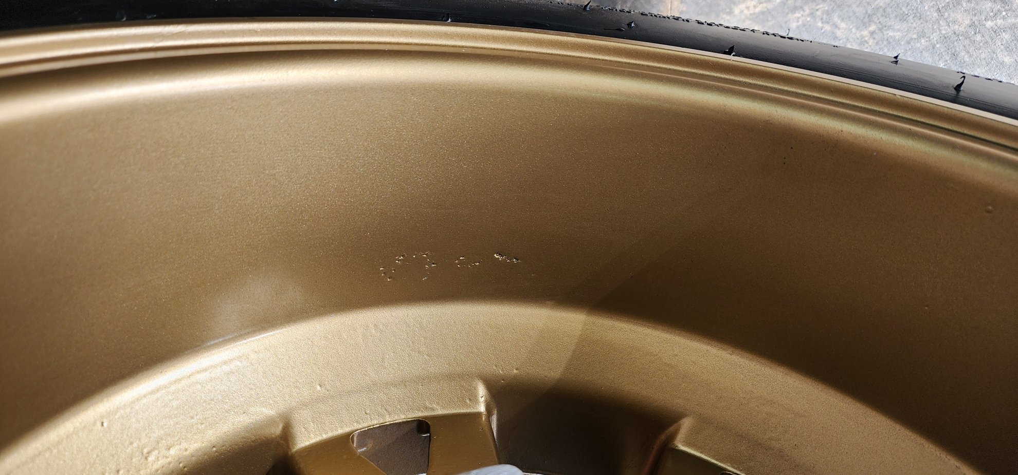

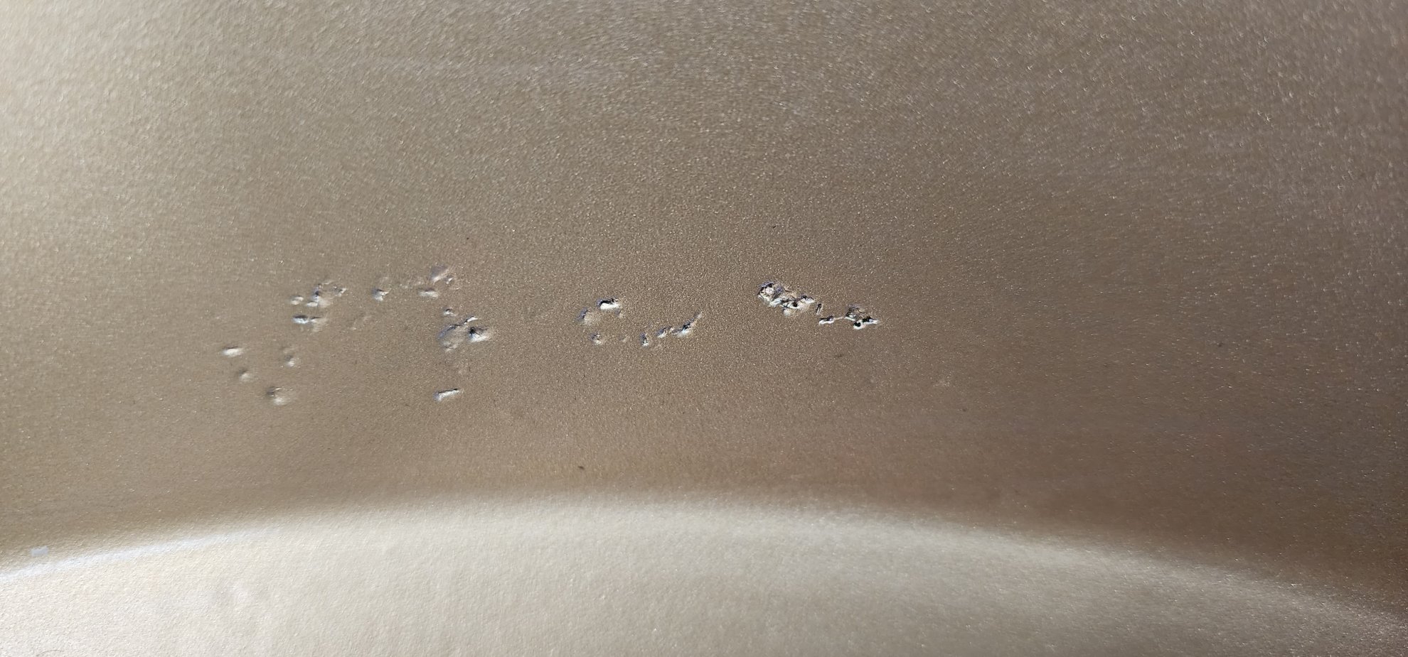

Leonard L Supporter May 28, 2024 #1 Have had two SPF Halibrand style wheels leaking air through pourous pin holes. Is this common with these wheels? Attachments 20240528_175630.jpg 341.1 KB · Views: 97 20240528_175614.jpg 326.3 KB · Views: 96
E scott Jul 21, 2024 #2 Yes, poor casting quality from motoworx in south africa. The wheels can be impregnated with a sealer to plug the porosity holes, look for a casting impregnation company. www.godfreywing.com www.anoplate.com
