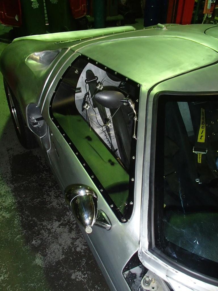

I found if you tape up a border on the underside of the cover about the width of the flange it lives on in the body, sand it with 280 wet and dry, then paint the border (on the underside) with black acrylic lacquer.
It looks good an hides the sealer line.
I don't have a pic of covers but windows are the same.
Most just use s/steel screws, it is plastic.
My body is aluminium, I used screw grommet blocks you need to file a square hole then they push in.
If you strip it pop it out and push in a new one.
Use the ones with a flush flange.
