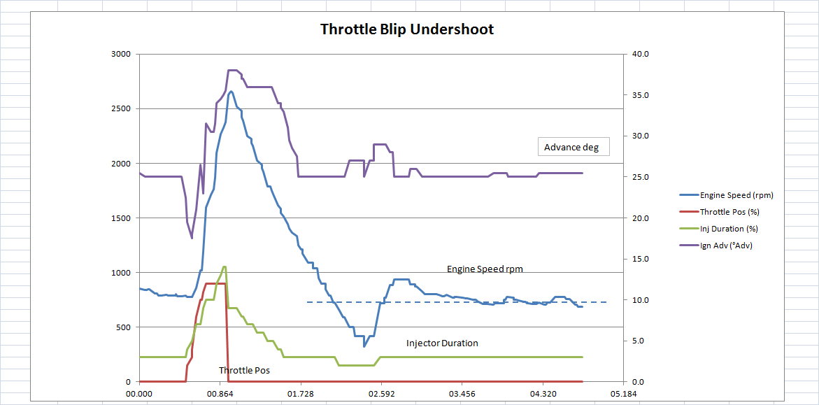

Update. I have today balanced the TB vacuum as well as I can 5 4 3 5 4 4 4 4. Increased advance around the tickover speed, set injector map settings so that it idles well open loop, but still the undershoot. A chart from the data log shows the effect clearly, engine rpm dipping to nearly 400rpm before overshooting to 900rpm before settling to the tickover around 750. Needs a little damping one way or another. I want to fix it as it's the only thing stopping me from taking the car to Goodwood. Any ideas guys?

FRom a control loop standpoint that overshoot implies too much gain/too little phase margin in your control system. If it was an alalog control I could help you but digital.... no way.
Dave Bilyk
Dave Bilyk
With you all the way Neil , been wondering how on earth I can reduce the gain. At first I thought the throttle snaps shut very quickly, but it's so much faster than the engine response that it wouldnt be the driver for this. I am currently checking for slop in the spindle connection in the throttle body pairs.
