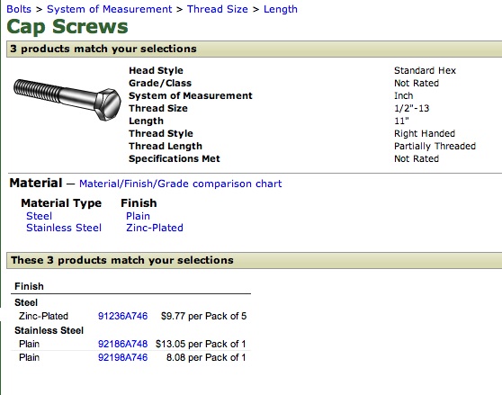

Hi John,
McMaster-Carr. I'm not familiar with how your fasteners are loaded/stressed, but these are probably better than the home depot threaded rod. 92198A746 (18-8) is lists a minimum tensile strength of 70,000psi. The more expensive 316 version should be stronger (tensile strength wise) but this spec is not listed in the data sheet.
Al

John Ross,
You really need to make sure you have Grade 8. I got mine from a local fastener store. While you might find them at Ace, you'll pay way to much for them there. If you can't find a local fastener supply, then go online, but don't put less than Grade 8 in there!
Lynn
WOW thats exactly what i was looking for. I searched the web with no luck and now that you post that link I find there is a Fastenal only 30 minutes from my house. I'm gonna try and head out there for lunch tomorrow if they have it in stock.
