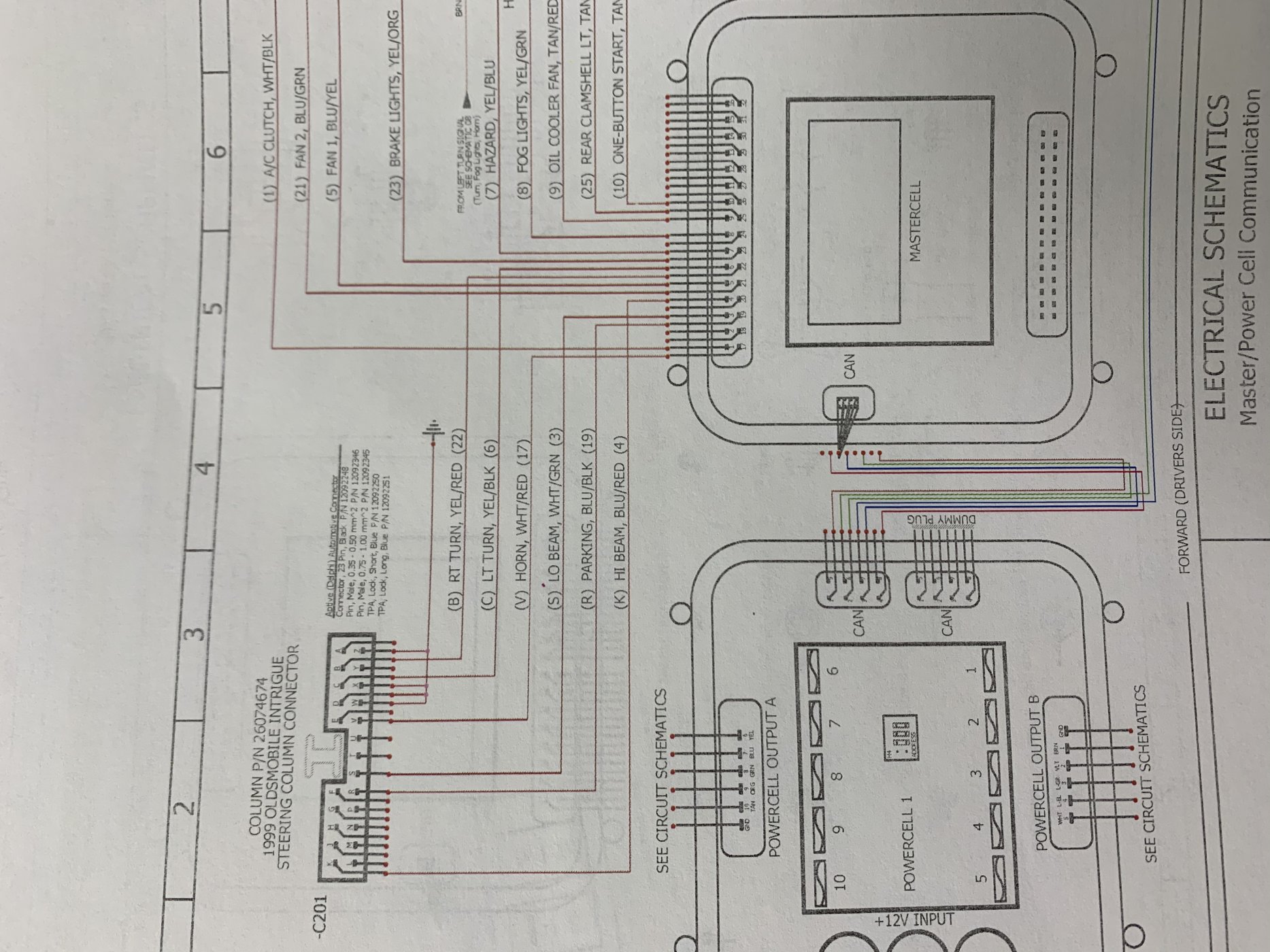

So my SLC is in the wiring stage. Having difficulty sorting the GM column and the coach controls integration. Here is the schematic for the GM column.
Here’s what I know.

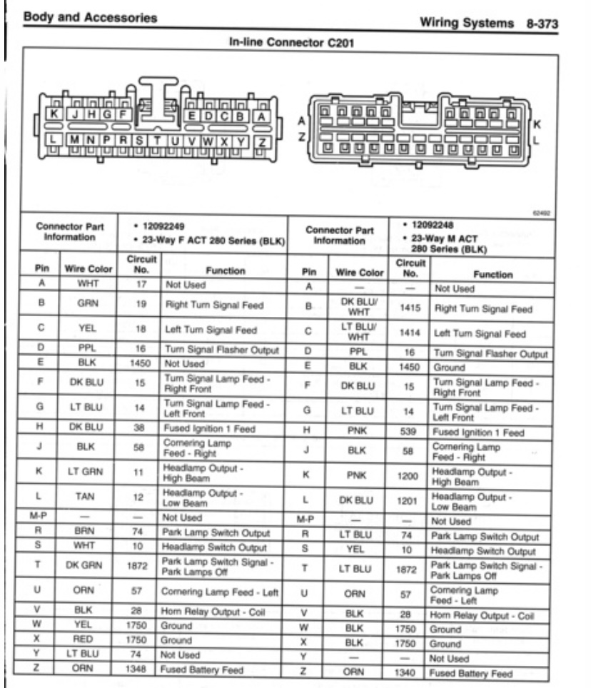

12V IN to #18 and 19 for the turn signal feed, this 12v is supplied from the coach system which has a built in flasher relay. Which then allows the stalk to give 12v OUT to #15 & 14 which turns on each respective turn signal. I’ve confirmed this works, HOWEVER, the flash seems slow and not very bright. This could be normal, not sure.
The horn is ground input which works just fine.
EDIT.....what I still need to figure out is where to run the 12v supply to the GM column for the headlights, and then from there which pin out supplies the high and low beam. The schematic labeling is confusing.

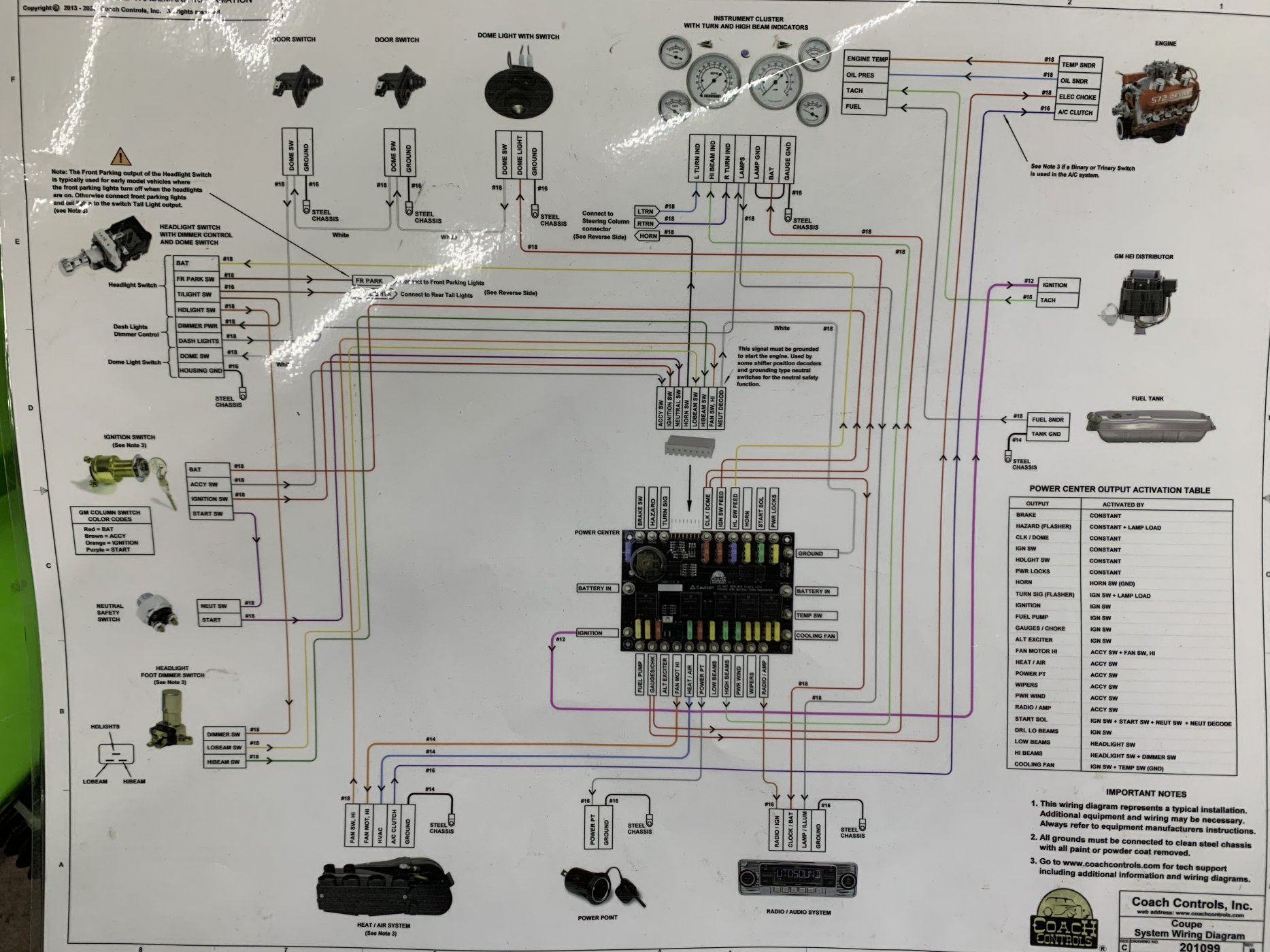

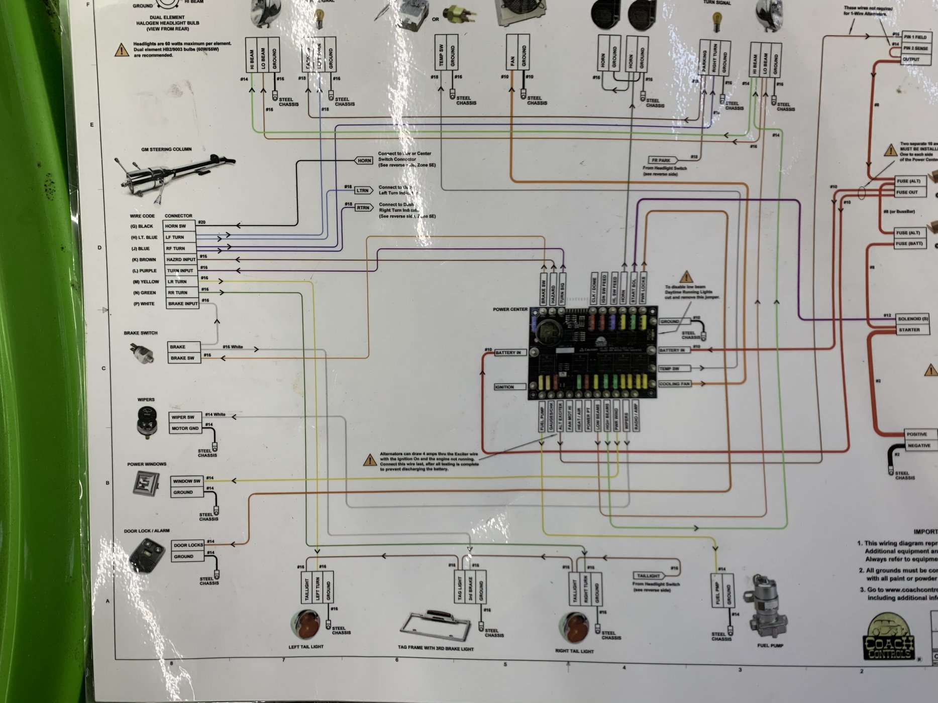

Here are the schematics for the coach system.
I have all the ignition working via a start/stop touch button.

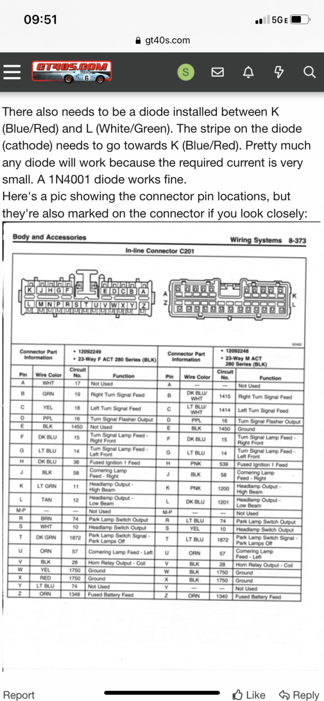

Ive added a diagram from I believe Kurtiss GTR thread.
