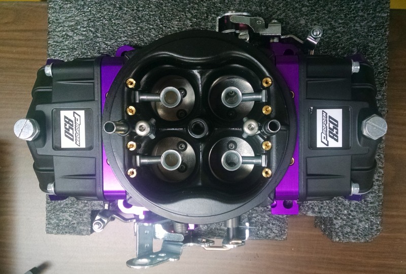

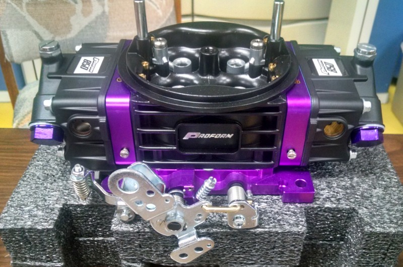

If you get tired of fooling around with dribbling gas on to your engine trying to adjust the Holley float level, buy a Proform or Holley Ultra. They have glass sight plugs that show the fuel level inside the bowl.
Love the look of that carb and such a logical improvement
