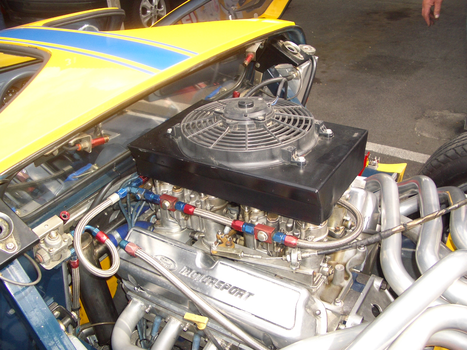

Fit phenolic spacers. Aluminium is a very good conductor of heat. You need a heat insulator between the hot manifold and carbs.
e.g.
A 9 hole top vent will help to allow heat to escape when stationary.
Ceramic coating of the exhaust pipes will help with under clip temperatures.
A turkey pan will help to deflect convected exhaust heat away from the carbs.
