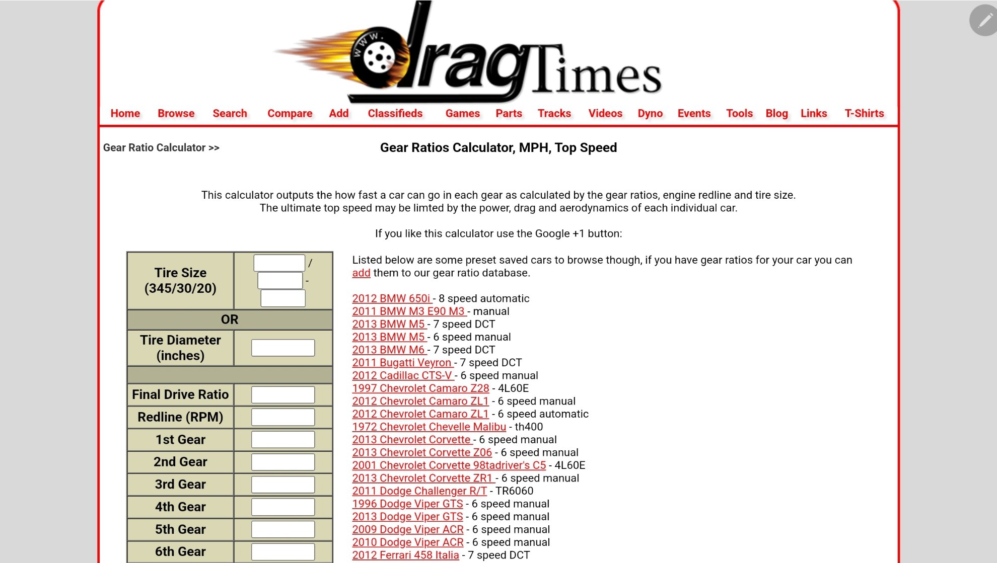

How is the actual Gearing by gear calculated: Effective to transfer to final. Is there a calculator somwhere with each part of the gearing process?
The diameter of the rear tires on the GT-40 I will be using are 705.5mm diameter. 15 x 295/55 so I am wondering if you could help by pointing me at a calculator, or spreadsheet that allows the conversion of the L140 box to real speeds using the drop gear and final gearing ratios as I appear to missing something pretty basic in my understanding.
