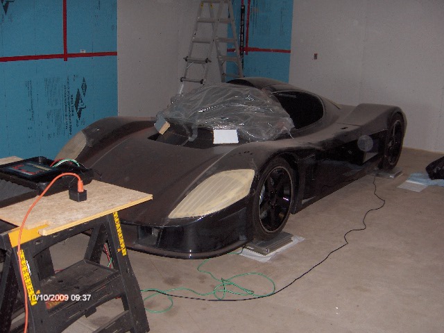

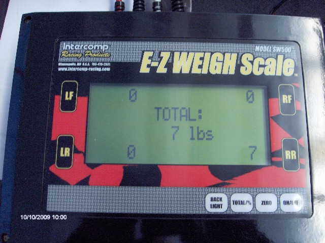

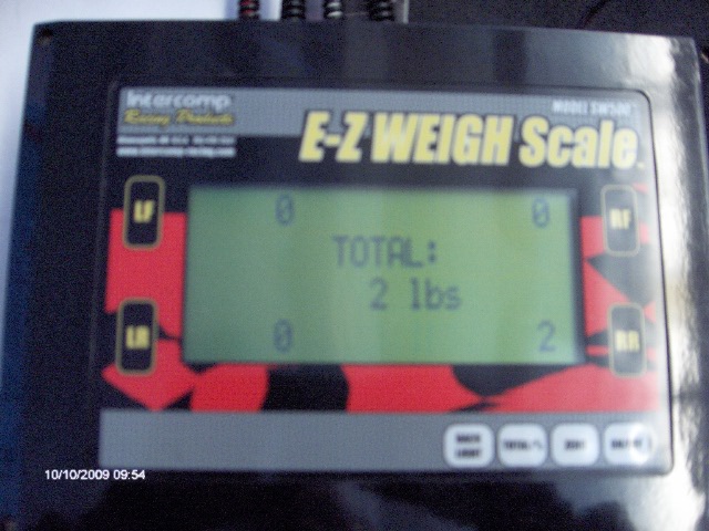

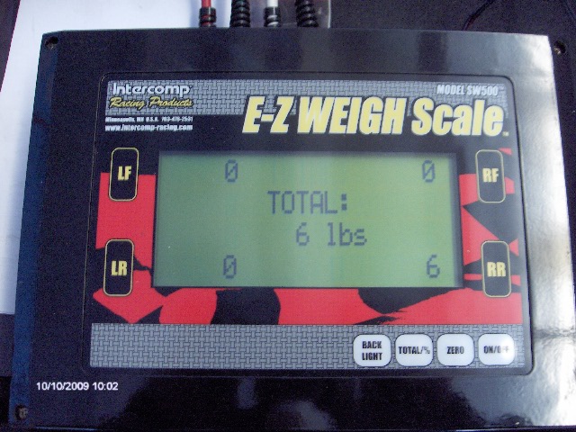

Pretty darn light! I borrowed a friend's Intercomp SW 500 scales this weekend. The scales have an accuracy of +/- .1% of applied load or +/- one pound which is the scale graduation, whichever is greater. So, the larger weights are pretty accurate - the small pieces not so much, but at least it is close.
I started by weighing the rolling chassis - this includes the chassis, all body panels, suspension, brakes (less the front calipers), stock wheels (Corvette), tires, radiator, pre-formed brake lines, fuel tank, steering, windshield and rear deck Lexan. Note that the body openings for the engine cover and windshield have not been cut out. So, there is a little extra weight but not much. See the photos below.

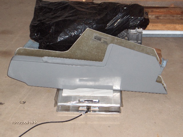

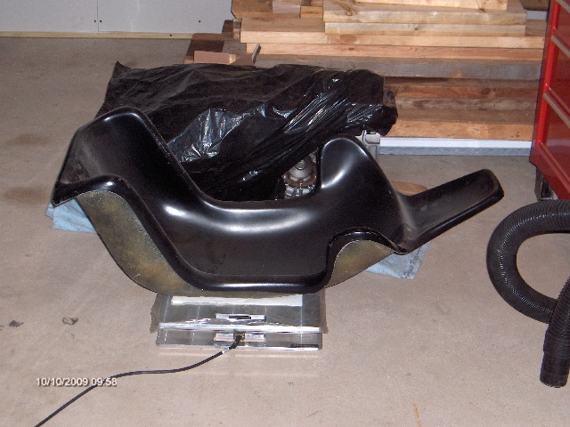

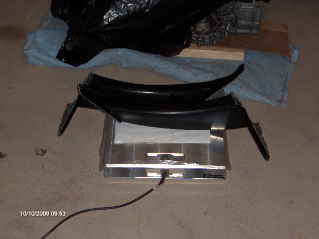

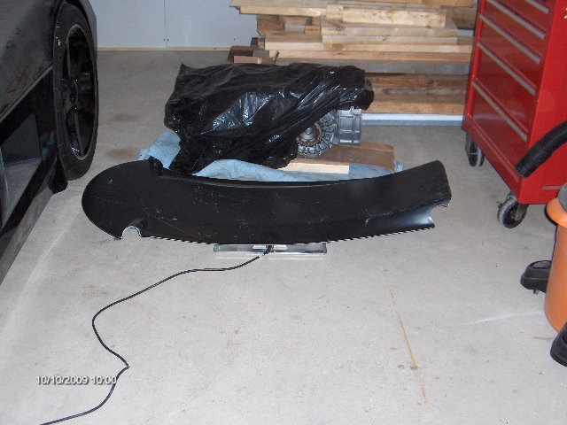

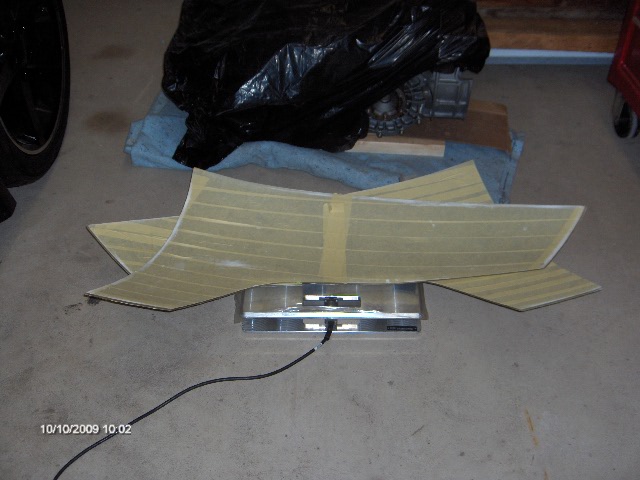

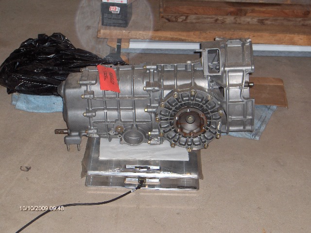

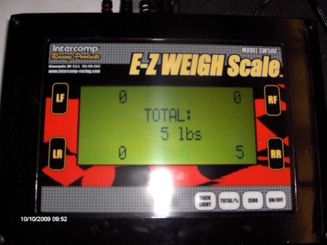

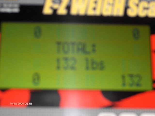

I then measured the G50 gearbox (dry), inner door panel, A-pillar covers, center console, stock seat, headliner panel, and side windows (both sides, 2-piece, no hardware).
Obviously, there is going to be some variation in weight from car to car. I've weighed out a bunch of the smaller component parts on a more sensitive digital scale and I can post those weights too if folks are interested. My goal is to eventually weigh almost all of the component parts and of course, the completed car (though that may take a little longer!).
