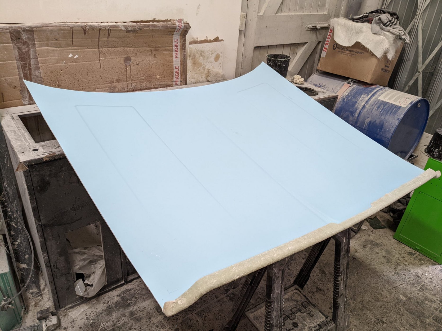

I am a mechanic by trade, and I have been working closely with a Fibreglass specialist who have recently built a Fibreglass bonnet mould from scratch, whilst documenting the process along the way.
Although this is for a 1965 Dodge Dart, hopefully you can appreciate the method rather than the make and model :)
I thought it was such a useful article, it prompted me to share it on here. This forum doesn't let me posts all of it, so I will put the contents up and you can read the full article here.

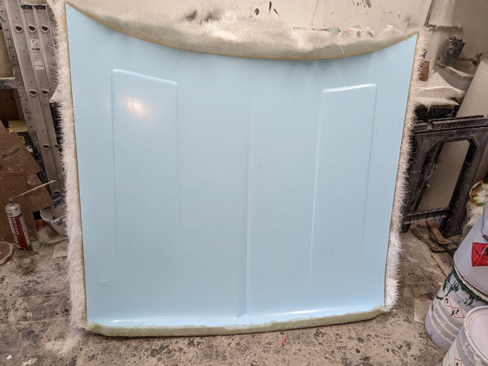

Read this article ; all basics are welll reminded but .......;
There is something strange writed on the gelcoat procees to do ; :oops:
  • Once cured, sand down the surface and remove any imperfections ready to lay up the first layer of fibreglass.
In any case don't do that!!!!!!! gelcoat need to cure and stay tacky and then you start laminating o_O
It's strange to read this phrase because below you can read read another expalanation ????? so probably some wrinting mistake ????
But have to be corrected because people doing that sand onto the gel will destroy all the work and maybe damage the mold or the plug !!!!
Jusst my 2 cents;)

Hi Michel,
just reading this back, and you are right, there isn't any need to rub it down, I am not sure what has happened, here, I think I have my wires crossed somewhere when editing this section.
Thanks for pointing this out, I will make sure I update it :rolleyes:!!

:rolleyes: May I add some "tricks " to help beginners not to go on some little issues ;
1// To be sure that the gelcoat will not be melted with the first lay of resin ; it's advisable once the first lay of gel is cured to paint another thin lay of similar gelcoat and let it cure . this prevent absolutly to get those bad small "freezed " areas sometime a mold (or a part) can get
2/ Before the first strand mat is layed on edges , to help this stuff to conform sharp edges or corners it is advisable to lay some resin added with aerosil white compound ( like a yogourt paste ) on every area where it seems difficult for the strand matt to conform edges ; when done lay immediatly the clothes and roll with caution with a bubble roller using it from center to external lines to pusch out any air trapped
3/ When using steel or wood rinforces place some cardboard strips ( or better some special "feltrine " stripes) in beetween faces of the rinforce and the mold surface where they joint . this prevent those rinforces some weeks after to sort of print a "shadow" or a"swallow" thru the thickness of the mold
into the gelcoat aspect and will ruin all the work , as this shadow will appear also ont the parts !!
Hope this helps ;)
