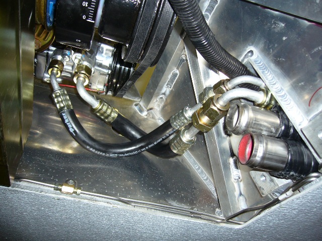

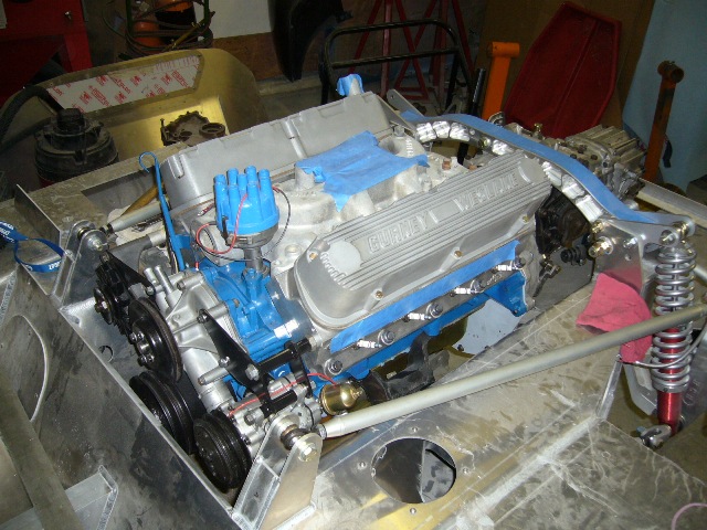

Hey Bill,
Here are a couple pics of mine. (1 top and 1 bottom view)
IMHO you will never get a 508 to package. Or...rather if you do, you are a better engineer than I am.
