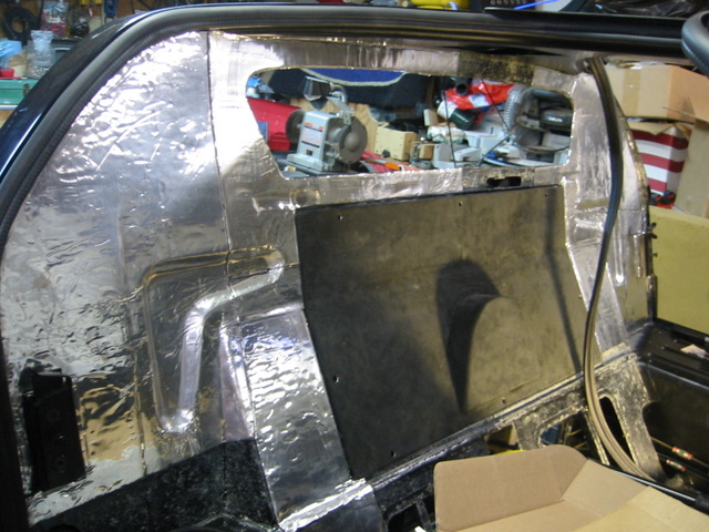

Sorry, I meant the carpet, I removed it to insulate so I need a replacement
i take it u cant re use the stuff you took off?
also, did u heat shield the other side of the firewall? its probably easier just doing the other side...
(im just thinking out loud here)
I spent many hours debating with myself on which side to do. In the end I thought it would be easier to hide and look much better if I did the inside although it will be much harder to do. It just wouldn’t look right on the engine side. Because I didn’t want to change the “look” of the large access panel I have figured out a way of doing its engine side but have worked out a way of hiding it.
I did find something interesting, the window between you and the engine is about 1/16” thick. I plan on making a ½” or so Lexan replacement. It should work in the existing frame so I’m asking if anyone would be interested in one. The number of orders I get will determine the price.
As hard as I tried to save it the old carpet is not reusable.

im with you. im making my car as streetable as it can be without losing its character. we were going to dynamat the engine side, but you bring up a good point abt the looks. however you wont see much dynamat exposed on the engine side because, well, the engine is in the way but i know what youre saying.
we are literally going over every nut and bolt on this car and preparing it so its done right the first time, and it is built with the idea that we want it to be easily maintenanced in the future.
btw, i believe olthoff sells a thicker "glass" or someone on the board does. i know ive seen them.
a good way to look for cracks that water can get in is to hoist the car up on a lift or jacks, then turn the lights out. with someone inside the car, have someone else crawl around underneath it with a worklamp. when the guy inside sees a chink of light, there is your gap.
not sure how to seal up the vent that is in the roof though...:)
btw...unless you plug up the service holes at the bottom of the firewall, u can dynamat all u want and itll do no good. the cabin will create a vaccuum thatll suck the engine heat right through.
thats where the bulk of the interior heat will be coming from.
the holes that the hoses and such are running through, u need to plug and insulate them as best you can.

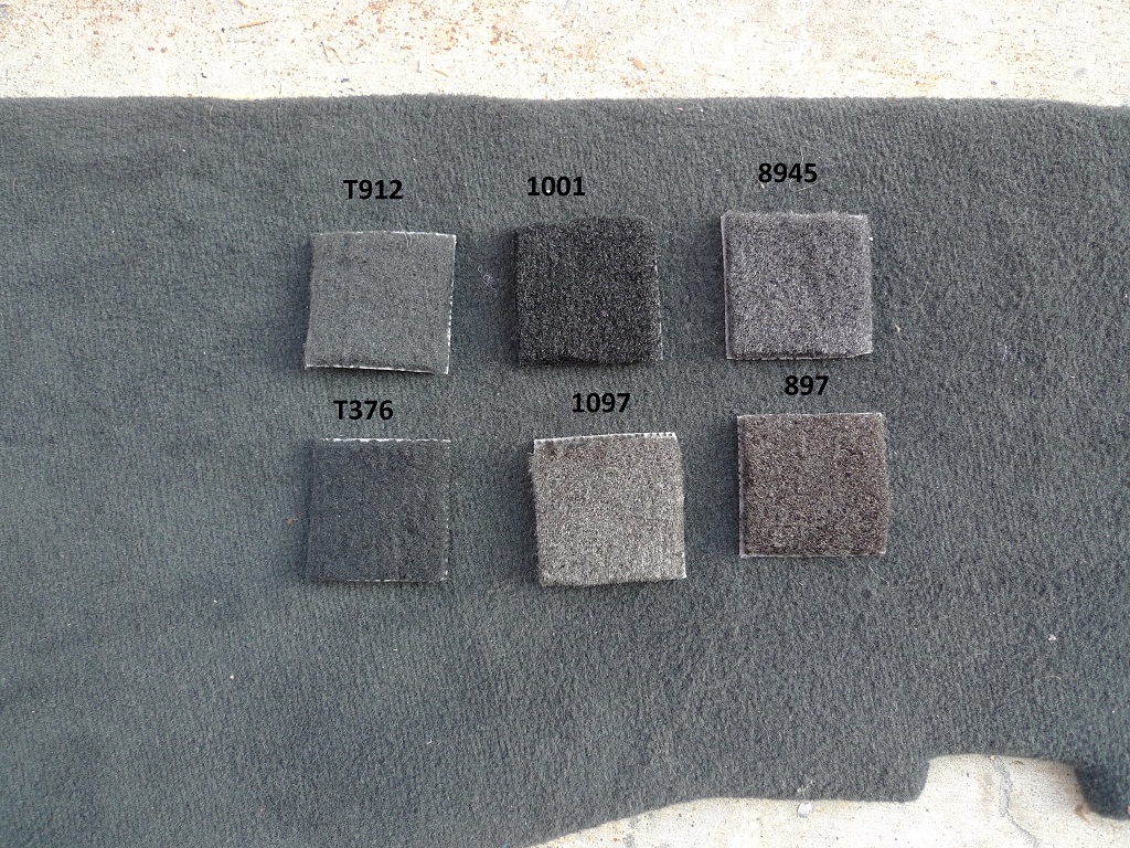

I need some matching carpet so I ordered all the grey samples I could find from Auto Carpet for Car, Truck, Van - Stock Interiors to see which one came closest to the carpet in P2160. Below are pictures of the samples lying on my passenger carpet. The first picture is taken in the late afternoon shadow, and the second with the flash turned on.
The two samples with label Txxx are called "Truvette" and apparently correspond to carpets used in Corvettes from the late 90s. They are different from the other four in that their fibers are less shiny and in that sense match the fibers of the Superformance carpet. The other samples sparkle in a way that I find cheap looking, although from a distance it might just slightly lighten the colors. This effect is more obvious in the first picture.
Truvette is $59 per 72" wide yard at http://qualitycarinterior.com/view-by-product-yardage.html.
Also, BTW camera is on autoexposure so everything is lighter than it would appear by eye.
