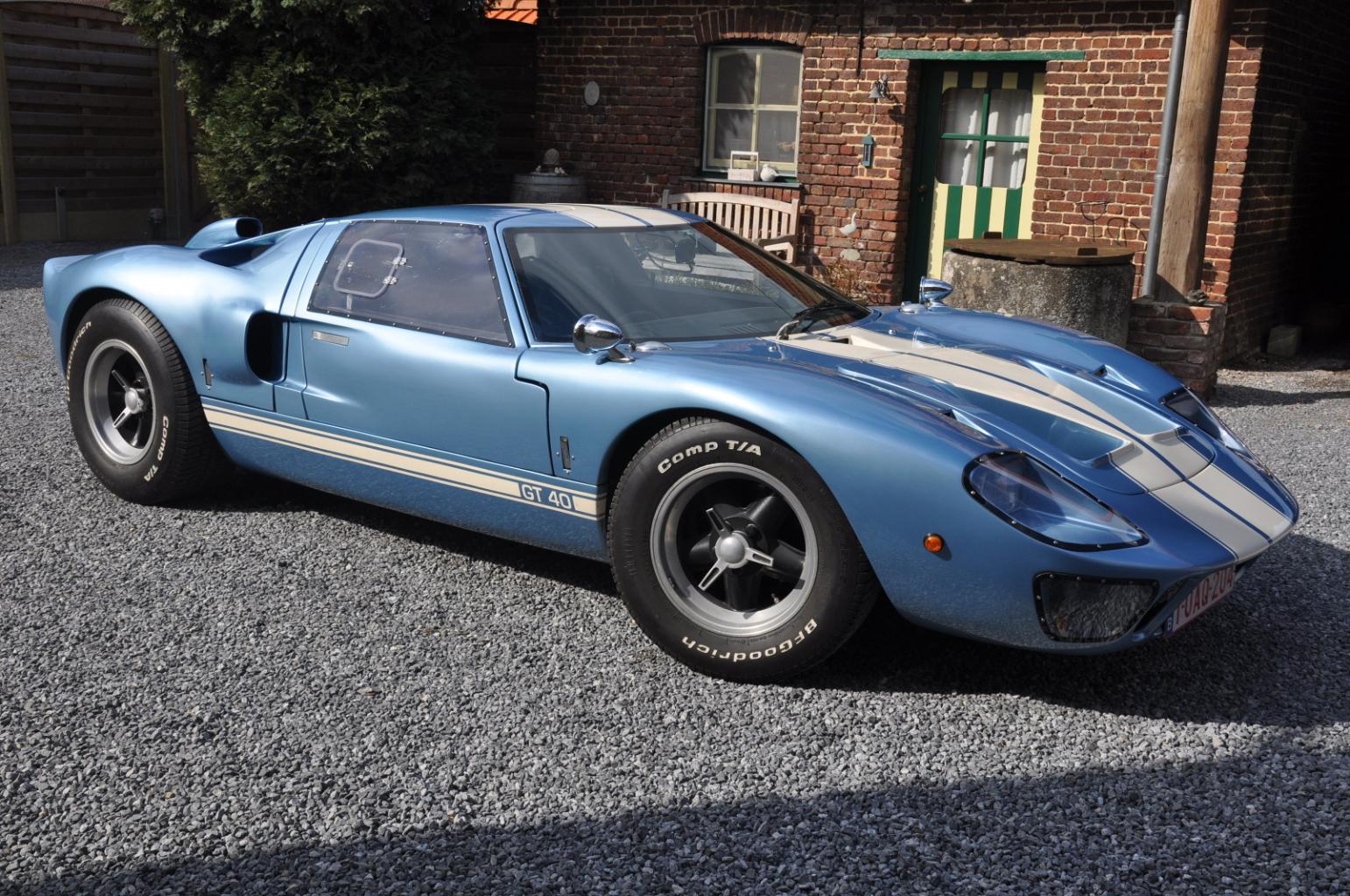

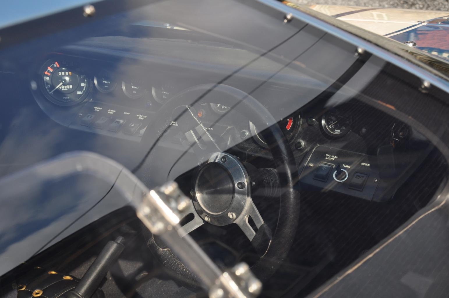

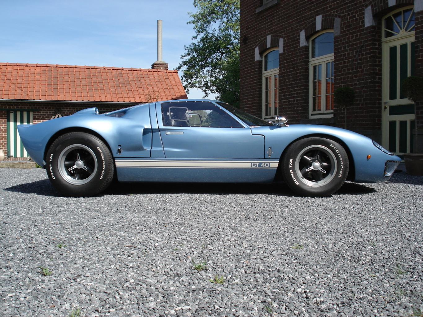

Hello to all,
First a big "thank you" to the moderators to make this forum alive!!
I'm a happy owner of a GTD 40 for quite some time.
It's a quite standard GTD40 with the usual components and even with a Rover V8.
Nevertheless a nicely tuned example with quad dellorto's on top..
The car has aged well and has a nice patina which I want to keep. It is an oldtimer anyway.
After buying the car I did quite some changes + restoration way back in the nineties to make the car usable on the road.
New cooling system, oilcooler, new interior, some engine work, electrical work has been done and extensive cosmetic changes.
But after that I basically kept it running and enjoyed it.
But now after other project, car/none car, I decided to upgrade the car step by step. I want to keep it a running restoration.
A new paint job has been done already some years ago.
So here are my steps:
1- Upgrading the brakes -> still Granada/scorpio
2- New tires -> now old BFg's
3- New suspension
4- New Engine
5- ...
So I hope to get some help here and also give some of my experience to others.....
Herewith some pics of the car:

Very nice car, love the color combo... Welcome ! I also have an early GTD, under endless process of slow upgrading/restoration, interrupted by (short) periods for enjoying it ! (Presently in the body shop for a full respray after being hit on a track...)
A little pic under the rear clip ? Just curious about the Dellorto setup...

Pierre, thanks, colours are Wimbledon white and Shelby Brittany blue. It seems you are in the same stage as me.

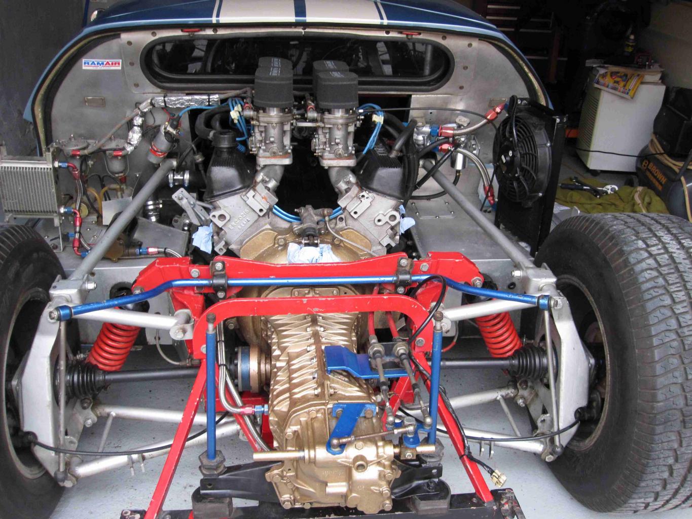

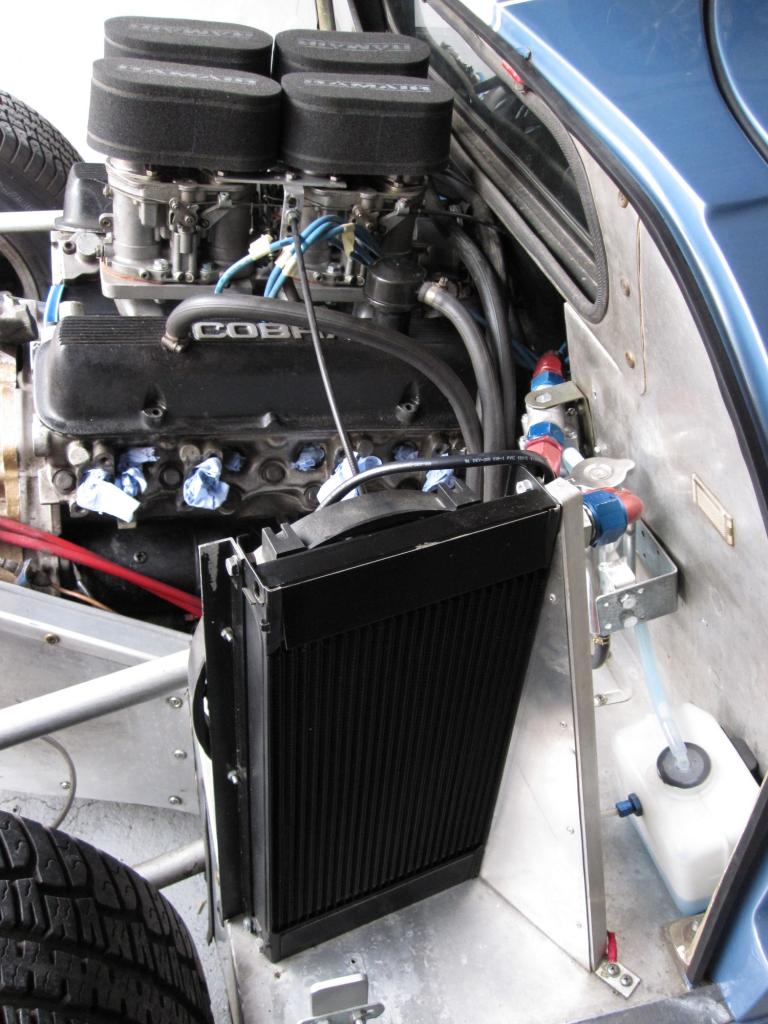

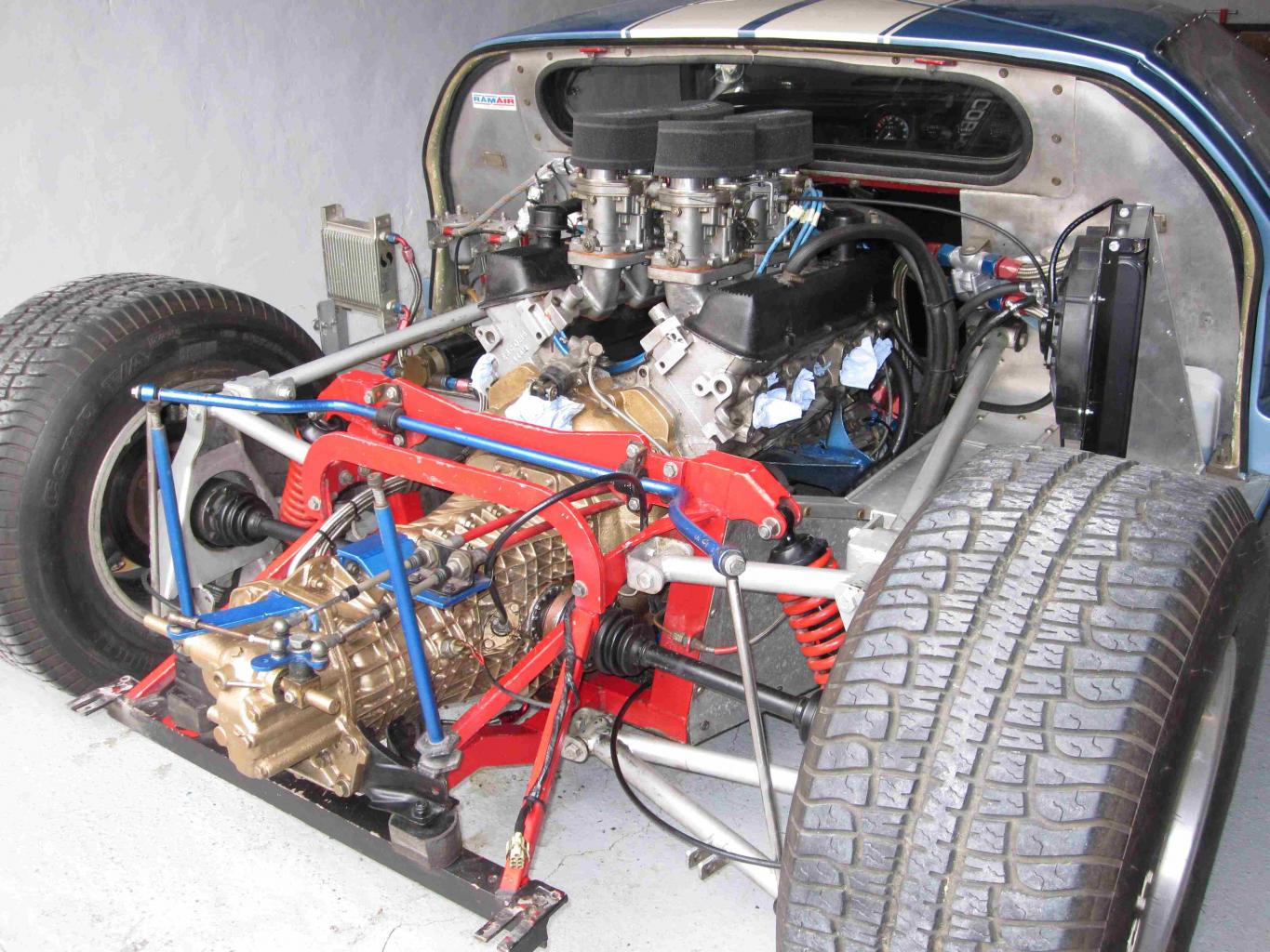

Some more specs:
-Wheels 15" wheels 7" front 10" rear : Revolution 1 piece.
-Avo shocks steel one way adjustable.
-Tires BF'g comp ta 215-65r15 and 275-60r15 (at that time the only size available)
-Engine rover V8 3.9L. Tuned race cam 4W Dellorto's 45. Sidewinder sump
-Clutch no idea?
-High energy coil electronic ignition
-Rev limiter from Lumenition
-Gearbox: Renault 30
-2X Facet gold fuel pumps
-2X Filter king regulators
-Mocal oil cooler for gearbox + electric pump
-Setrab oil cooler for engine
-Mocal thermostat on oilcooler
-brakes Granada MK2 front, MK3 rear (I guess)
-exhaust 2X magnaflow
I will make some pictures later on...
Here are some pics of the internals: Exhaust is out for some change to fit my new mufflers..
regards Curt
