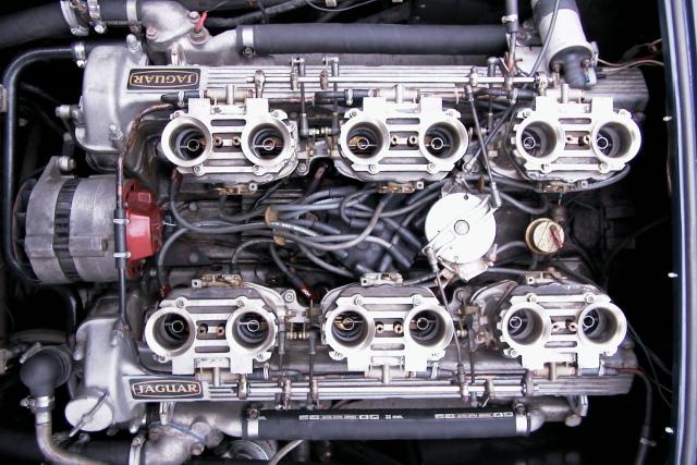

Dennis,
Was that one prepared on the old 5.3L motor or on a 6.0L motor? I just didn't get a 5.3L because so many that I found were going to need immediate rebuild and were franky, in nasty condition. So, a running 6.0L in nice shape seemed to be a better answer. I can sell all the stuff I don't need off of it and get it down to a long block that should accept webers etc. for the XJ13. In fact, the head castings on the late model 6.0L has fantastic ports - they look better than the early 5.3L motors for sure.
Ron

Ron at the moment this is a completely stock 1994 5.3 motor and it will stay that way until the car is sorted and registered the carbs are 40 IDE and are off another XJ13 built over here (all aluminium body)the owner wants about 400000AUD for it yes thats 400 K Regards

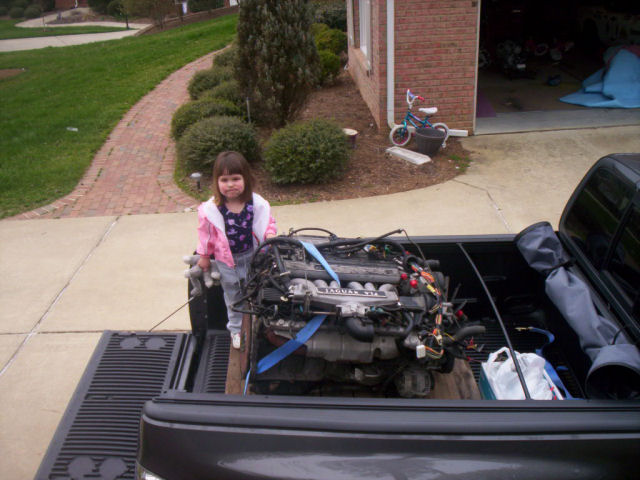

Well, I have a big Jag V12 in the back of my truck now, looks great! I'll have to post a picture here shortly. I'll be bundling it up for about a year before starting on the XJ13, but I hope then that the market for those will be developed and a few of them will be out there with builders.

This project is long term to lower cost so I'm searching for a gearbox and will get it if the time is right. This V12 was only $1200 with all running gear, everything intact, and the engine ran up until a month ago when it was pulled. So, it shouldn't need a rebuild. I plan to just pull all the electronic crap and accesories off and sell them probably getting the cost of the engine to around $600. Then I plan to pull the heads, deck them for a 10:1 compression and put a weber intake on top (got to check clearnaces on this issue). Don't plan to do anything else except for a nice exhaust system and I'm told it'll net about 375hp in this configuration with no stress on the motor - good for track work! The late model motors such as this one have forged internals so that is a bonus.

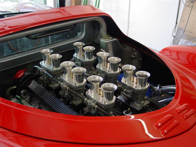

Early ?? V12 with Dellorto's ?? - either way - very nice. Was competing against us at Loton Park in a Dax Cobra - sounded superb!!
