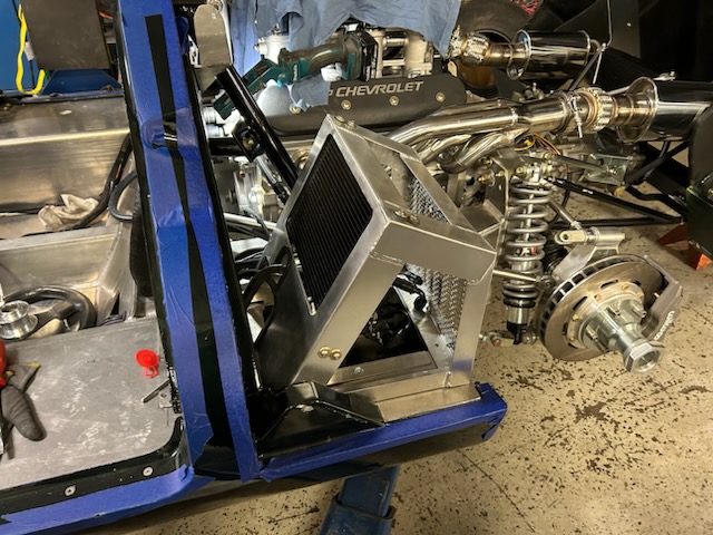

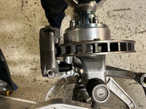

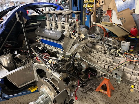

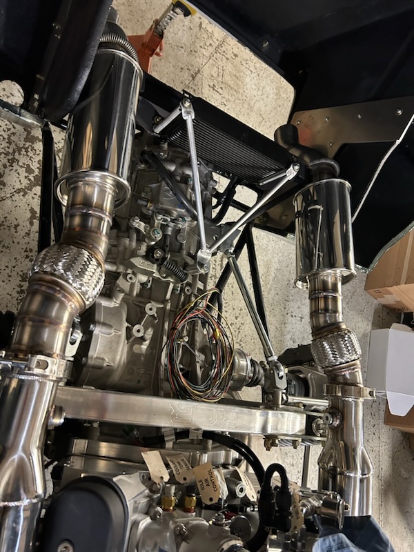

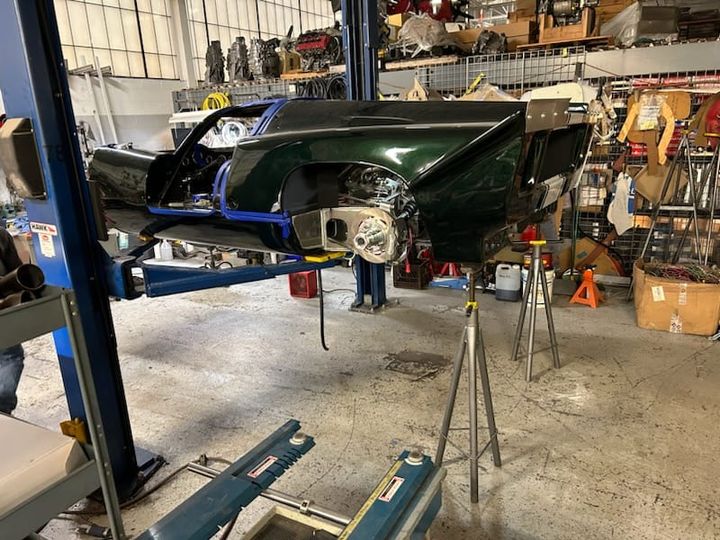

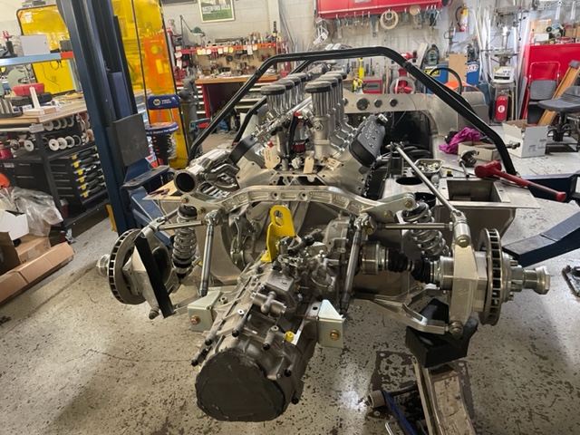

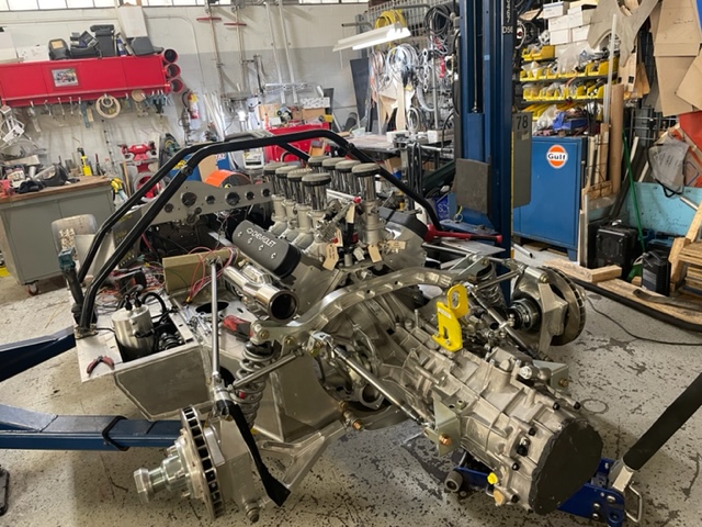

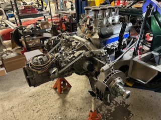

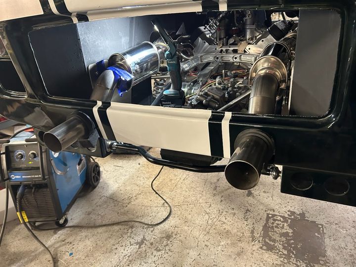

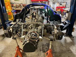

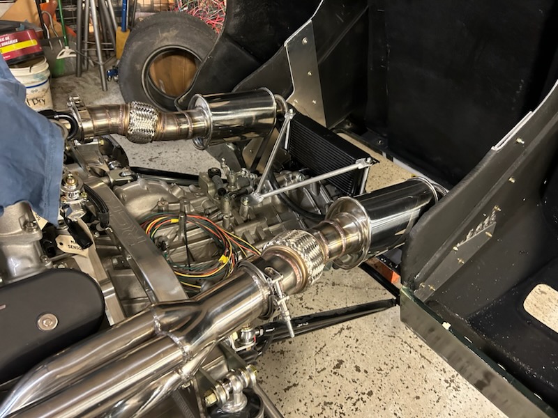

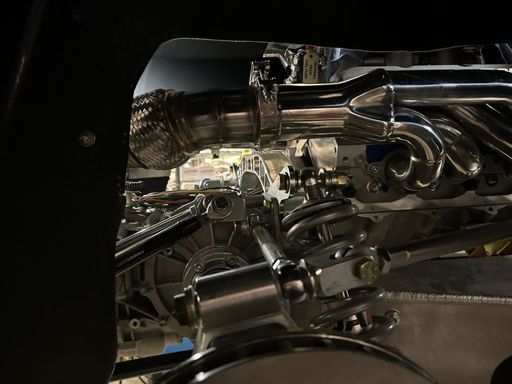

Got some progress pics from Fran:)
Brian Kissel
Won’t be long now. Beautiful T70 will be heading your way soon. Looking forward to more pictures when you get it home.
Regards Brian
Jim Albright

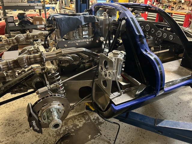

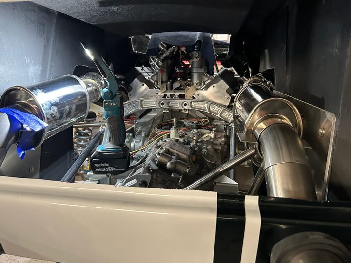

Looks great Jim! What dry sump system are you using and what size dry sump tank is in that system?
Unless Fran is planning a surprise change, it's a wet sump - are you referring to the tank on the passenger (left) side? That's the fuel surge tank.
Best Regards,
Jim
