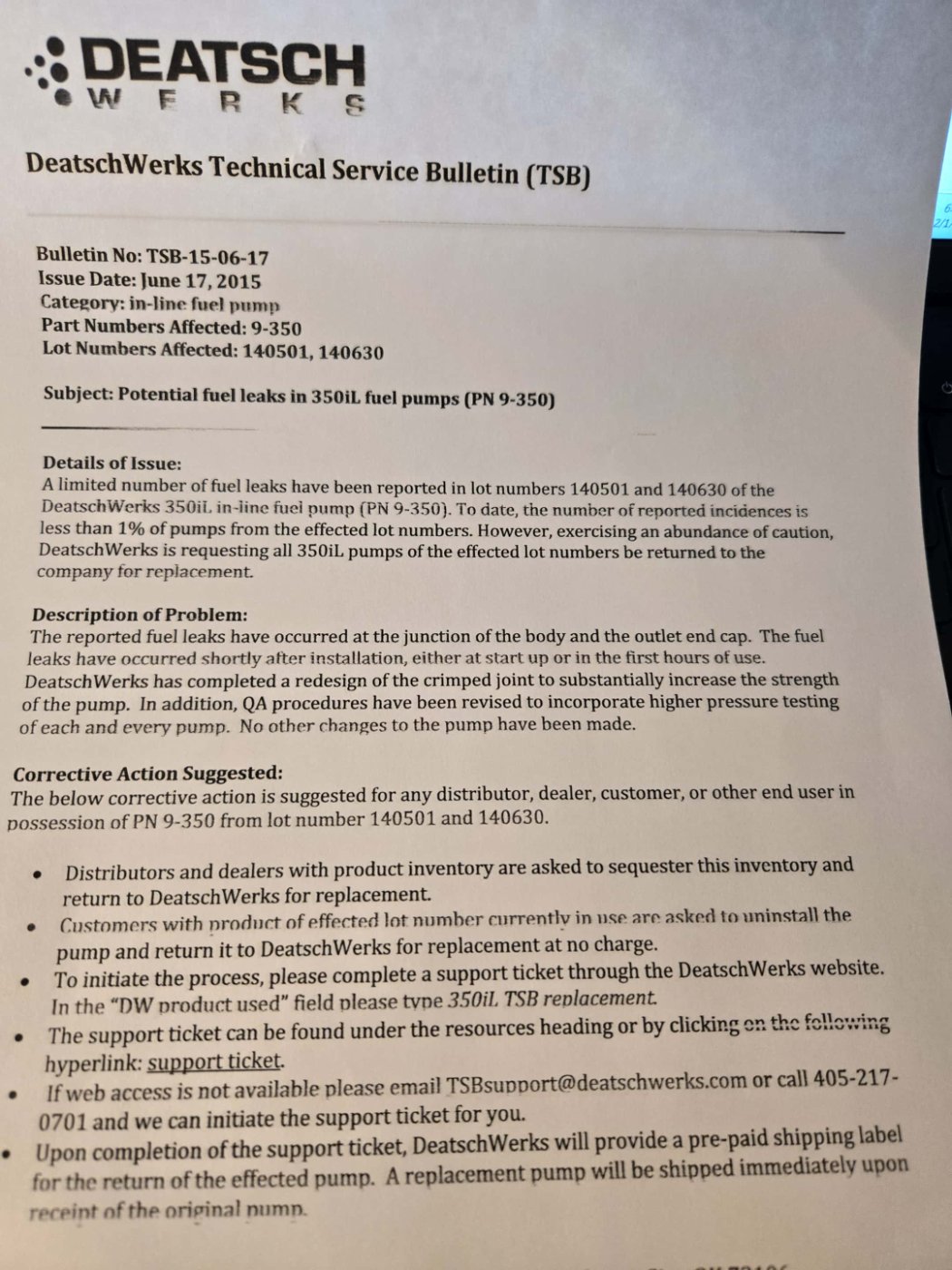

Anyone else experienced an inline fuel pump failure where it started spraying fuel from the discharge end of the pump housing? I was driving to a car show 2 miles from home and when I arrived, folks started waving their arms and shouting "shut if off - it's puking fuel" I shut it off and immediately smelled gas. Got out and a large puddle formed under the drivers' side. It continued to piss fuel for about 20 minutes. I was a cigarette watch nervously hoping nobody came by and ignited things! After the show ended 6 hours later, I trailered it home. The culprit was the main fuel pump, a DeatschWerks 350il. Ordered a replacement from SUMMIT and installed the new one. If I had been driving on the highway when it happened, it would have likely ignited and made for a grisly end....
Got the answer - the pump had a TSB (attached). I spoke to Bill at RCR and confirmed they had ordered my pump to support my specific engine setup (No issue to other customers/builds).
