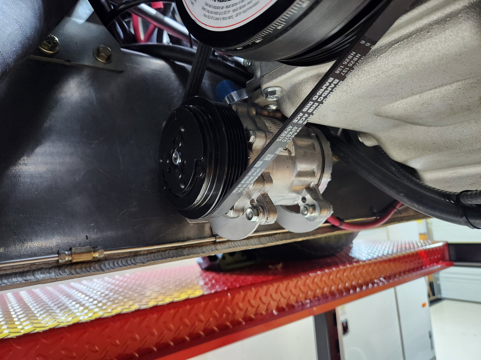

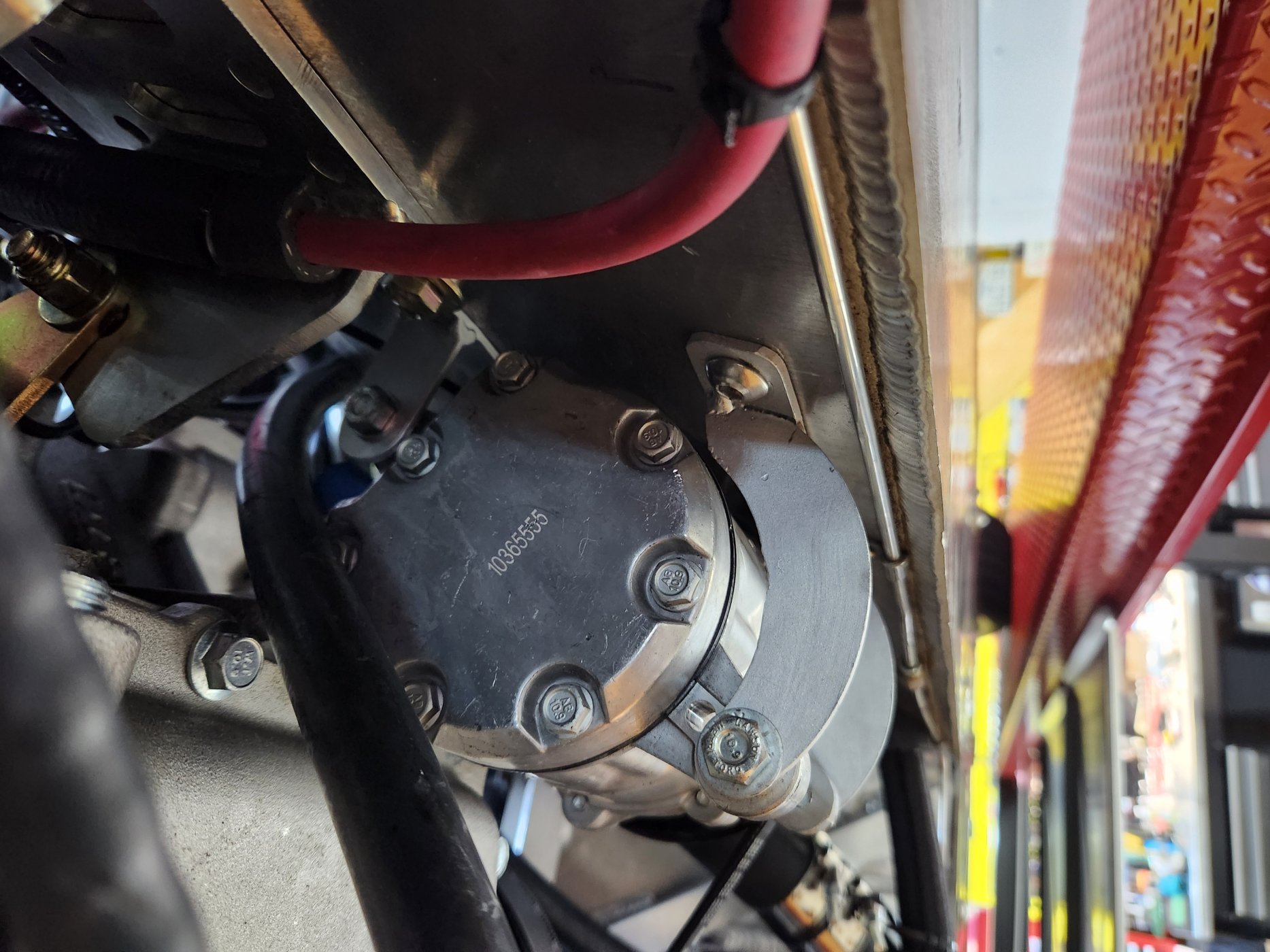

Got the brackets fabbed up and the A/C compressor final mounted with it's own dedicated belt. Next up is crimping on the hose ends, vacuum checking for leaks and then freon charging. Getting too hot in VA to drive without A/C!

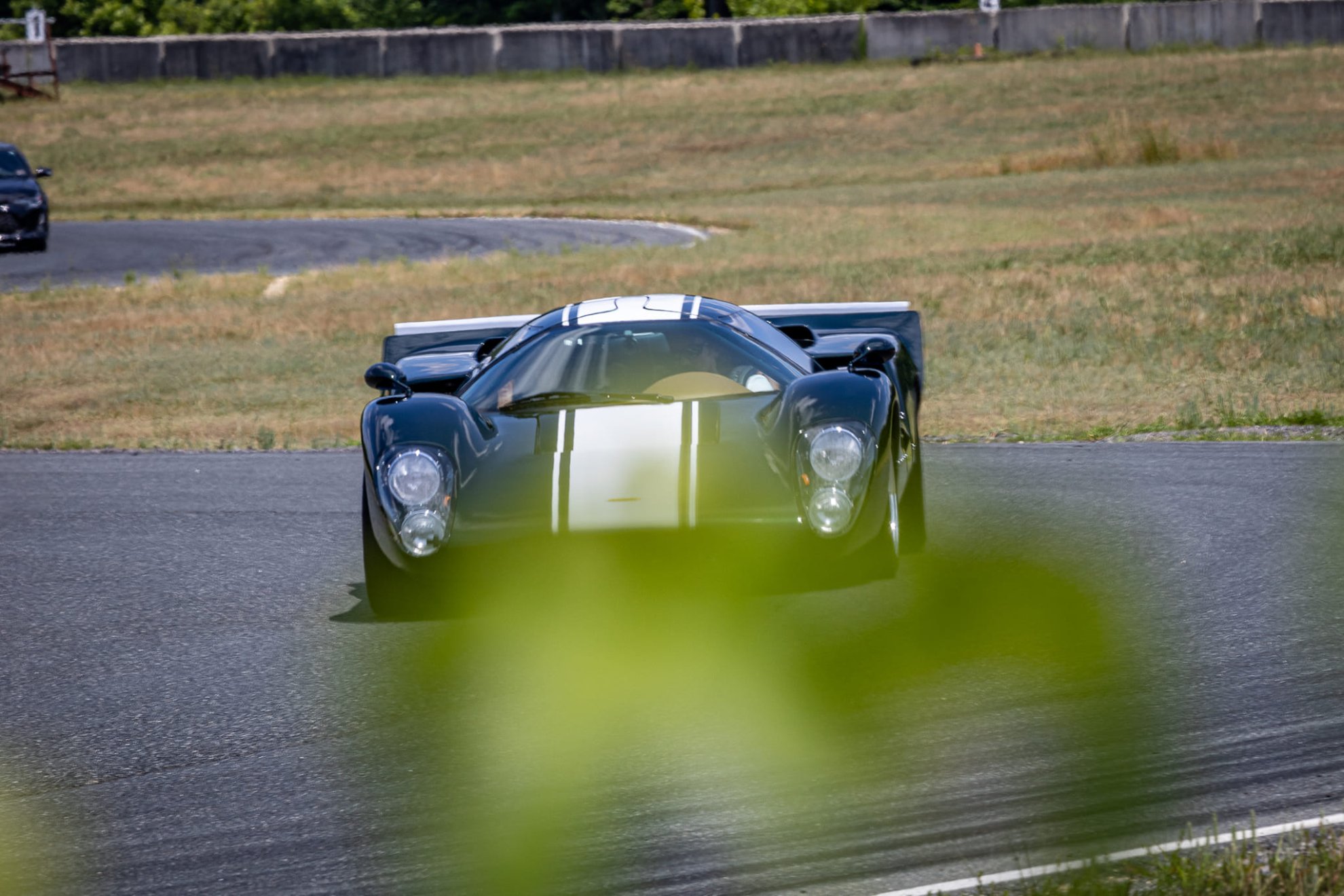

Took the Lola to Dominion Raceway Sunday for it's first track shakedown/test run. Air temperature was 90 degrees with high humidity and the water temperature stayed around 195 until we stopped on pit lane and idled between each 15 minute session. The car performed well with the clutch and shifter operating smoothly. This was my first opportunity to get some heat in the brakes. I ran street tires for the day and grip was excellent. Plan on putting the racing tires on when I do the next outing at VIR. All in all a good day as nothing broke and no leaks emerged:)

So awesome. Great to see the efforts really do pay off. I am newly motivated. Thx for sharing.

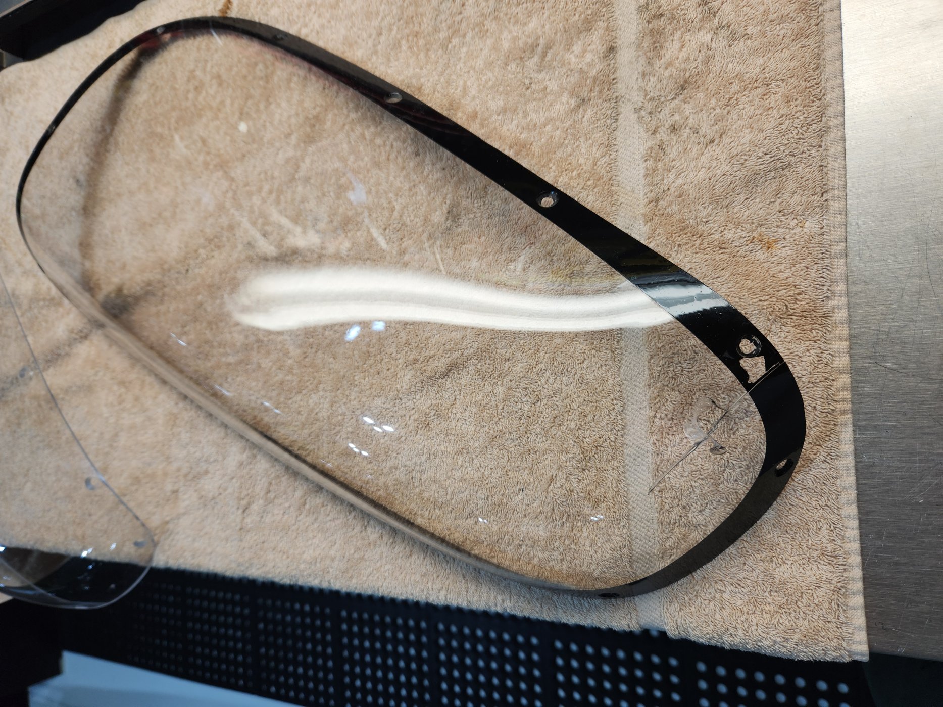

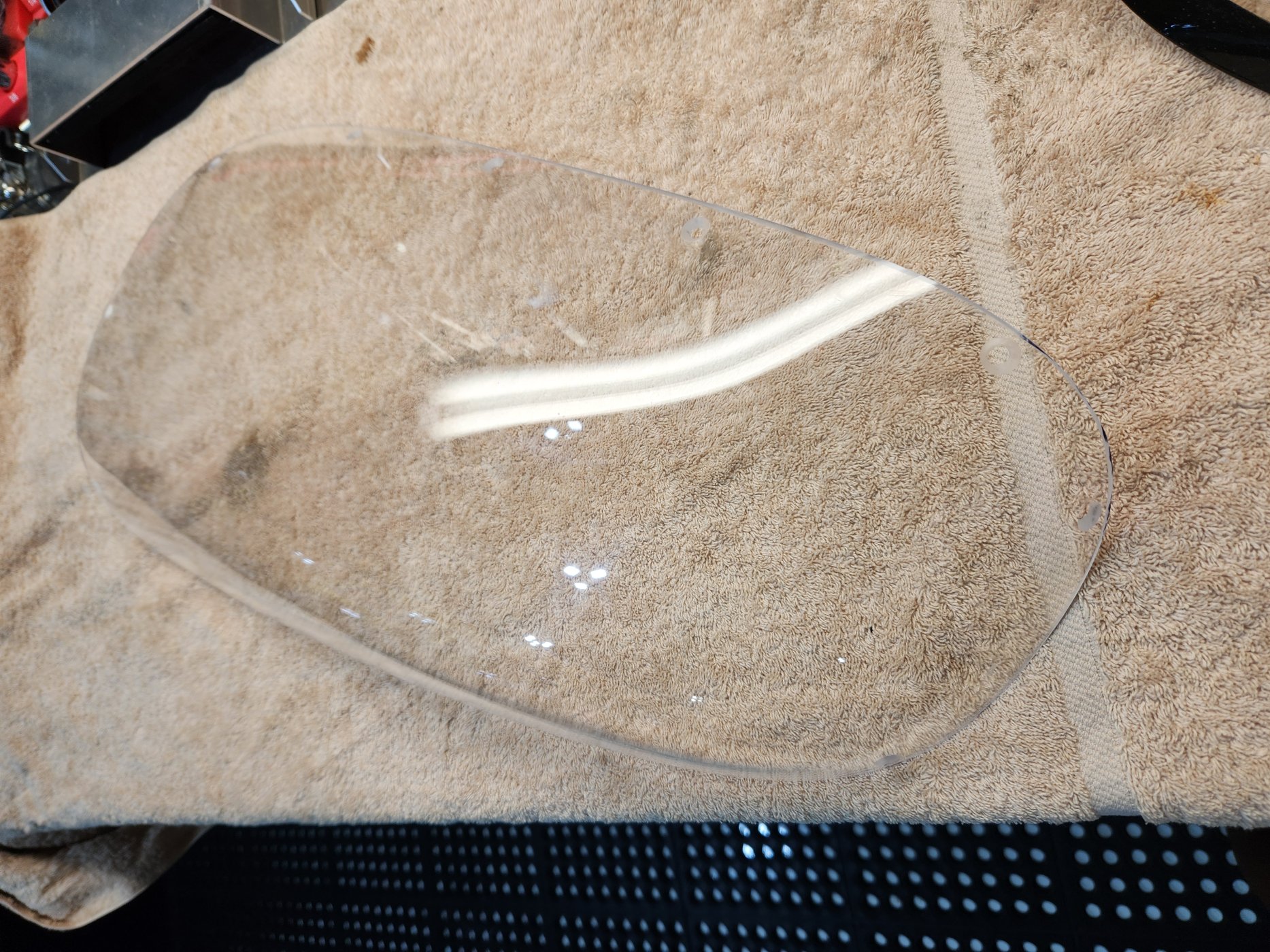

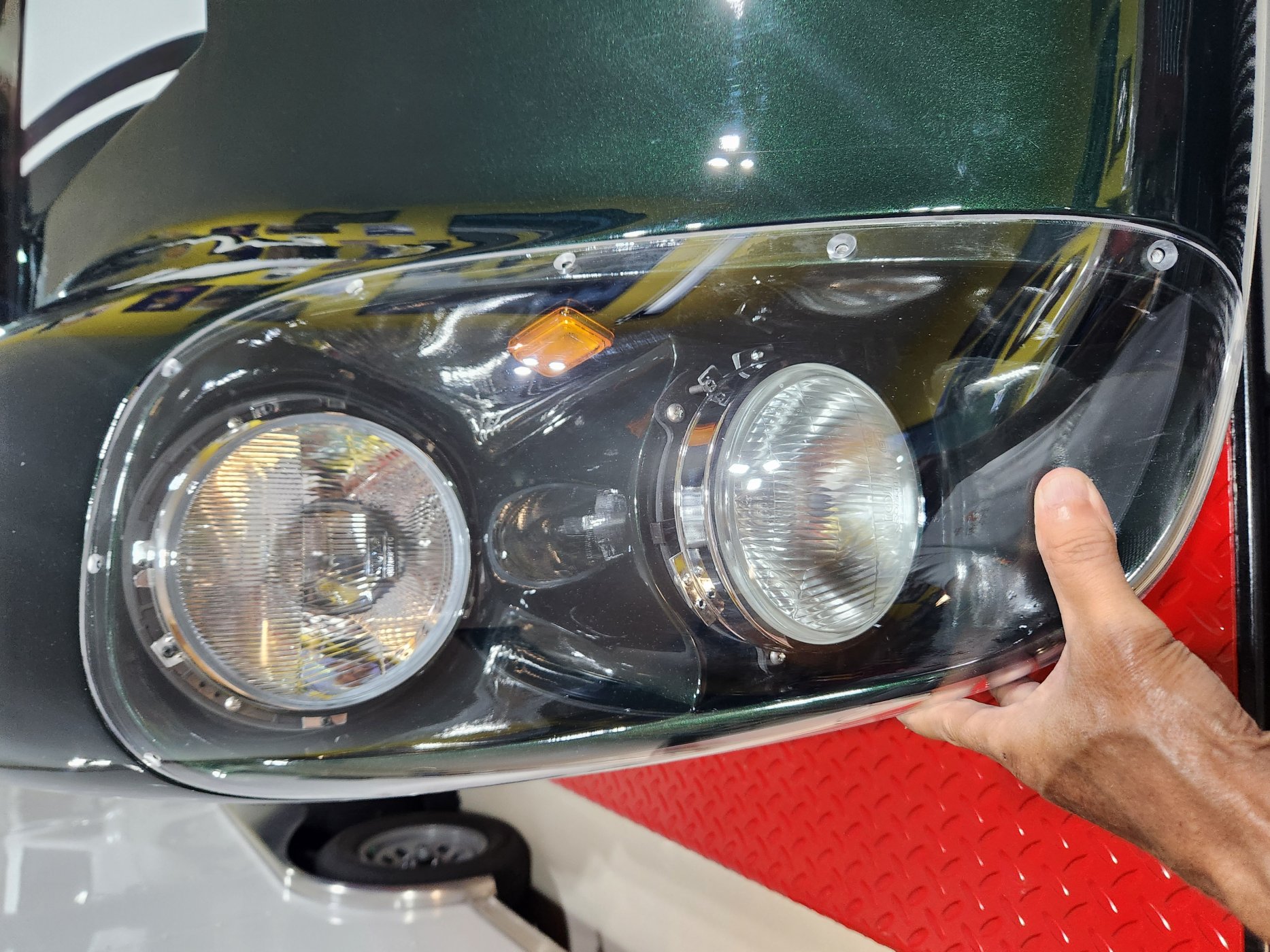

Caught a rock with my passenger side headlight cover a couple months ago and procured a replacement lens from Aircraft Windshield Company in Los Alamitos California. Finally got around to sanding it to fit and drilling the screw holes. Still need to paint the black border around the perimeter. Very happy with the quality, as this one is approx. 30% thicker then the one that came on the car.

Jim, how close are the ones you purchased to fitting the body ? Is there a lot of filing and sanding involved ??

Brian,
They give you the choice of sending them your original lens and they will match it, or sending you an oversize lens you trim to fit. I chose the oversize option, and used 80 grit and a palm held power sander to get the fit where I like it. I also used a hole chamfering bit so the tapered screw heads will fit flush. Not hard, but had about 5 hours labor in it.
