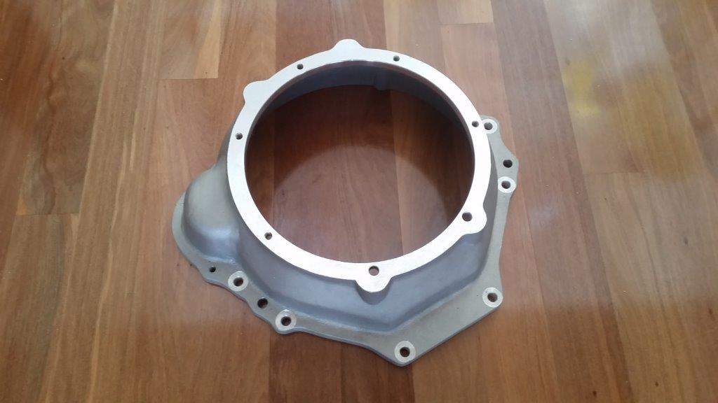

Hi Guys I need some help.
I have a Kennedy bell housing to suit a 157t flywheel (pic attached). I have a 327ci Windsor (aiming for around 350hp) going to an RBT.
Will a standard dimension 157t Ford flywheel (I require 28g balance) work? I understand the clutch will not be standard due to the RBT spline size however, I would like to go generic if I can, say a McLeod flywheel and clutch package via summit racing? I have the external clutch release kit from Lloyd so I do not need a hydraulic throw-out bearing.
Does anyone on this forum have this combination or similar? Can you please share your part numbers?
Also the bell housing did not come with a sandwich plate, I think it should (to assist with alignment and provide a cover for the lower portion below the engine block). Are sandwich plates mandatory?
What starter motor fits this housing? The bolt centre's are 132.5mm (5.2165 in) Again any info would be appreciated.
Thanks in advance. :thumbsup:
Kind regards, Gus.

Should be relatively easy to get a 28oz/157t flywheel in OZ, Try Yella Terra. You MUST use a sandwich plate if using any Ford type starter- they all use the large starter hole for correct alignment with ring gear position, the bolts on ford starters do NOT factor in alignment process. Position of ring gear as in distance from rear of block face varies with flywheels/flexplates etc- make sure the starter you choose is correct in that area.

Sam is your bellhousing like mine with no strengthening webs? I think Kennedy's has a couple of variations.
Cheers, Gus.

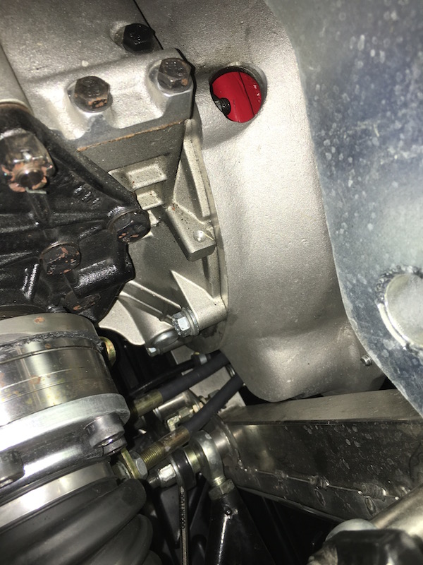

Gus, it looks like yours. I have added a photo. You can see one of the 1-1/2 inch access holes that were cut for the backwards top studs. This allows removal the trans separately from the bell. Also, I notice a clearance cut on the outside of the starter bulge. This is peculiar to my installation. There is a similar cut on the bottom to clear the lower crossmember.
