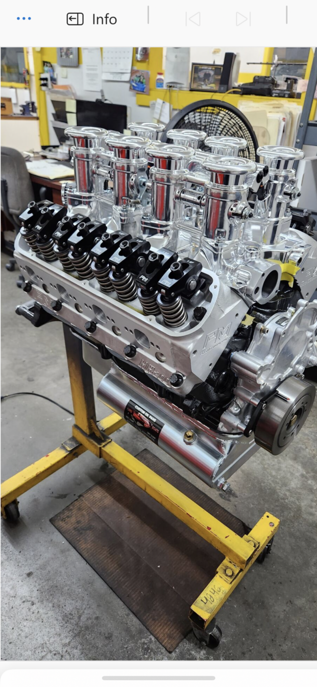

Put deposit down June 7th for Deluxe plus kit, Mk1 tail, Mk2 nose, Single nostril, 17" Halibrand wheels, wider rear wheels +1.5", 2 x Gurney bubbles (not sure on those yet), Front air lift, +4 flares, Body fit from RCR
Prestige motor sports Ford 427-HR/SS-LB2 520HP 4125 SPEED BORLA (HIGH POLISH)
QBE62G004 Quaife Ford GT40 (ZF) 5sp Synchro Transaxle with oil pump, GP headers, CVF Serpentine Front end, complete small block clutch package from Safir.
Transaxle is here, Engine will be done in a month.
Now just the wait.... Hoping to get car Jan or Feb. Fran said around 7 months so fingers crossed.

Steve R, do you "need" the shorter stacks to clear the rear deck/hood in your RCR? Or did you just want the shorter stacks? Looks AWESOME! Sounds good too!
Ben
To be honest I just went with what Prestige recommended. My knowledge is limited so this whole build is going off other builds and what people with knowledge recommend.
