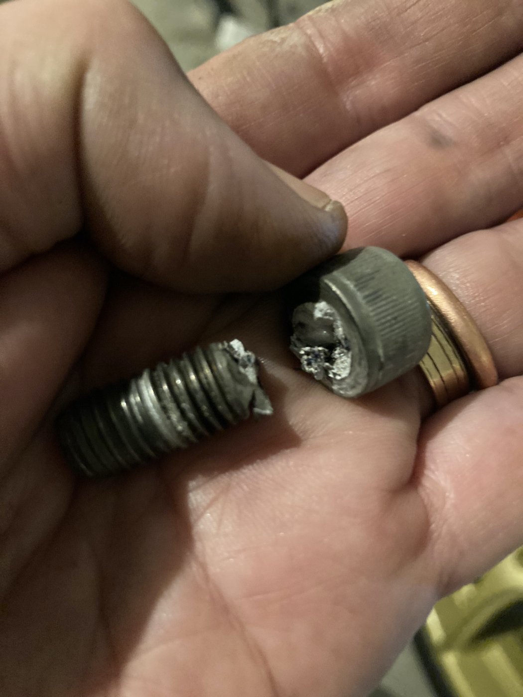

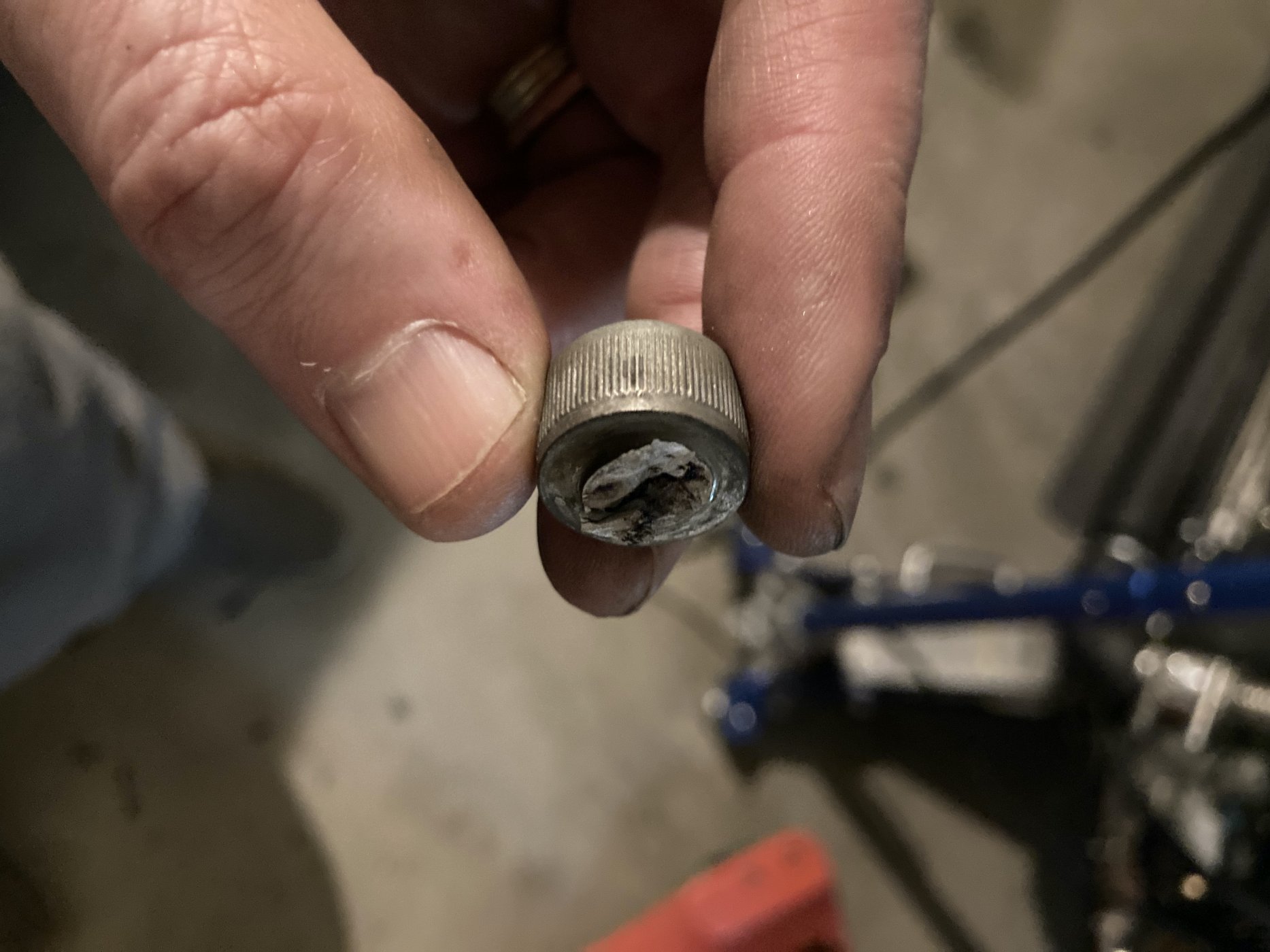

So I ordered the donut gaskets , there was actually a small gap since the flanges did not fit perfectly , they fit a lot better on the other side and the situation aggravated by a failed flange bolt on the driver side , that is probably why the passenger side cat did not get as hot .
