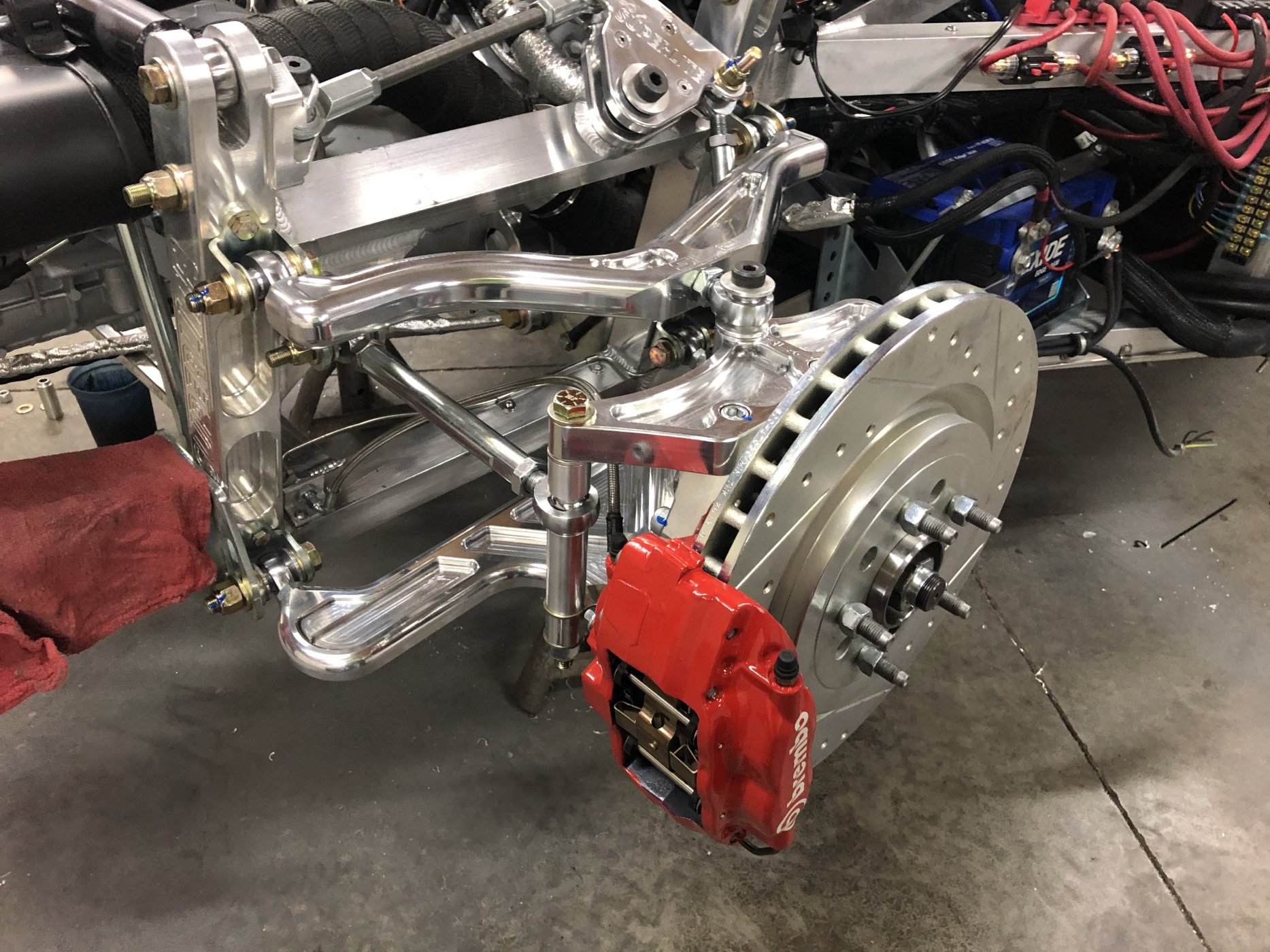

Sharkhyde is widely used on aluminum boats (such as aluminum pontoons) and over the road long haul trucks (wheels, fuel tanks, etc.). It is a three step process of a cleaner for dirty aluminum (I am not using the cleaner since all my aluminum is clean and new), a polish (it is very similar to a 3M or Mothers aluminum polish), and then a protectant (the protectant is a liquid that you wipe on in one wipe and it drys on the surface). It is supposed to last three to five years on boats and up to eight years on cars. To re-treat you simply wipe on a new coat over the old.
My process is as follows:
I first polish each piece in two stages on my bench mount buffing wheel using white and then red rogue on the cotton wheels. My buffer is older than me. My late grandfather used it to polish the brass on his harnesses from his pulling ponies and show horses long before I was born. After polishing I use the Sharkhyde polish on a blue foam pad on my two speed rotary buffer. I then remove all the polishing residue with acetone (as per the instructions) and apply the Sharkhyde protectant.
Here are a couple of relatively close up pictures of the results.
You can see my somewhat blurry reflection in this piece. There are a few machining marks showing in this part (and others). I had considered sanding them out but decided to not spend that kind of time on this portion of the project.

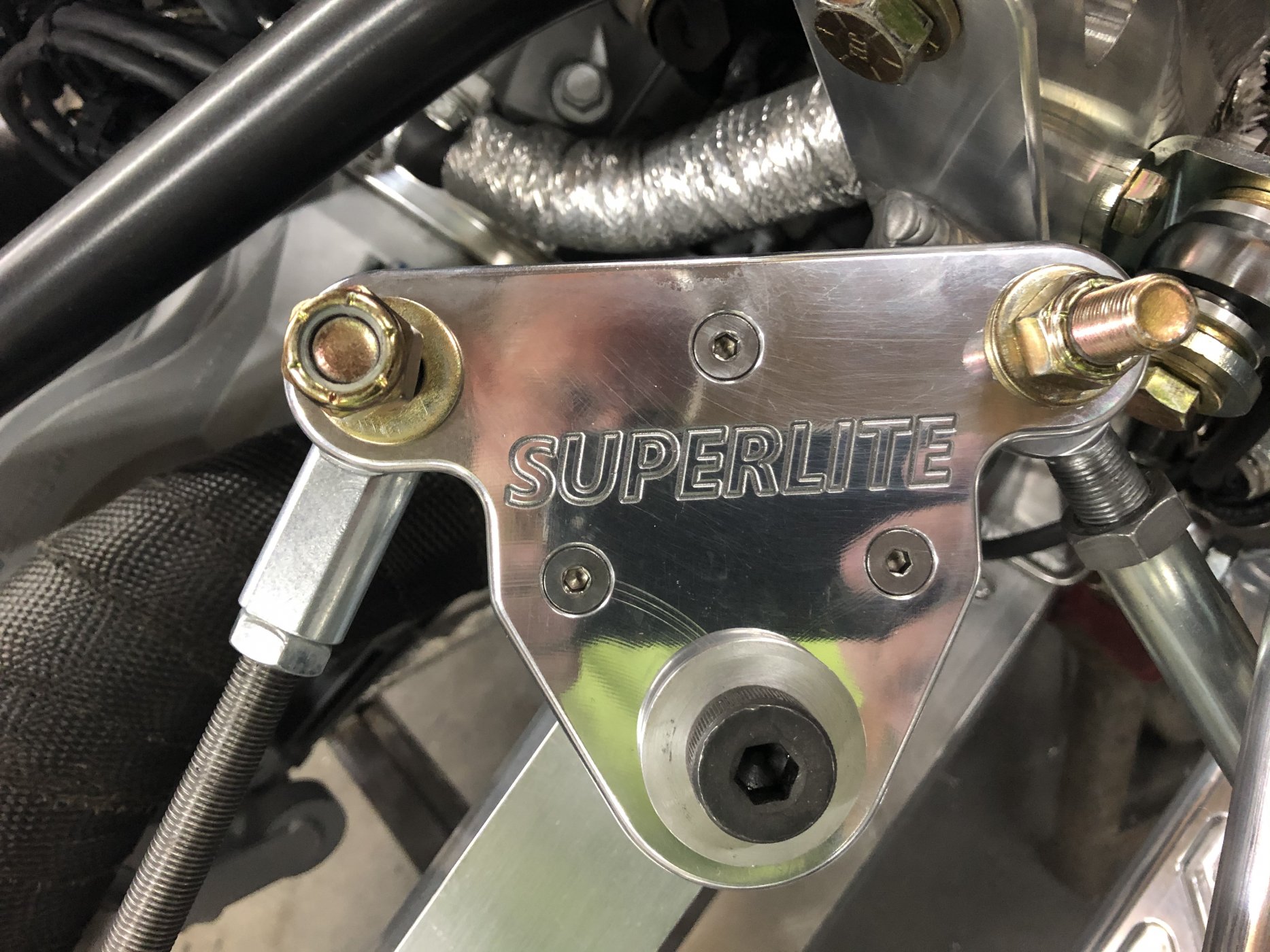

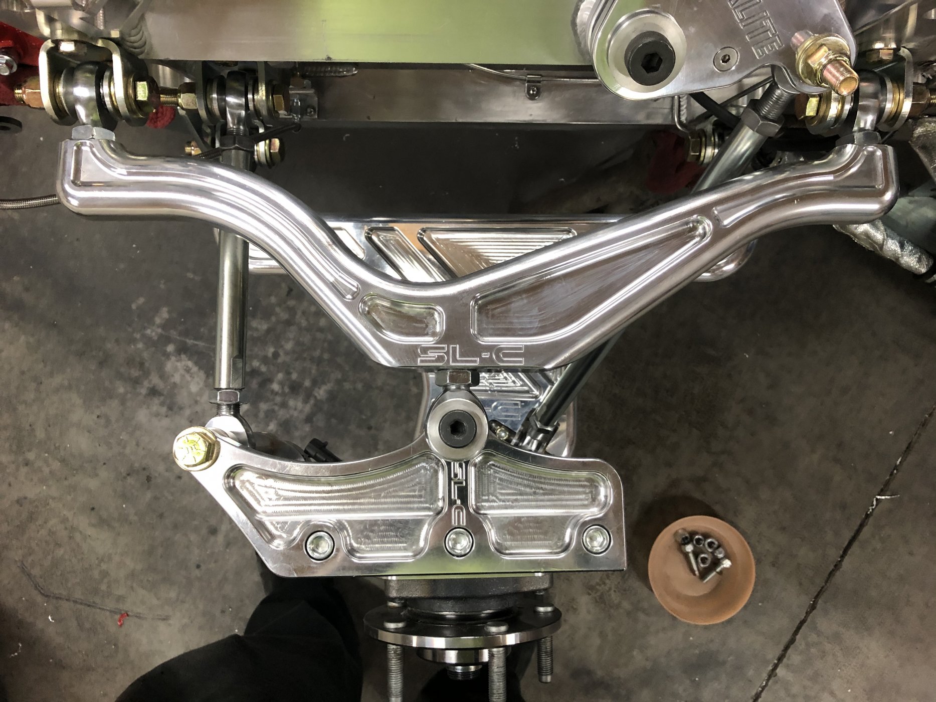

Obviously, I cannot buff my chassis on my bench mounted buffing wheel so it only received the Sharkhyde polish and protectant treatment steps.

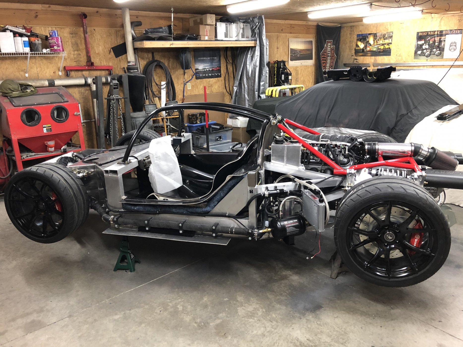

Well it is not a first go-kart session but my SL-C moved under her own power today (all be it only a few feet back and forth in my shop).
I finished up polishing the other day, mounted my seats, and did some temporary wiring of the ECU, fuel, and start switches. Today I went to adjust the clutch and even at full pedal travel it would not disengage. I thought the worst and that is that the clutch arm had fallen off and I would have to pull the transaxle. I pulled the slave cylinder and the arm was in place, phew! I cycled the pedal and the slave did not move. I bled it again using my power bleeder with it up in the air to put the bleeder at the highest point and I got some more air out of it. Tested it outside the transaxle and it worked, too well..... I blew the piston right out of the master cylinder because I pressed the pedal too far. It is only held in by a simple one way press in castled washer. Re-assembled the master cylinder, cleaned up my mess, bled it again, adjusted and all is well.
The snow from earlier this week is gone but the reason for that is that it has been raining the past two days. I am hoping to get the SL-C on the road in my neighborhood Friday afternoon if the weather turns out as they are forecasting.
I let it idle earlier today to get her up to temp and everything balanced out at 200 degrees with only one fan running. Radiator was hot to the touch on the hot side and only slightly warm on the return side. I would say my fan shroud and the stock RCR supplied fans are working well, at least at idle. We will see once it is warmer outside and the AC is running with the car at speed.
I thought my exhaust was too quiet, my daughter could here it in the house as I was playing out in my shop (which is about 100 yards behind the house). My camera was setting on my workbench for the video below and even at idle the motor was shaking the camera. She is running rich and I need to drive it to give the Holley time to self learn the needed adjustments to the fuel table. It has already pulled as much as 47% from the fuel table at idle. I may start with a whole new fuel table that I put together custom instead of the one from the wizard. It is also coming down from idle a little slow and undershoots the idle then recovers. Definitely have some tuning to do and I may call in a professional. I'll give it a crack first but I am by no means an EFI expert.
