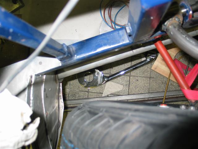

I'm working on my front suspension and like to know if someone with a kva type c front
can put some dimensions of the tracking and the clearence between the wheel and the chassis (at the rear the closest point) and if someone know's what the turning circle is
Hello Frank outside measure on the tires is 1,70 m inside is 1,25 m .With 215/55-R15 tires I have about 10 cm between the tire and chassis.So the turning circle is wide ,I don't know how much but it doesn't give me problems with normal driving.If it was me I would make some modificatications on the frame to have more space between tire and chassis and a smaller turning circle.greetings Emiel
