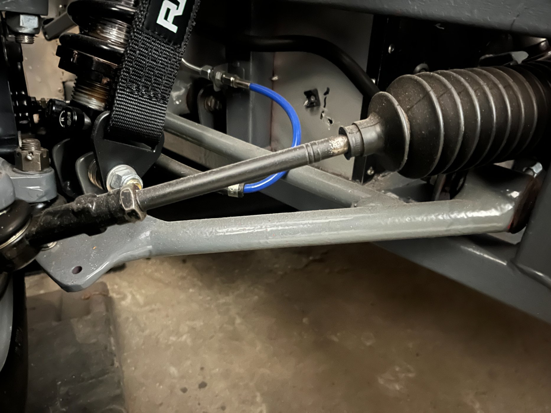

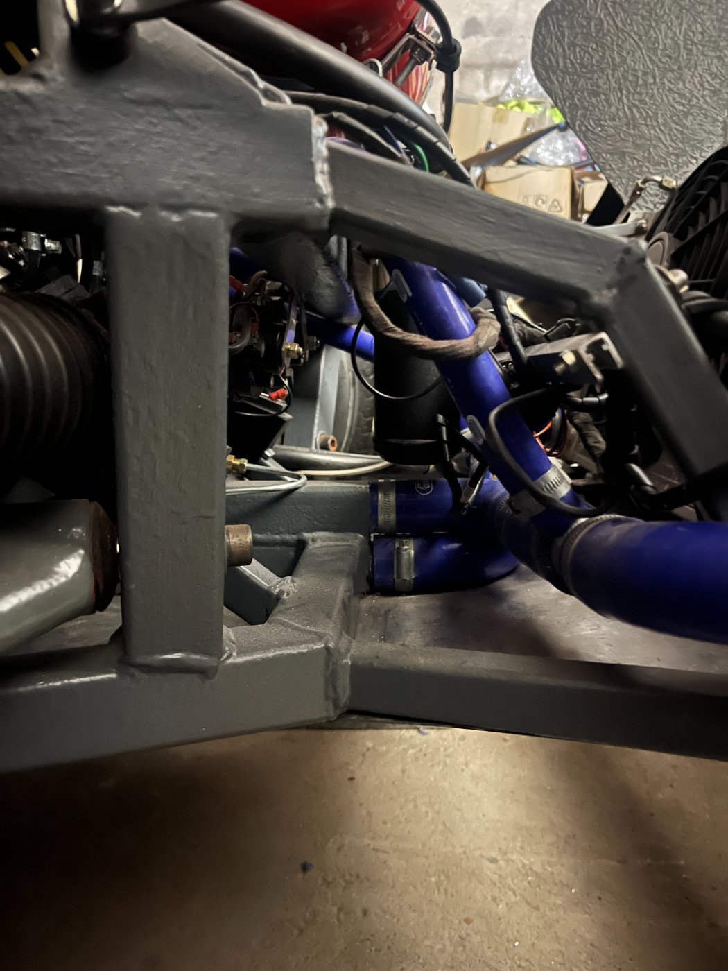

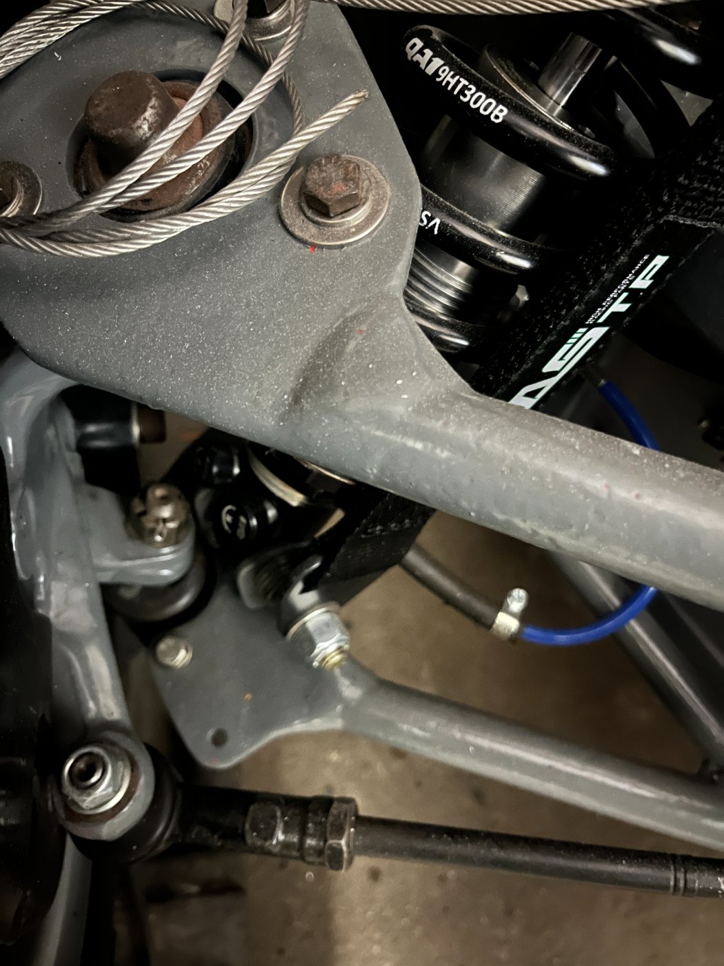

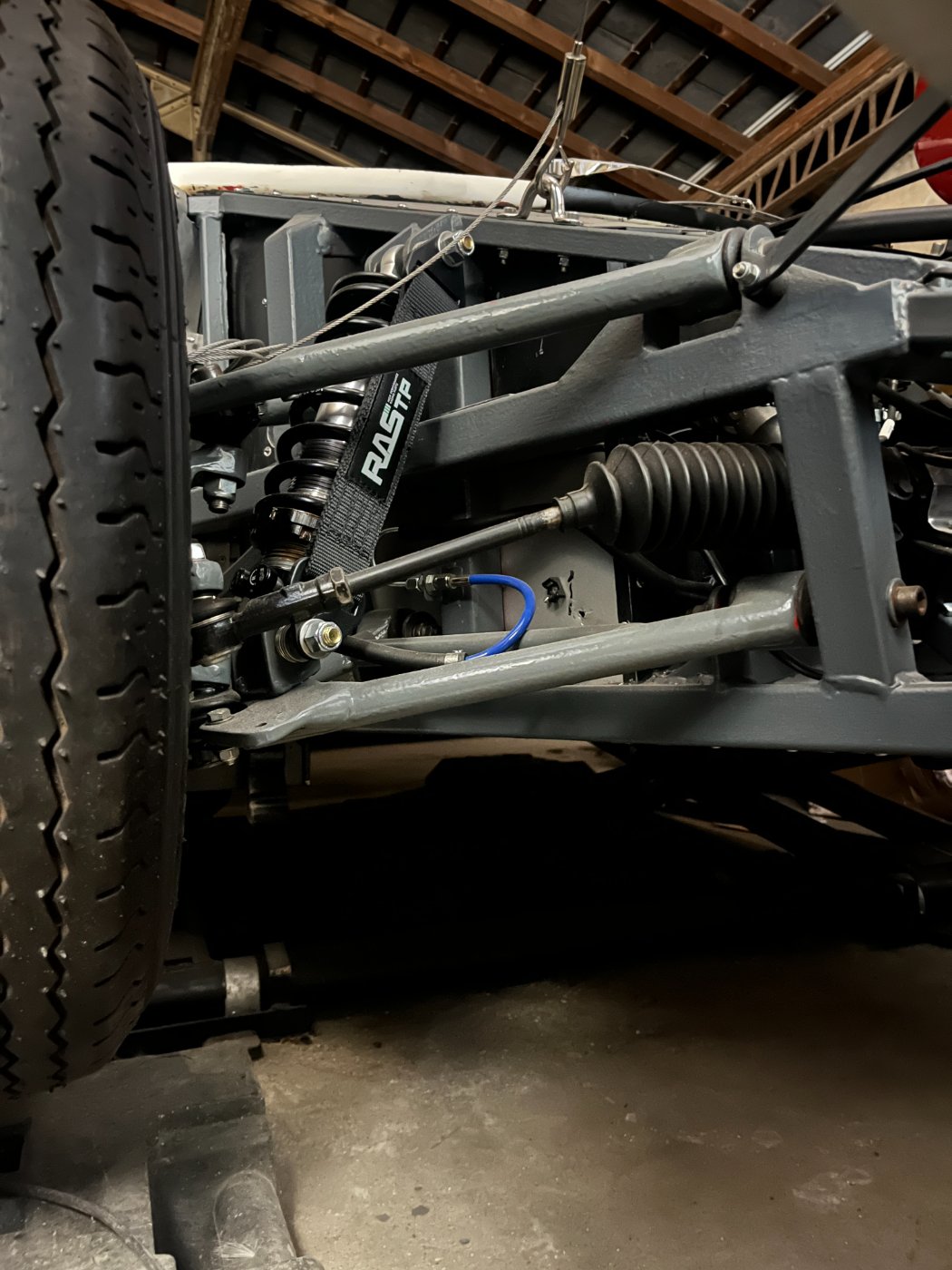

I've reached a point in reassembly where I'm wondering about the importance and necessity of fitting stabilizer bars on the kva mk1, (Thanks for all the exciting threads on the subject already read on the site!)... because there weren't any on the vehicle when I bought it...
Does anyone have any photos of a fitting specifically on the front axle? (kva mk1 chassis type C granada fitting) I'm wondering if it's better to position the front bar under the car or rather between the suspension arms against the chassis...

My KVA "B" chassis has non.
The "genuine" ones racing in historic races like Spa 6hrs, during races in the wet, they all disconect the rear swaybar so it doesn't work during the wet racing conditions.
With my suspension setup I don't feel I need to convert to swaybars. But thats my 50cnts.

Hi Jp,
It's reassuring to know that it can be driven without it! Thank you for confirming what I had read elsewhere, knowing that I think it is more useful to have one at the front rather than at the rear, :rolleyes:but since I have almost finished fitting the rear one, I think that the one at the front is essential... or else... I disconnect just like you!

From the pics it looks like you have a C type chassis. This differs from the GTD in that the front of the chassis tapers towards the front whereas the GTD has parallel sides. This means that the front wishbones have unequal sides. This can limit the available lock as the rear of the wheel gets close to the back of the front wheel arch. Some cars have to put limit stops on the rack to stop rubbing. Depends on wheel/tyre choice. They both use the Ford Granada Mk2 uprights. The KVA C type chassis uses fabricated steel uprights at the rear with a large diameter middle section which carries the Ford Granada MK3 hubs. The rear suspension has the usual GT40 arrangement of long trailing arms, reversed lower wishbone and a top link.

Hi Mike, exactly! :D
t's my setup which remains a visual delight, and a nice adjustment headache for long winter evenings while waiting for spring...
I don't yet have permission to put it in the middle of the living room near the fireplace but I'm working on it...;)

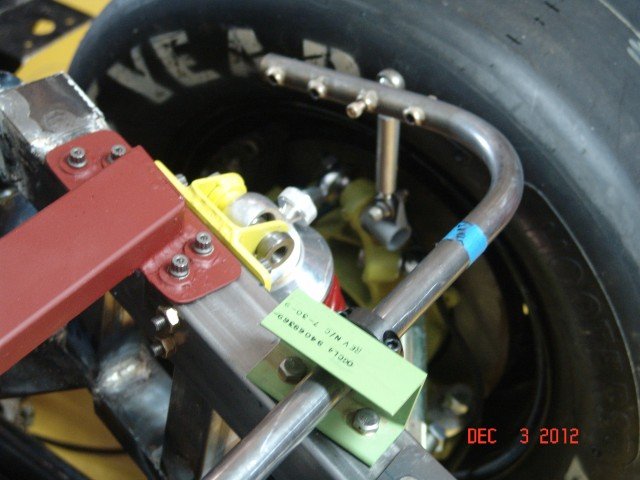

My bars were 3/4" 0.065" 4130N tubing. I placed a pattern of holes so thay by choosing different attachment points for the down links, the bar stiffness could be changed. Your application may require softer or stiffer anti-roll bars. Note: the stiffness of a tubing bar is determined mainly by its diameter, a small change can make a big difference.

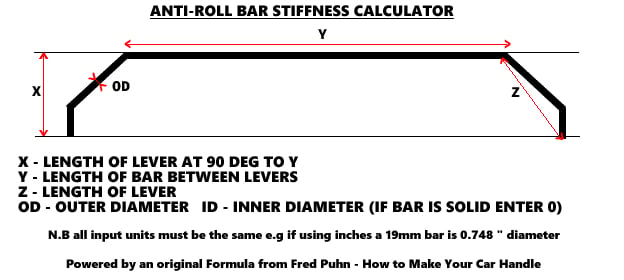

If anyone is interested in knowing the evolution of stiffness depending on the size of the bars and the position of the anchors of the vertical end links, here is an automatic calculator which can give you some ideas of evolution of figures, or even to know if your front bar, different from your rear bar, is more rigid or not, than the other...
  • Just enter your anti roll bar dimensions
  • Dimension 'X'
  • Dimension 'Y'
  • Dimension 'Z'
  • Dimension 'OD'
  • Dimension 'ID'
  • --> balancemotorsport gives your Torsional Stiffness (Lbs/In)

That calculator would have saved me quite a bit of calculation had it been available when I built my car. :p
My suggestion is not to do it the way Neil did the four attachment bolts for the rear bar, the generally accepted method is to weld a bar under where the 4 bolts are and drill the added piece with 4 holes putting your connection there., must better load distribution. By drilling the bar you are building in weak spots, increasing the chances of rear bar failure by breakage or bending. Generally speaking, the rear bar is always smaller in diameter than the front bar. I personally, would be looking at a front bar with a diameter of 25-30 mm and a rear bar in the 18 mm range. I must confess, I have no experience with your suspension systems but base my comments on original GT-40 requirements.

If you look closely, the four holes for downlink attachment are not simply drilled through the tubing. Instead, there are short bushings welded into the tubing holes, adding strength to the bolted connection.
Laurent
Yes, Neil, the calculator: it's all good, but now you can check the tension changes on the four holes in your bar, just for fun ! I zoomed in on your photo to actually see the reinforcement rings; it was both a good idea and necessary...
Indeed, Billk, welding a holed central bar is a good solution. Personally, I'll even weld two to position the sway bar end links vertically between the two, and avoid lateral twisting, especially with eyeball tie rod ends...
