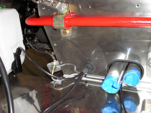

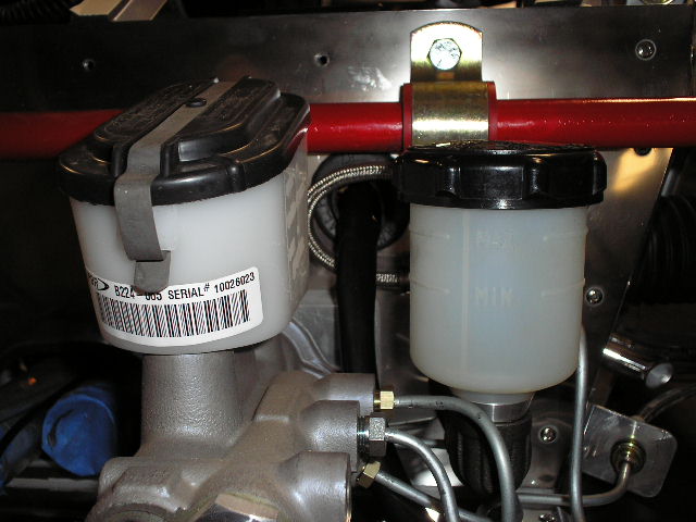

I'm interested in photos (ideas) of wiring exit (hole) location in the front bulkhead servicing the fans,front clip, etc.. The harness is a halfbreed and the brake system is in the location of the hole detailed in the build manual. I bet there are some creative ideas about locating it without remanufacturing the harness.
Hi Jim, I am using my lap top right now, my other PC crashed . I will take pics of my bulkhead tomorrow and post them. I made two holes in the panel, one around the masters and the other on the far R/H side (looking fwd) . I have the flu and am trying to get back on my feet , besides my other pc too. Have a great Thanksgiving . Dan PS received the dynamat sample , thanks . I think I will follow with the same stuff.
Found the old pics on my backup drive.
