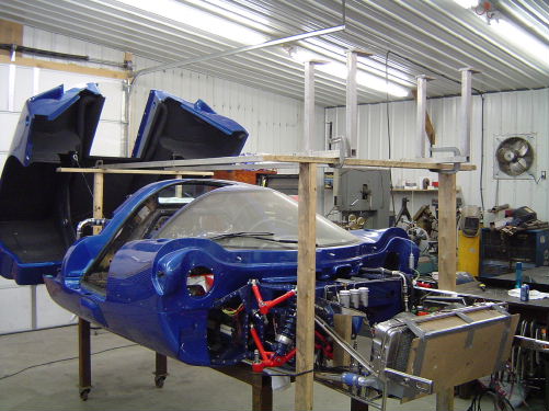

Crude but effective checking jig, note plumb bob, for making sure chassis/body is 100% square.

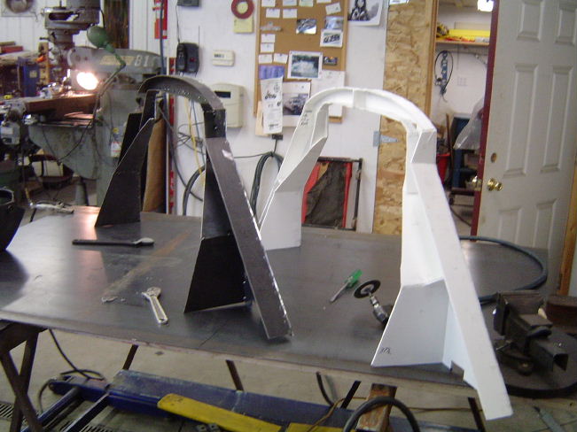

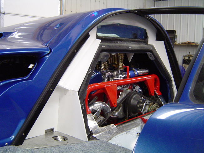

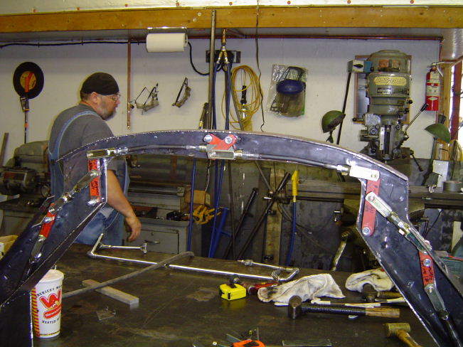

The original roll bar was muffler pipe. We're replacing it with a boxed structure that will also house the door mech.
Note seatbelt bar.

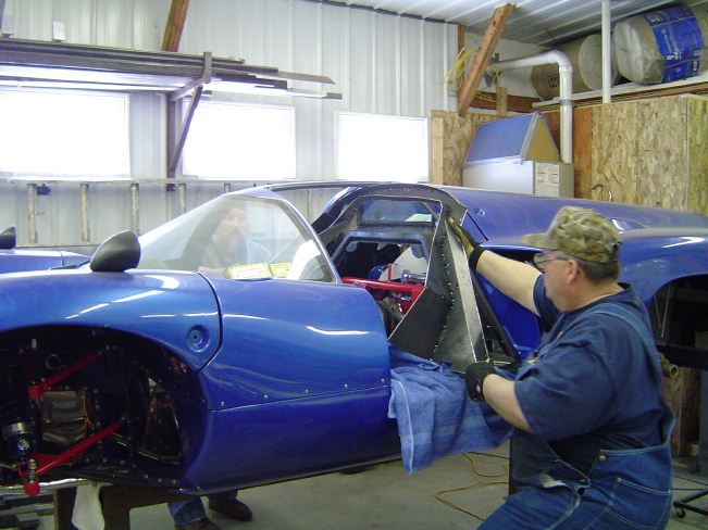

The original sway bar bushing holder gave up so we're repalcing them with more robust ones that can be serviced.
Also note linkage that raises gull wing doors.
