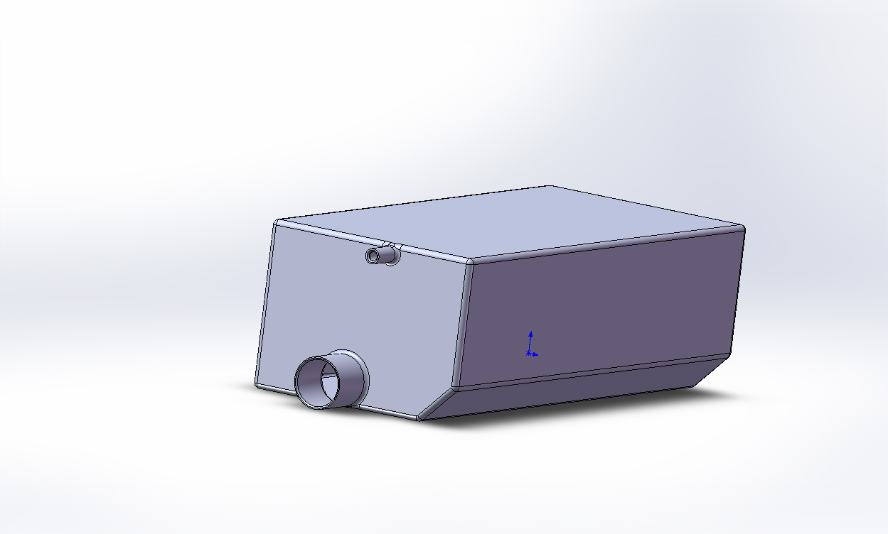

Have them made in Rubber as they where in the past ; just need a drawing and send it to the people in I know from more than 30 years doing this job .
2 Months ago they have built an 57l side rubber tank for my 908 project and they manufacturedit in 2 weeks for 700 euros plus tax ( The tank is perfect fit and fully homologated plus the fact it's safe because full of spécial foam and am sure it will not leak at all !!!)
Same manufacturing on others well know rubber tank company need 2 or more months of fabrication and cost twice !!!

I did acad drawing but they are able to start manufacturing with hand sketches and can add any bottom or upper inlet or outlet rubber tube as per your specification ( eventually if you give them an upper alu door fitting they bond it under top skin )
It's a family small factory but so effective ( I know them and work with since 40 years !!)
This is an idea of my first drawing

a critical problem is gasing do the rubber tanks allow gas to seep thru the membrane and cast a smell. I have ERA plastic tanks and the do smell of gas. since they are not isolated the smell creeps into the cockpit. i have thought of changing to aluminum to git rid of the smell
